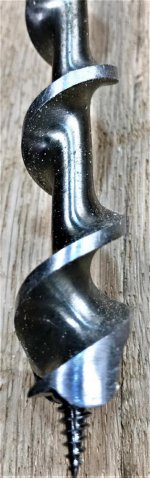

AUGER FILE​
I recently got an auger file and yesterday I played with it for an hour or so. It's surprisingly easy to sharpen auger bits. While it could be done with a regular file, the auger file has some features that make the job faster and safer. First, it is tapered so it can be used on different sized bits. Second, If you look closely you'll see that one tapered end has teeth and the other is smooth. It has safe faces but there are teeth on the edges. The end with teeth has safe edges. Having safe edges and faces is helpful because a bit could be nearly ruined if the wrong part of it is filed.
Most, but not all, of the filing is done on the upper part of the cutting edge. Some filing is done on the inside of the spur. NEVER file the outside of the spur. The diameter of the bit will be made smaller and no matter how sharp the cutting edges are, the bit will struggle to do its job.
The most surprising thing I learned about auger bits is how important the tapered lead screw is. It is supposed to pull the bit into the wood so that he cutting edges will shave off some wood and the flute (or flutes) will remove the shavings. None of that will happen if the lead screw is not sharp, is bunged up, or missing. The screw will wallow out the hole it's in and you'll have to rely on brute force to push the bit through the wood. Good luck with that! (Coincidentally, Brute Force & Ignorance is a favored technique)
Auger bits can be had for little more than pennies at garage sales etc. As long as the lead screw is in good shape, the bit will be useable with a little TLC. They are surprisingly fast and effective especially when boring deep holes.
That is NOT the same bit in both pictures. I included the second one to show a lead screw that's in good shape.
