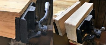

I got a Sheldon vise at an estate sale last fall. While trying to find information about it, I ran across an article by Chris Schwarz. He had mounted one as a tail vise on one of his Roubo benches. He liked it so much that I decided to mount mine to my laminated construction grade 2x4 bench top.
The first task was to chisel out a recess on the underside and one on the end grain of the top for the static part of the vise. Even though I was lucky enough to have a very sharp Sorby framing chisel, I had to go all Mjolnir on its **** to make headway through the end grain of the stringy fir. Actually, the hardest part was that I had to do it while upside down.
After I got the Sheldon mounted, all that was left was to fab some jaw faces (see post #4637) and bore some dog holes. The advantage to using a Sheldon is that it is Quick Adjust. All you have to do is lift the handle to 12 o'clock, slide the dynamic jaw to fit the workpiece, then turn the handle down to 3 o'clock.
I put it to use this morning smoothing the faces of freshly resawn walnut. It worked great.
Just to emphasize one of the subtle benefits of using only hand tools, I added a picture of my dust collection system.
This project was, I hope, the final preparation for an all hand tool project for which I have been gearing up for far too long. I now have the tools, techniques, space, and enough practice to begin. Stay tuned - but don't hold your breath.

CRS--Too much eye candy. Love the Thor hammer and the vise and the plane. As for your dust collection system, I have the same one. :beer:
Looks like you are ready to make some serious shavings.
