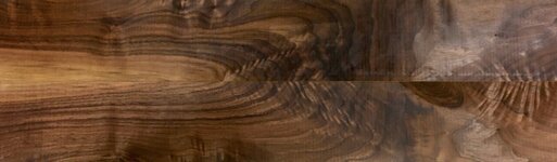

Hello all, here's a new creation! I teamed up with a friend at his home shop to make this cutting board, which I gifted to my brother and his wife as a wedding present. It's made from walnut, cherry and maple, and the size is roughly 13"x19" and 1-3/8" thick. We did two inlays with five thin strips each, one after the other (which turned this into a serious project!) and then routed a finger groove on each side. I cut the corners a little different and asymmetrical to minimize a tiny crack on the end of one piece of walnut, then rounded over all the edges. Then sanded to 220 grit, raising the grain out of an abundance of caution if it ever gets too 'dry' before reapplying oil, and finally soaked it repeatedly in Howard butcher block oil (I know, it's basically mineral oil but I'd already bought it) then Howard conditioner.
Might not be perfect but good enough, the newlywed couple were happy, and just a great memory and learning experience with a friend which I really appreciate!

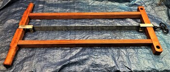

ROUBO STYLE FRAME SAW
I made a working prototype of this saw from construction grade wood a few years ago which I think I posted here.
I always intended to make one out of better wood and finally did. This one is made from cherry; very brittle cherry as it turned out.
It was all done with hand tools. In addition to standard saws, planes, and chisels, I used a beading tool, a scraper plane, rasps, and files.
The tensioning key/wingnut came from a garage sale. I have no idea what it was originally used for. I japanned it just to dress it up.
The finish is Tried & True Varnish Oil.

CRS, that saw came out amazing. I gotta be honest, you've definitely taken my interest in this hobby to a new level.

I haven't done any woodwork since high school, but recently did a spiral staircase step stool which gave me the bug. A friend has a garage shop that was used to make it and I wanted to thank him, so I'm making a small walnut box that will have some things he needs in it (i.e. dowel pin markers).
The walnut treads on the step stool was the first time I've worked with walnut, but I haven't put a finish on those yet. Anyway, I've been stopping by the store periodically looking at walnut boards for the box. Not having any idea what to look for, and there are a lot of variations in grain, I just kept hesitating.
Hard to tell much when they are dry, so in the store I got my hand wet from the rain water on the cart and wiped it on the boards that interested me. Yesterday I found this board and I thought it was so visually striking that I bought it. It's 3/4 x 3 1/2 x 5.
When I got home I wiped it with mineral spirits. The pic is about 2 feet of one end of the board; the top of the pic is one side of the board and the bottom of the pic is the flip side. I cropped both pics and spliced them together to make it easier to look at and decide which would be the outside of the box.
I'm curious about the grain and figuring. I can see the sapwood and that doesn't bother me. Does anyone have an opinion on whether this is a good piece for a box?

carl: From what I can see in the picture, it looks like a lovely piece of wood. It also looks like wild grain which can be difficult to deal with depending on what you're trying to do. There are many many videos on YouTube about box making. Watch a few to see what joinery techniques they use and how they deal with grain issues. Try some of it out on regular one-by wood before you begin your walnut project. You'll probably end up with some pine boxes for yourself - and some interesting scraps. Joinery Tip: Box Joints are called that for a reason. They can be easily done with a table saw but you'll have to make a jig first which is also easily done.
