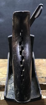

Tote repair
It is common to find handplanes in the wild with damaged totes. The direction of the grain leads to breaks under stress. But we are woodworkers and should be able to repair something as simple as a tote. Here is a Stanley Bedrock that I found.
One bounce on the floor will usually result in a cracked casting (fatal) or a cracked tote horn (bad, but repairable).
The first step is to remove the tote and examine the break.
It sheared off unevenly along the grain lines. It has quite a bit missing and that part of the horn is important. The curve in the horn catches the web between your thumb and index finger and prevents you hand from riding up the tote. Sheared tote horns might seem minor but they seriously affect control and use of the plane.
Mr bandsaw helped by making the break into a clean cut.
Here is the tote alongside some donor wood and covered by a pattern tote. Rosewood is hard to find and I am allergic to it anyway. Walnut makes a nice substitute.
And here is the glue up.
I use Titebond III for gluing totes and have been happy with my results. Others prefer epoxy. There are a few tricks I use for a good bond. First, I make sure the parts fit well. Sometimes broken totes have been used for years and the pieces do not fit well together. These generally make a poor bond unless they are carved or cut to fit. Flat surfaces work better. In addition, I let the glue soak into the rosewood before clamping. Titebond has a solvent (water?). Rosewood is dense. If you clamp before the glue has soaked in, you will starve the joint. I let it sit for five to ten minutes. Sometimes I even add more glue to the surface. Anyway, the true test to the glue joint is working it. If it stays in place while you work the piece down to size, then the glue joint will hold during use.
After drying overnight in the woodscrew clamp, here is what we have.
That's a pretty big stick for sure. But a larger piece is easier to clamp and more importantly, a large piece means less waste of the donor material. Mr bandsaw helps liberate the tote.
So here is where we leave our tote repair. I will continue shaping this afternoon but first, I need to take a nap. Stay tuned.

jim: I bought this No.3 for $5 as a What-the-Heck addition to some items I bought from a retired machinist. I have never seen a tote like this one. I believe it's rosewood. The knob certainly is. This tote is currently in a clamp under very slight pressure. My plan is to leave it in the clamp and every few weeks increase the pressure a little more. I'm in no hurry since I have a few more No.3s that I can play with. Do you, or does anyone else, have other suggestions? Steam? Soaking? Microwave?
If I had to guess (and I do), I'd say that this was some attempt at economizing on dwindling stocks of rosewood. I'll have to look at it under magnification to see if the grain of the wood runs across the box joint separation.
Thanks!

CRS--I have seen hundreds of Stanley, Ohio, Sargent, and other vintage bench planes in the wild
BUT
I have never seen anything like that tote. My guess is that it is a user made tote that was made in two pieces and later split apart. I would look for a tote donor. Otherwise, I would clean the inside, slather it with glue and then clamp the cr@p out of it. You can drill out the rod hole afterward.
Good luck with your repair. I really like #3 sized planes--especially as I get older. They are easy to push.

Tote repair continued
Well I got lunch but no nap. The workshop was calling and the basketball tourney is on at 4. I had to go back to work. I made one more small cut on the underside with the bandsaw. Here is what we were left with.
This is a job for the oscillating spindle sander. #80 grit.
Looking good.
Done. I like to have a pattern tote nearby to compare it to while I am sanding. This little horn repair came out pretty well.
Now we need to drill the tote rod hole. It is nice to have part of the old hole there as a reference.
Do you have a chip carving knife? If not, you need one. I drilled the hole slightly undersized so I could finish it by hand. The chip carving knife is perfect for this job.
And here is the test fit. Note the splotches of green paint.
From the top.
Most of these vintage totes are found with their original shellac finish. I stripped this one down with sandpaper. It removed the finish along with the green paint drops and dirt. Now the new finish will look better. After sanding, I wiped it down with turpentine. It is pictured along with another tote that got a repaired foot.
Here are the three of them together. Far right is the good pattern tote. Center is the repaired foot. Left is the repaired horn. Next step is to put some stain on the repair so t will blend in better. Once the turps dries I will give them both a shot of rattle can poly semi gloss.
You can clearly see the restored part of the tote. I am always amazed when I see these repairs because the missing horn is always much larger than I imagined. As I said before, it really makes a difference when you use the plane. If you have missing horns, replace them. You will enjoy using the repaired plane.

jim: I just looked at it more closely. It was definitely two separate pieces spliced together and each piece was machined to within an inch of it's life, or rather, to within a thousandths of an inch. I did say that I bought it from a machinist.
I enjoyed the tutorial on repairing the horn. I've never done it myself so it's good to see how to approach it. Just in case.
