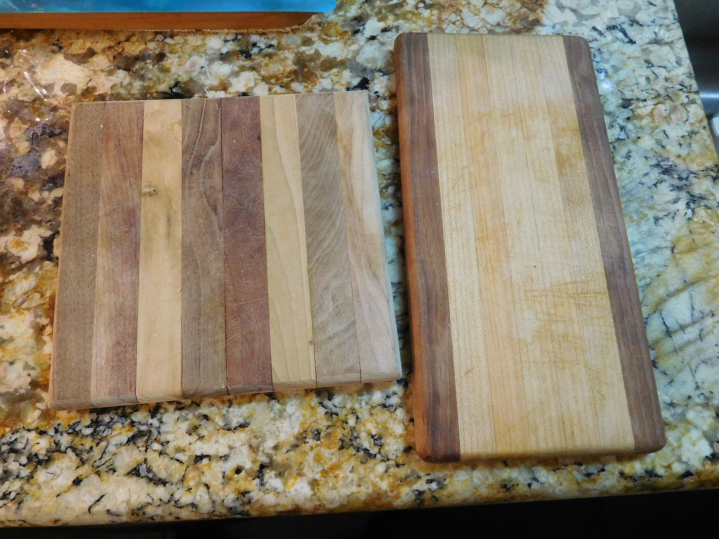

rrich--Good project. Maybe these will give you some ideas. They were both gifts. As you can see, the maple/walnut one is holding up well but the multi-wood one is beginning to separate at the seams.
But if you are looking for a low bar, how about a 40+ year old piece of red oak?
I had a 3/8" thick piece and made a cutting board. After a dozen years or so, it split and then I had two. The other piece is still around and in use. Not only is this a cutting board, but also serves as a mallet when I need to send a knife through frozen chicken. I know you can do better than this one. Keep us in the loop.
