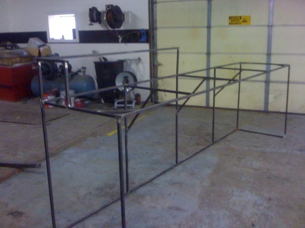

Made this sales counter frame for my friend's auto body business just last week. Made from 3/4" square steel tubing....
Ground all of the welds down so that the facia and countertop don't have fitment issues...
Hope to get the top and facia on later this week.
