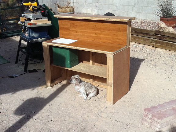

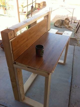

It's not a work bench but a drinking bench for the patio. :) This was my first wood working project and I am happy with the way it turned out.
First thing I did was draw out a rough sketch on a piece of paper and figure out how much lumber I needed.
i.php

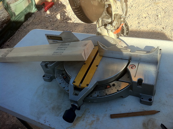

Borrowed saws and a router from friends
i.php
Made sure I had everything else that I may need
i.php
Made my first cut... all fingers are still accounted for.
Fired up the Chiminea to 'hide' any mistakes. :)
i.php
After some time later and two ****** Mary's.... I have a square.
i.php

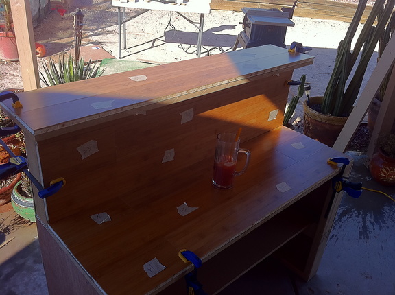

The base frame is complete (Layed out the Bamboo panels just for testing)
Framed and skinned
i.php
Installed top of bar... err bench, added shelf and cut Bamboo Flooring to size, and test fitted.
The entire bar was built around this cooler... I wanted something that sat flush and was tall enough to hold a bottle of wine. The cooler sits on the shelf that was mounted at just the right height so the top of the cooler would be flush.
Routed out a lil finger hole so you can lift the top of the cooler open

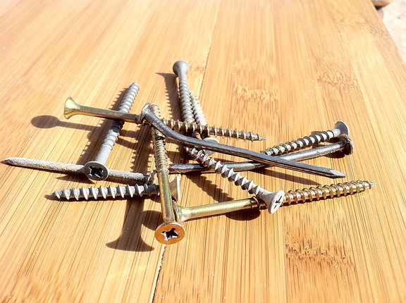

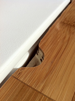

Started using nails in the beginning but I got tired of bending them, I then tried to use 3" screws with out pre-drilling and stripped a few heads. ...lessons learned.
Not too bad though, just had to add a few more decorative touches and it was done. At least done enough considering all the ****** Mary's consumed during construction.
