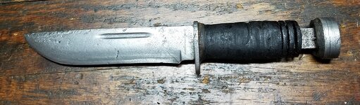

When the handles on knives deteriorated, especially in the PTO, soldiers and sailors replaced the stacked leather washers themselves or with the assistance of their pals in the various maintenance shops, with whatever material was handy. Aluminum scrap, micarta insulators, plexiglas, even wood. There is a famous example using red and black checkers. They would cut out the scavenged material coarsely to size, mill the slot, and then sand the whole thing down to form. But they got stylish and creative with it. They would stack them in patterns of broad bands or alternating stripes of different colors.
Here are some photos for reference. None of these are factory handles.

My preference is always preservation first, but this handle was falling apart with the mildest of handling, and the leather spacers were permanently stained with what I suspect is the Gutta-percha inside the Chatterton's compound in vintage black cloth "friction" tape that a PO had wrapped around it. I had removed as much as I could, but it had become congealed with the old leather. The first and last rings, more like spacers, against the guard and the pommel, made of some kind of composite, micarta or the like, were also cracked and deteriorated.
The pommel is made of three stacked steel spacers. Those two twist nails hold the spacers together and secure the entire pommel to the first leather washer in the stack. The middle spacer has an angle cam inside that turns 90* to lock or unlock it with a notch in the through tang. These knives got used hard and the pommels are often found with dents and divots. I was happy to see the classic waffled face of the **** end and the famous "division sign" were untouched.
Staring at that empty tang and thinking about "theater knives" inspired the idea to recreate one instead of re-stack it with leather washers.

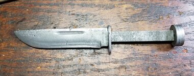

Easier said than done!
There are dozens of YouTube videos of someone re-handling a Catt Q. None of them had the problem I ran into. In each one, after the nails were tapped or pulled or simply fell out (yes, that's how loose some of the survivors are), that 1st spacer came right off, followed immediately by the 2nd, which turns to remove, as I alluded to before, followed immediately by the third, lickety-split.
My specimen was a lot more stubborn!
That first and second locking spacer would not budge. It's as if they were fused together, as I suspected, by a film of interior rust. And, as you can see, there was not any separation between the opening in the 1st spacer and the tang on the **** end. Keep in mind, I could not tap on the 2nd spacer to tap both it and the 1st spacer off the end of the tang, because the 2nd spacer was turned into lock position on that notch.
I soaked it in Evaporust. I tried getting a little separation by tapping an old knife blade in between. I poked a punch through that cam angle opening in the 2nd spacer to try to punch the 1st spacer out. No movement. I tried turning the second spacer. No movement.
This is where I left it last night.

This morning I woke up more determined. I did not want to marr the exterior surface of the pommel, but I had to, figuring I could fix that later with a file and buffer. So I put the knife in a vise by the tang and clapped a good pipe wrench around only the 2nd spacer and twisted hard.
Voi-friggin'-la!
That allowed me to slip that up the tang for better visibility and access to the problematic 1st spacer. It also allowed me to tap the 1st spacer up the tang. Revealing the issue.

The end of the tang had been peened, either deliberately or in the use of the knife as a hammer.
A hand file and some elbow grease soon resolved that.

I am not making this as a reproduction or example or representation or prop of a "theater knife" that could've been made this way or found or been an actual souvenir, etc, to be used in a Living History capacity or a movie etc. (I will quickly add that while I have never seen one, I don't pre-suppose I'm the first or only WWII buff to think of this, and I wouldn't deny the possibility some soldier in WWII thinking of re-stacking his knife wouldn't look at all the other striped examples, be reminded of a ribbon, and get the same idea.) What I am doing is way to pretty and shiny to be passed off as a relic.
Does this help give a better idea of my intention?

After careful deliberation, I have decided to do a swift 'About Face!' on myself and my desire to keep my design a secret.
A couple different posts yesterday and a PM early this morning and now Tom's post have convinced me that trying to talk my way around it is confusing, and I am potentially denying myself untold good ideas from the community.
As Tom alluded to, I like aged, faded, and worn on vintage stuff. I like to preserve, not strip and restore. So much so that I actually artificially put the old back into toolboxes that I have to refinish so they don't look new, and I coined a term ("prestorvation") for the process I use, discussed in this thread devoted to the subject here...
That me would probably not touch the pits on the blade, guard, and pommel of this Q knife, and would probably re-stack the handle with old leather, or new leather but then stain and distress it to make it look 70 years old.
But every once in a while I get an uncharacteristic wild hair up my ascot, especially when the item in question is in really rough shape.
This late 1920's vintage Blackhawk 32-CD Quick Disconnect era socket set I glitzed and gussied up and named "Black Hills Gold" back in 2012, where none of the finish was left on the case or the tools, is a good idea...
I'm going to file, grind, buff and polish this blade, guard, and pommel to a wallhanger-like mirror shine, and put an award-worthy handle on it to match.
