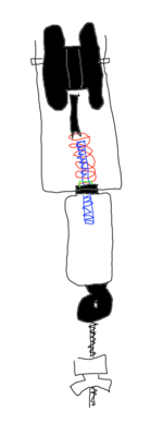

An idea strikes!
How about a normal coil spring, a very stiff one. All thread running through from top to ballast enclosure. Support rods ‘prop’ being supported by the edge of the spring. And using a nut to adjust tension by raising the spring up or down. Only real issue I see is; A. will the spring be enough to keep the lamp head aloft and B. Keeping the top half of the spring from being shoved too far away from the body.

Will a worm gear hose clamp work around the spring to temporarily retention it? I can‘T tell from the photo if there is room.
Zeke
Aug 13, 2009
17,176
If all you have to do is get the hook up where one of the notches are and insert the rod, weld a 2' long rod on the hook and bend it up there. Seems as there are more than on notch it is adjustable for tension. If it is adjustable then someone can adjust it. If you're having trouble holding it put one side of the spring housing in a vise and wind the spring in the horizonal position.
If you don't have a welder drill the hook and double nut a hardened rod to it. Or use a long tight fitting drift with a cheater if necessary. There is no stress on the high part of the hook arch.
Bert's idea might work if the flat bar doesn't bend or run out of room. You can add stiffeners but at one point you'll have more work in the tools to fix it than the lamp itself.
