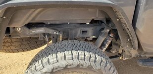

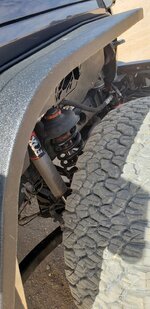

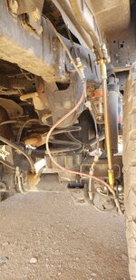

Also thought I'd give a short update on my Jeep's suspension since I "tweaked" my rear travel about a month ago.
Last year when we ran Camp 5 trail in South Dakota, I tried a different line than the other people on the run that day. The easy line was far left as you come up out of the river bed, mediocre line is just a few feet right of the easy line and the hard line was right up the middle. I tried the hard line last year and got turtled on the second boulder. I was moving through it quite well until my frame made contact with the second boulder and it unloaded my rear axle so the tires weren't gripping anything. I tried bumping it and working the front steering while both front and rear axles were locked but just couldn't progress any further. I was able to back off of the obstacle and then took the mediocre line and crawled right through it unlocked.
This year as I was tail-gunning for the group I again headed for the hard line and the wife asked if I thought this year would be any different? I told her we'd find out after getting about an inch more suspension travel in the rear. Well, that inch made a difference. As I climbed up the second boulder the front flexed well over it and as I come done slowly I barely made contact with my right frame rail which is right where I got high centered last year but this time I barely scraped it and the Jeep continued moving forward through the obstacle. Next thing I knew the right rear tire was climbing the boulder and we were up and over it and emerging from the river bed.
I just looked at the wife and grinned like an idiot. That small amount of rear suspension travel that I was able to gain made a difference by letting the axle droop out just enough to clear and keep traction on the rear tires moving the Jeep forward. Also with the stiffer rear coil springs and the good amount of anti-squat I have in my Jeep as I 2-footed the pedals and advance forward it kept the rear from squatting down and actually lifted slightly which also helped get over the boulder.
To say I am pleased with how the Jeep handled is a huge understatement. Bring on the next trip...... :bounce:

On a separate note, I had asked you a while back about the Gladiators and I finally got to ride in one this weekend. A guy on my team brought his out to Barstow when we were shock tuning, so he took me for a spin. I was super impressed with his setup in the desert
We were smashing good size whoops at 45mph that a Raptor or TRX wouldn't have done nearly as well. The steering was actually rather impressive. I think the wheelbase would be an issue in the rocks, but his primary use is desert and overlanding.
-Rock Krawler links/springs
-37" BFG's
-Fox 2.5" shocks with clickers
-Fox hydraulic bumps
-Curry rear swaybar
-Manual transmission
He beats on it hard and he said it's held up great. He had to put a new front axle housing in due to cracking the original, but it was definitely on him. He also blown the Fox bumps a couple of times, but Fox keeps reaealing them under warranty. He was all too willing to jump it, but I declined the offer.....
