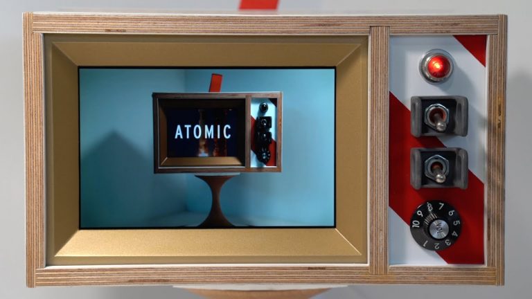

I had a bunch of spare parts left over from two other tech projects and decided to make a TV – sort of. It’s actually a little all-in-one computer that’s coded to automatically loop and play videos that are loaded onto a thumb drive. And while it’s capable of sound, I am using it as a sort of art piece on my shelf with the sound on mute.

Hey Ryan - love the project. The retro NASA vibe really sets the piece. So what did you put on the Pi to make it play the videos? I want to do something like this for my mom - she lives in a senior living facility and loved the show MASH. I thought I would get all the episodes and put them on a Pi and just let them randomly play. That way she could turn the TV to the input channel it is hooked up to and watch it anytime she likes...
R
Ryan
Administrator
Jan 26, 2006
5,743
Texas/Hawaii
Yes. It’s super easy to do... and you could it with any tv that has an HDMI setup.

Cool project and it does look like a micromicrowave.
Aren't most switches mounted "up is on" & "down is off" ?
The Pi's are interesting, guys here were mentioning them when I was looking to get a new computer.
R
Ryan
Administrator
Jan 26, 2006
5,743
Texas/Hawaii
Yes on the switches. Two reasons for this:
1. I am a bit obsessive compulsive... and being this thing is going to be on all the time, I wanted the switches to be facing the same direction when it was on.
2. So why didn't I mount the momentary switch up top the other way around? This is stupid, I know... But while reading the NASA Apollo wiring standards, I came across a line that reads, "All momentary switches must be mounted with the resting state down."
I know... I know... but it's my TV... err... whatever this thing is...
As for Rpis... They are amazing. I probably have 10 to 15 around my shop doing different things. And yes, if you aren't creating content and only consuming, they are great little computers. Browsing the internet, streaming video, email, etc... The Rpi 4 can do it all.
In fact, this little "TV" would actually make a great iMac replacement. Just add a keyboard and a mouse.

Loved the project! I have a few questions:
* What are you using to play the movies? VLC? OMX Player?
* Do you have a script to automatically launch this and play the movies?
* What are your 'favorite movies' that play on loop?
Love your attention to detail. Keep up the great work!
R
Ryan
Administrator
Jan 26, 2006
5,743
Texas/Hawaii
Tom Sachs has "Bullet Points".
Your manifesto - "Sugar-fueled rage as a means to focus"
(Your ideas are as cool as anything that comes from Sachs, plus the fit and finish are far superior.)
Love this project.
Interesting to see how 2 of your spray bombs have bottoms that are bulged out...I've never ever seen that happen and you have it on 2!
I've got nothing on Mr. Sachs... He's an obvious inspiration. He saw my keyboard... and gave me some shoes!!! So rad.
OMX players... Here's the script:

Everything is in 1080p, so I have space for a ton of movies on the 256GB thumb drive. I think I am around 75% full right now. And I put everything in Final Cut and reformatted each movie for 16:9 to utilize the whole screen. In some cases, there is cropping... but I don't care... it's art. :)
And I should mention - even with the art glass about .75" in front of the screen, the picture is really great. I've heard putting glass in front of an LCD is a bad idea because it creates glare and reflection, but I wanted that glassy look of an old gauge or monitor... and I don't think it has effected the picture at all.

My wife thought I was nuts because I paused the video and was right up against the tv trying to figure it out.
mybigwarwagon
Nov 4, 2009
4,428
Vale, Nc
My wife asked why you would play movies with no sound. I asked her if she remembered my dad and I watching John Wayne in The War Wagon with no sound and enjoying it. She shook her head and said, "men!".
R
Ryan
Administrator
Jan 26, 2006
5,743
Texas/Hawaii
The idea was that it’s interesting to glimpse at the thing a couple of times a day just to see what scene from one of your favorite movies is playing... and I’ve noticed that every now and then, it will be a scene that I love and I’ll turn up the volume and watch it a bit.
I’ve really enjoyed it actually... so much so, that I’m building another out of a raspberry pi 0 and a 1940s era radio case I had on hand. This one, however, will have a 4.5” 4:3 format display.

Ryan, question on the power switch...
Why is the down position "on"?
Typically, up is on.
main-qimg-a097a83437e0aac5c0c0543bfb870538
R
Ryan
Administrator
Jan 26, 2006
5,743
Texas/Hawaii
I've since switched it... But here's the reasoning:
I followed NASA guidelines for switches. And one of the rules listed was that all momentary switches should be positioned down in their natural state. And since the TV is going to be on 99.9% of its life, I wanted the switches to be in the same orientation for aesthetic reasons.
In any case, it was bothering me... so screw NASA... I turned the momentary upside down and put the on/off switch in its rightful position.
Oh, I will add, having been involved with that kind of stuff... I find that odd. Momentary switches toggle are typically "off" when not activated, aren't they? But it does depend how you think about it. You can be activating the off command to the RPi, or you can be pushing the switch to the off position.
I'd be staring at the question way too long!
