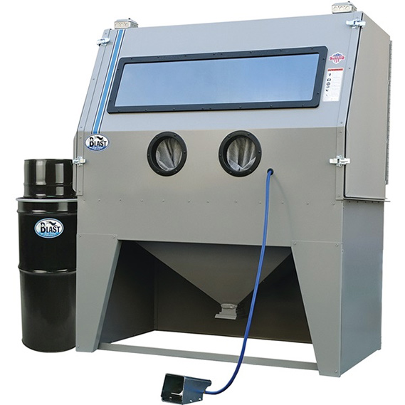

A few years ago, I bought a TP Tools blast cabinet for the hot rod shop. I liked it so much that soon after, I contacted TP to let them know how I pleased I was. In turn, that lead to a sponsorship of The Garage Journal that has lasted ever since.
In any case, I figured it was about time I showed TP some more love and featured their latest cabinet – the 9736. Essentially, this one is very similar to my own – only larger and perfectly sized for the automotive guy that needs to blast a lot of wheels and larger items. Plus, it’s made in the USA.

I have a HF cabinet that I got on sale many years ago. I hate it.
I have to move it outside of my garage in order to use it because it leaks dust so much.
I've even caulked the insides. But to no avail.
I've never used any other blast cabinet.
How are these at keeping the dust inside?

I have the TP 960 and love it, however I could really use the extra 12" for doing fenders in house. To answer tig's question, I have the after filter on mine as a precaution and have never noticed any fugitive dust.

I went through that ****** orange plastic thing once a year...
This thing is a different world from those. If you keep up with the dust extractor, dust isn't an issue.

I've had my TP cabinet for probably 20 years. I also have one of the vac units.
What I did find about dust getting outside the cabinet was three-fold. Maybe four-fold.
1. I have a tray that installs under the door opening and it catches a lot of dust/grit that would wind up on the floor.
2. I installed the interior blowgun to blow off the work piece prior to removing from the cabinet.
3. Waiting a moment before opening the door for the cabinet to clear.
4. I recently installed the filter that goes on the back over the air inlet. This was where some dust, etc was getting out

I bought my old man one of their 960-DLX cabinets as a gift a few years ago. He adores it, and would never use anything else. One upgrade that I cannot recommend enough, is to size up to one of their commercial dust collector options. You have to do this when ordering the cabinet, since the hose diameters are different and they modify the cabinet to take a larger flange before shipping it out, but it's absolutely worth it.

I also have the TP 960 with foot petal and interior blowgun. In an effort to keep the dust from getting into everything, I added their optional 180-DC Insider II HEPA Dust Collector and final filter. It does an amazing job of cleaning parts and the dust that escapes the cabinet is almost non-existent. They also make an abrasive reclaimer that goes between the blast cabinet and the filter. Unfortunately, I just don't have the room to add the reclaimer without totally relocating the cabinet and filter. Hopefully at some point, I'll get around to doing that. I've been doing business with TP Tools for over 15 years. They've been great to deal with and have provided great products at a fair price. I highly recommend checking them out if you're not already buying from them.

Replying to some of the comments:
- Foot pedal is a must
- Re-claimer is up there as well (I happened to get one of the last basic Cyclones from Cyclone Mfg in Michigan) Works great and has a hopper dump chute in the bottom
- For those that do not use a vacuum - of course material will be forced out... basic physics - vacuum vs pressure

Stuffing a piece of foam in the vent on the back of cabinet allows it to breathe, but without sending dust over half the shop.

I picked up my TP skat blast at Hershey years ago. I don't think you can do better for the money. I have a piece of towel held by magnets on the top of the cabinet. The towel protects the plexiglas window on the outside..there's always a lot of airborne stuff floating in the shop so nothing gets dragged across the surface when it needs cleaning. I also leave the 3 catches that hold the top closed unfastened when not in use, it keeps the pressure off the gasket. You guys are right about the interior light (or lack of it) I have a bunch of LED paddles that I'm going to install (it's only been about 12 or 13 years).
I constructed a filter/separator out of a plastic bucket and a HEPA shop vac filter. That connects to a little "Stinger" vacuum from HD. I went with the little vac because it was super cheap and I wasn't sure how long the bearings would last but I'm still on the original vac after all this time. The actual vac canister has the factory filter bag and the canister is essentially clean all the time. I wouldn't use a vac as small as the stinger again though, it is a little lacking on air volume but I sort of put up with it because I'm so cheap.
