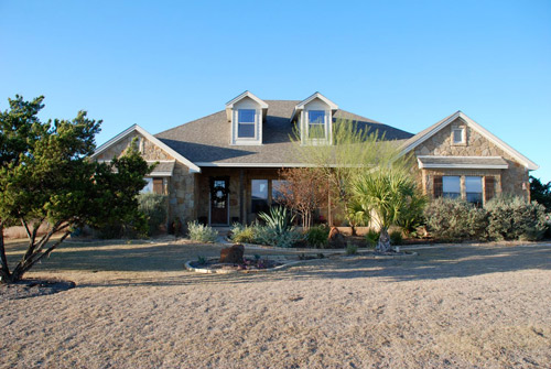

So what you see above is our typical Texas ranch home. Our family lives just outside of Austin, TX in the quaint little ranch community of Dripping Springs. Drippin’ (as us locals call it) offers a short commute to the best town in America (Austin) as well as room to stretch your legs – we’ve got just under three acres.
Of course, that’s not just our home above. It’s also the GarageJournal.com world headquarters. Working from home has been one of the best things that has ever happened to us. The time gained around the family and our kids is absolutely invaluable. At the same time, however, the distractions of working from home can also be a really tough hurdle to jump on a daily basis.

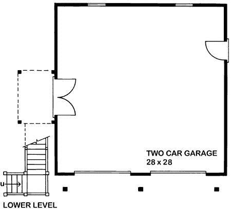

Here’s a quick glance at some of the plans we liked:

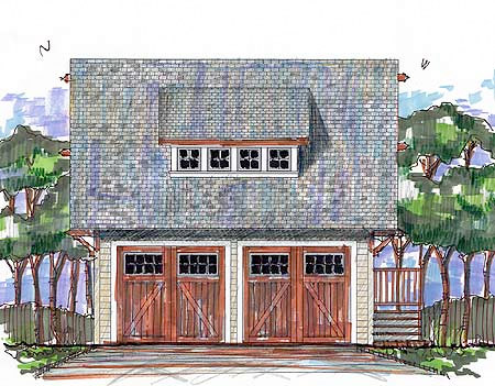

Concept 1
Although this garage doesn’t feature a hip roof like our home, I do think it does a good job of mimicking our architecture. Imagine it with Texas stone instead of siding… I’m not crazy about the out door stair case, but it does free up room for a nice size garage and an incredible office up stairs. Obviously, we wouldn’t built out the kitchenette.

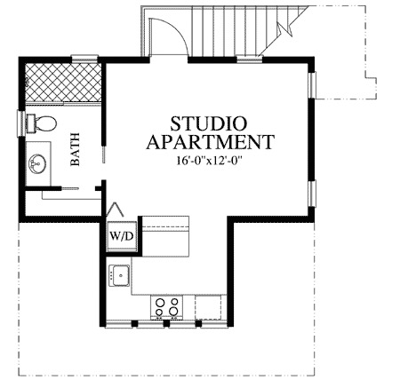

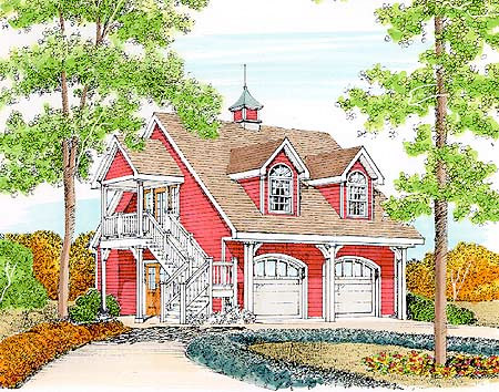

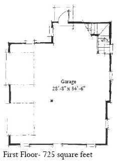

Concept 2
From an architecture perspective, I love this building… It just looks like a southern Texas barn, does it not? I have no idea if it translates well with our current architecture and really think it would be a hard sell to the neighborhood committee… but I really want to try. Both the garage and upstairs office are perfect for us.

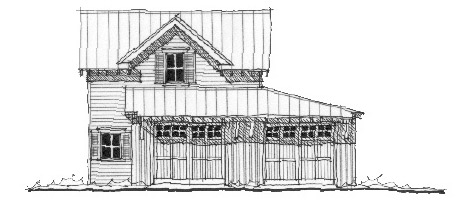

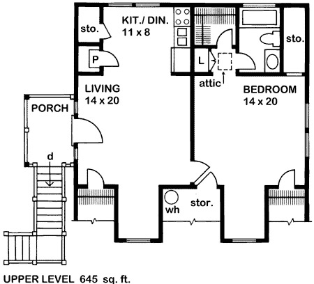

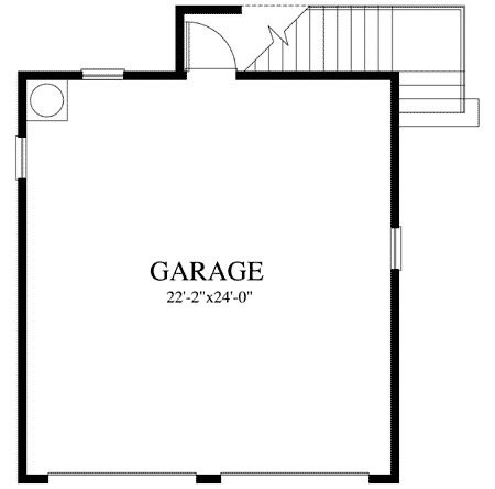

Concept 3
We are going to include this garage in the group simply because it’s small… and to the uneducated eye, more affordable. While we do like the look of the elevation, the shop space is certainly smaller than we would like and the office is just barely manageable. If it’s all we can afford, however, it’s all we can afford. Time will tell.

I would definately look at a larger single floor space then a two floors. Definately do a price comparison for the same amount of floor space. I know I would have a hard time cleaning up well enough to wall through the office are to use the bathroom. With the bath on ground level you may be able to put a door on each end of the bath seperating offica and garage space so you don't even have to enter the office when greasy or dirty feet. Also make sure to think of a dirty area maybe behind the shop or a small area in the shop. Lets say you build it a little bigger, maybe 30d x 45w you could still have a 30 x 30 garage space, 15x10 office space, 5x10 bathroom and 15x15 dirty room. You could still put a couple of dormers to keep the look and add natural light, and maybe scissor trusses to help with a lift height. And at 30x45 it is within 50 square feet of your first option in your blog.

Concept 2 rules. I've always liked the idea of a 2 story garage but have no personal experience with them. Good luck with the build!!

I personally like concept one better from an exterior standpoint, because your right, it does do a good job mimicking the house's architecture. Concept 2 is a nice design with floor space and all but i dont think the exterior goes well with the house, unless u really WANT it to look like a barn. Concept 3 seems like settling compared to 1 & 2. but it is about what u can afford in the end....

Concept 2 would be the most interesting but also the most costly to build. The inset second floor also dictates a column in the shop area below which isn't all that great. The second floor is also fairly small and useless as anything but an office.
Options 1 and 3 have the same positive things going for them. Simple rectangle shape is efficient to build and can be enlarged easily now or in the future. Set the building back so there is room to add a bay at one end and frame a large opening (or window) in that end wall. When it comes time to add the third bay, just move the window to the new endwall and cut out the framing below the sill - instant doorway to the new bay. The second floor is built within the envelope created by the roof with dormers added so that makes the space essentially free before you start adding finishes.
