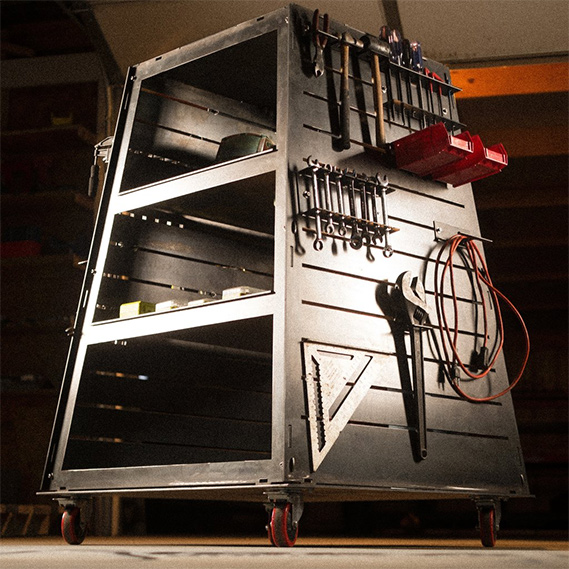

I love stuff like this… I got an  email from Jesse Sotta the other day asking me to check out his mobile tool center. Essentially,  he’s just a guy like one of us with an idea and a pretty damned noble cause – build a better way… And I don’t know if this cart is a better way or not, but I sure do like what I see. And there’s no doubt – this thing would last through just about any kind of apocalypse.
Check out the details here.

I'm sold... Genuinely. I wouldn't call it reinventing the wheel. Or Groundbreaking... Or a new Idea... but I think its fantastic! Its well packaged and looks like it would be at home in any workshop whether shed or Penthouse Man-cave...
I have a thing for heavy duty and that looks like it could survive a few generations. A few improvements to suggest though (listen someone was going to mod it first thing they get it regardless... there is always one!!!)
Looks like the Holders and racks are Bolted on... That could make quick change layouts Frustrating. A little lip on the shelves to stop things flying off if they slide easily on the steel.. (ok non slip mats I guess but I like that raw steel look) I guess its supposed to be a Tool Trolley not a Work Bench and its hard to judge how tall that is... I cant help think how nice two of those next two each other would work as saw horses if at the right height... Maybe some "Standard" layout Precision Clamping and Jig Holes on the Very top plate would increase versatility.
Their other products are pretty wicked as well... You overseas ladies and gents get all the fun things...

54" high, 3'x3'.

That think is huge looking at one picture. imagine having socket pegs on the sides right at eye level when you are on a stool and you could just turn and have all of the sockets smack in your face. oh I would buy it just for that. seems too thick of metal for just tool holders. looks like It was designed to hold heavy weight not just hand tools.

I'm not feeling it. I don't see this has any advantages over roller tool box or tool cart. I don't care for pegboard and this has a pegboard feel.

These "A-Frame" tool carts are great if you have the room and don't work with guys that help themselves to your tools. I've got the Snap-On version but I'm getting rid of them because of the previously mentioned negatives. I suppose a smaller version would be handy at the home garage.

I would think a very nice setup would be to have drawers on the "open side" of the cart, one or both. But that's about the same as building some "wall panels" for an existing roller-box and then beefing up the casters (if thats needed, probably for lower-end boxes)
I would like this shadowboard concept for my "large" combination wrenches, say 7/8" up to 1-1/2". They are jammed in a drawer and usually have to take every single one out to get the one I need. Then they don't fit back the same efficiently random way and I have to spend several minutes fooling with them to find the sweet spot again.

The 3/16" could be overkill for a lot of applications. However, we wanted to make things as simple and strong as possible so that shipping and assembly is easy for people. Without getting into building tube frames, etc. to support the structure we found that 3/16" was perfect for the strength we were looking for. We also use domestic steel for everything, and that is a premium cost. But, we've used import steel for other projects before and it's simply not as flat or true to work with. It's amazing the difference between steel that is all supposedly the same specifications depending on what country it comes from.
You could probably get buy with 1/8" or something, but we are moving some big/heavy items around the shop and this thing will survive a bump from a piece of 2x3 tube where we've crumpled the Husky tool chests we have before with one accident that made them useless afterwards. We had to pry bar open a drawer that had a decent dent in the side before...
We honestly just build the things we want in our own shop and offer it to others that might want the same kind of thing. We've got a Harbor Freight tool cart, we've got several Husky tool carts that we bought on Black Friday deals. They're fine for what they are but I wouldn't go back to not having the Tool Tower around and plan to build some more for our own shop as soon as possible.

It actually assembles using a tab and slot design, so it's self supporting during assembly. You start with the base and add the sides. The Front/Rear pieces of three tabs on each side that fit into corresponding slots on the side pieces. We make what we call "shoulder tabs" that slide into a set of slots on the side pieces and then you bolt through the Front/Rear pieces to secure everything. I posted some pics to show. It sounds more complicated in writing that it actually is...

This may have a good fit in a production facility where the types of tools needed are a few and frequently used. Sorta like a shadow board concept.
Also no good way to lock anything up.
