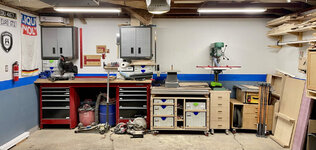

One thing that's always bugged me is the drill press being in front of half my tool drawers (where I currently have all my sockets and wrenches). And with the GTI in I can't move it out of the way, so not only do I have to move something, I have to back the car out.
There's really not much other place for it to go... but it got me thinking... maybe I should cut down my table saw cart?
Somewhere around that dotted green line. Then I could fit the drill press next to the MFT, in between in at the table saw.
I made the table saw cart and the MFT before I got the drill press, so it was kind of just arbitrarily sized.
The only downsides I can see to this is the drill press table overlapping the MFT surface a bit if I want to set something big on it (like a cabinet) and not have to pull the cart out. And I wouldn't be able to open the drill press cart drawers when my wife's car is in the garage, where I store some drill bits and drills and such. Dang cars!! 🤣

How difficult is it to install/remove the drill press top? If it's fairly easy, it might be worth hanging it on the wall. That would solve the overhang issue while still leaving the drill press accessible for the quick hole here and there.
While I don't disagree with Austin on the cabinets, another option might be to build a shelf that runs across the open wall with a half sheet of plywood and simple shelf brackets. The shelf could be use to store the sander, miter saws, and systainer boxes, freeing up your workbench space.

@MadeByMiller @bdbecker @Xti04 @Trapps thanks for the input. I think I will cut down the table saw cart and move the drill press. Removing the drill press top and storing on the wall is an option.
I think redoing the upper wall space is in order, probably with all the methods mentioned (cabinets, open shelving, french cleat wall). I have some ideas for layout and hopefully can get to it this summer. I also want to paint the interior all white, which probably should happen first.

Table Saw Cart Shrinkage
I decided to commit to the drill press move. I spent an evening doing surgery on the table saw cart. It was more work than I expected. First took it apart, and then used its competitor brother the track saw to rip it down.
I've become a fan of these PowerTec trigger-style rail clamps for clamping the rail instead of the Festool ratcheting ones.
Thanks to pocket screws, the top and bottom were easy to deconstruct from the back.
The back of the cabinet is inset a bit, so I couldn't do that with the track saw alone.
I ended up trimming it close with the track saw, then screwing in a piece of plywood as a router bush guide, flush trimmed to that, and finished off the edges with a hand saw.
I reused the old side panel, but added some new pocket holes where I had used brad nails before.
Got to use one of my new 50" parallel clamps I got used, for a steal. There was some bowing, and they do such a nice job of holding cabinets together.
Remounted the casters.
And here he is, 30% smaller and cuter.
I wanted to retain some surface to the left of the saw for setting stuff, especially when cutting a series of boards it's nice to have a place to put them.
By this time it was 10pm. First time an a long time I've had a night working in the garage, on the garage. It felt good.
All tucked in:
I think I am going to use the blank wall space behind the MFT / drill press / table saw for a french cleat system. And looking across to below the lumber rack, I might do some larger open shelves there.
But I'm already happy with this decision. It's so nice to be able to access my wrenches and sockets, and be able to walk in front of my car.
The drill press drawers are not very accessible with my wife's car pulled in, but they weren't very accessible the way I had it before, either. Can't win them all.
That's it for now...
