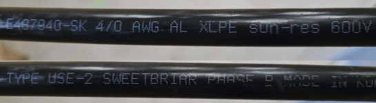

I guess I dont have a clue when you say feeder insulation, so unless it's something the electrician did on the meter main side, I do not know. FIrst i've heard of it.
The insulation on the wires. It's not rated to be indoors and is not code-permitted for your use unless it is labeled RHH/RHW-2. If it only says USE-2, the inspector and electrician are 100% wrong

DO NOT UNBOND ANYTHING in the shed panel. That would make an undesirable situation 10x worse....as in really unsafe! CB's in the panel may never trip during a ground fault condition. Any ground fault to ever occur should be protected by the branch circuit gfci protection...(mostly = not 100%). The ground rods have nothing to do with helping this 3-wire feeder situation get any better. They serve another purpose.
As long as you don't add any conductive ground paths between house and shed, the 3-wire feed will remain as an undesirable situation, since realized in NEC code revisions, and your install is simply "the old way" it was done pre 2008 code change.
Take a pic of the feeder insulation printing (usually white dot-matrix print) and post it. The concern is that the cable insulation is not the correct/allowed insulation within the building.
There was some discussion in another thread recently that the NEC doesn't recognize URD material, I believe in part due to it being the wrong alloy.
mm08822
Jan 13, 2012
6,305
The OP has not yet confirmed the feeder type. It may be URD or it could be USE, or dual rated USE. If dual rated USE, then the alloy would be ok.
Here's the wire I buried - It comes into the shop via 2.5" LB's and conduit, all the way into the panel.
