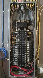

Been following along as this has been a good learning exercise.
Dumb question.... Now that its been determined that the feeder to the detached garage is missing a ground, and has the wrong insulation for interior use, would it be possible to add a direct burial ground wire? Or is this a no-no since the ground wire would not be bundled with the rest of the cables?
His wire is 4/0, 4/0, 2/0 triplex aluminum URD, which is 3 loose conductors with a slight spiral wrap around each other. Since its not sheathed, why would it matter if the ground were separately run, and perhaps at a different (more shallow?) elevation?
Composite picture below from the OP's postings. On the left and middle picture, you can see that power to the detached garage comes thru the wall via back to back LB's. What if the exterior LB were changed to a larger junction box, and the section of wire from that point to the panel were removed and replaced with either SER or XHHW with 4-wire? Then the added ground brought up thru the conduit to the new junction box and properly connected (polaris type connectors or similar). Meanwhile, the right picture shows were the ground would connect at the disconnect's factory neutral-ground bond. Lastly, at the detached garage panel, the ground screw would be removed, and the neutral and ground bars properly separated along with their connecting wires.
Trying to think of a way to correct this in a least cost manner vs wholesale replacement of the entire feeder.
That would be sufficient to deal with the insulation issue.
The ground needs to be with the rest of the wires, AFAIK...i believe the NEC says "in the same Raceway", but I don't know how that exactly works with direct burial. Touching?
If this whole run is in conduit (I can't remember) , this is a pretty easy fix.

Mike I interpret the OP's installation is simply direct burial without conduit but it should be clarified.
Post 53 by the OP
....and trenched it into the shop...
Post 96 by the OP
Of course, I'd love to have it perfectly code correct, but it's also december, with a foot of snow on the ground, and running a 4th wire 4ft down in a trench that's already re-filled AND has a gas line running on top of it at the 2ft mark is extremely not practical.
Regarding keeping the conductors all in the same "raceway", the ditch is the raceway. The 3 conductors are simply spiral wrapped (no sheathing) at the bottom of the ditch and these often separate when dumped in the ditch as I have seen when new services are run. Why would it matter if an added direct burial ground were placed not directly with this group at the 4' depth?
I am not a sparky, just trying to think of way to salvage most of this.

So just to throw in somewhat of a conclusion here -
I've been chatting with @mm08822 about the same thing @larry4406 suggested - next spring before I fix my trench mess I want to buy a EGC and bury it in the trench at a somewhat shallow depth.
In my mind, having that wire exist, however at an incorrect depth, should be better than it not existing. And if it was hit by digging, it should be a pretty tame situation.
That should also be something i'm 100% capable of doing myself - I know where it goes in the meter main panel, I can get it into the shop on my own, then I can just make the changes in the shop panel and I should be good to go. Or, better to go. Just out a few more hundred dollars and a week of stress from this forum lol.
Thanks again everyone for the insight, although living in ignorance of 3 vs 4 wire feeder and the definition of a subpanel had its perks haha.
