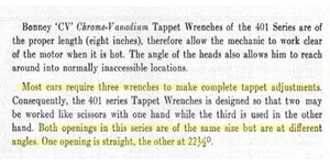

Here is my Bonney No. 412 set. Bonney 412 series tappet wrenches also used the 15* x 22-1/2* configuration, but the ends have the same milled opening size. They came in pairs, like some ignition wrenches, affording each size each angle.
20211020_091859.jpgBonney Tappet Set No. 412.jpg20211018_091321.jpg20211018_091346.jpg
When used in tandem on a tappet (15*) and a locknut, the 22-1/2* angle provides a little more "bite" (turning radius) than the 15* end, made more manageable to accomplish with the same hand's thumb. As implied here...

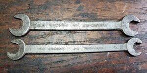

...a previously posted Williams tappet wrench. They didn’t want there to be any confusion about what the wrench was to be used for.
As Leg was saying with respect to Herbrand, because their thin beam required the additional strength through composition the most, tappet wrenches were some of if not Williams' first wrench types to get the alloy treatment, and their really early ones had some funky markings.
I've only ever managed to find two much later examples in the wild.
I'm not sure when the SPECIAL -TAPPET- ALLOY wrenches were made, to be honest. But mine is an A90D. The "A" mimicking the "A" in Alloy.
The one with the odd-looking openings (larger die probably used for larger openings prior to milling...) is a Superrench Chrome-Alloy 1090-A (3/8 x 7/16) and probably just prewar, maybe 1942 at the latest. Satin finish with polished heads.

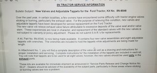

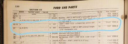

Here is the page from the 1949-1959 Ford Parts Manual showing the valve tappets. I have circled the 1949-53 part. This may be a service part update, as the manual wasn't printed until 1964. I believe that adjustable tappets came into use by early 1950, because they were first offered as a service part for the N-series tractors then. I'm sure the tractors were not the first to get the updated part.
Here is a screenshot of the bulletin announcing use of the adjustable tappets in the 8N engine. I don't have a date, but the reference to the "Service Parts Release and Change Notice No. 50-2" indicates it was very early in 1950.
