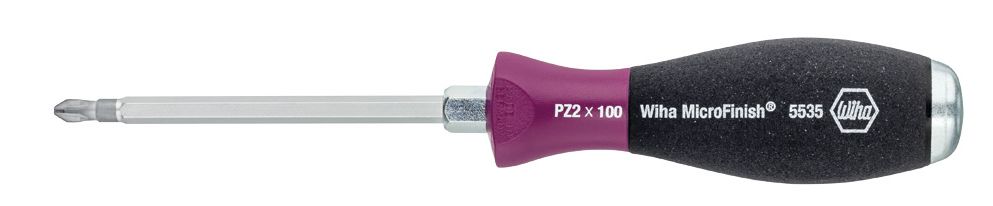

My favorite of the German screwdrivers is the Wiha Microfinish line with the purple and black handles because they fit my hand and the grip on them is great. But as far as actual performance goes, all the good brands are, well, good.

While all the Wera ones I've used are soft-handled, Wiha has a pretty good range of handles and the Microfinish purple ones (also happen to be their most expensive ones) I find to be some of the best with grease. Their blue and grey economic screwdrivers are a little softer, closer to Wera and Felo, though probably still a little firmer than either of those. But most of the Wihas are fairly firm. The red ones and purple ones are firmer than the economic ones.
I have a couple of the Wiha economics and honestly they aren't that bad with grease and oil, but the Microfinish are definitely better.
Microfinish is gritty like sandpaper, though it doesn't tear up my skin like actual sandpaper would. It's like the most mild sandpaper ever.

Wiha Microfinish are pretty awesome when you have oily hands. It's a hard plastic with a gritty texture that just grips. Not the most premium looking or feeling, but very functional.
Edit. Sorry, TuxThePenguin replied while I was typing.
hey lemons,
buyer's remorse triggered. :( :lol:
i have a 10pc set of softfinish, and sometimes i regret not trying both that and microfinish before buying.
i pretty much never get my drivers oily, and i've still never seen a microfinish in person.
do you like one vs the other for non-oily use, or are they about the same?

from reading your other posts, it sounds like good grip when oily is an important feature to you, and you're using them in dirty environments (garage, cars).
for slotted, i say go for pbswiss in multicraft handle. a big part of that is because i think pbswiss makes the nicest slotted tips (parallel style). i'd start with these and see how you like them. if you're in love with it, consider them in PH too.
then for phillips, if you don't go pbswiss, i'd add wiha microfinish (purple handle, specifically designed for good grip when greasy). i have wiha softfinish (red handle) and like them.
idk how good the vessel megadora handles are with oil. never used them like that. maybe someone else can chime in?
i bet their nonslip wood composite handles would be better though for that: https://www.vessel.co.jp/english/product/screwdriver/list/26
