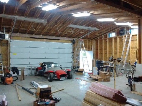

Electrician is coming to wire the panel and power me up Thursday or Friday. Yay!
Marretted a plug onto the furnace circuit to test - Furnace heats, yay!
I'll likely test the motorized damper and barn fan tomorrow. Yay!
Ordered 18 twin-tube fluorescents. With 32W daylights, I should have about 105,000 lumens. Yay!
Installed all the 110V plugs. Yay!
Wired the network drops and the tv inputs. Yay!
Pulled the fascia off because I totally screwed it up. Looks like poo. So I'm doing it again. Boo!
Have enough left-over siding to do the garden shed. Yay!
Left a message for the inspector to see if he is around next week for the occupancy inspection. Yay!

All the fascia covers have been replaced. Got the gutter and down spout across the front done. Couple around back to do today.
And....
We now have power.

And I flicked the switch, and there was light.
And the light allowed me to work during the darkness.
And I kept the darkness "outside."
And I kept the light "inside."
And it was good.
The first row of T8's are up.
I can't help but go MWUHAHAHAAHHAHAHA inside. It feels THAT good. I need a white lab coat and back-combed hair. And welding goggles. And large rubber gloves.

Passed the Occupancy Inspection with flying colours. Yay!
Got three more light fixtures to hook up. Waiting now for my electrician to give the go-ahead to close in the walls.

I asked my electrician if I should continue waiting for the Safety Authority. He said that they get the day of the call plus one more day. So.... I could have been insulating 3 weeks ago. Nice to know.
I pulled out my 10 gauge air compressor wiring since that's not going to be enough for a decent compressor. I only read my local supplier's online ad, which said 30A, which I wired for. Little did I know about turn on current, and motors, or maybe even looking at the manufacturer's manual even.
Instead, I picked up some 6 gauge and re-ran it. Never anything wrong with running fat wires.
Picked up 25 bundles of attic insulation and a roll of poly. Not really looking forward to this.

R40 insulation, 6mil poly, and most of the 5/8" drywall up in the machine shop. 11' ceiling.
The Princess Auto drywall-sheet-lifter-up-inator isn't sketchy AT ALL. I wasn't even a BIT afraid.

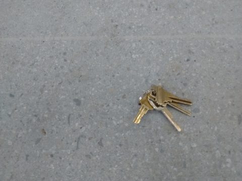

Shop is cleaned out and empty. Floor finishers have brought in the grinding equipment, and are grinding the surface down to be properly sealed and polished. This is going to be good.
I'll be closing my eyes when I write the cheque for this, but it's the floor finish to be all floor finishes.

The concrete slab is being ground in preparation for a hardening/sealing and polishing.
Grinding equipment.
The aggregate will be more visible - should look plenty cool.

Very nice! What did you fill the saw cuts with?

The saw cuts had strips of foam stuffed in them, and then a (I will likely get this wrong) poly-aspartic sealer thingie mixed with silica sand placed on top. It cured and was ground down even with the slab and then polished.
I hired a friend who does concrete finishing to do this job, I didn't do it myself.
