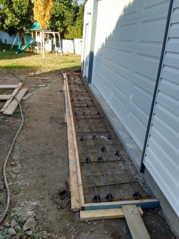

Drywall nearing completion. I put off showing this, because there isn't really much to see...
Apron forms ready for concrete. I want a two-day stint with no rain, and preferably not freezing.

Pops and I did the pour today. It all went well. There was a dead mouse in the forms, which I decided to name "Jimmy Hoffa," and we poured concrete over top of him. Makes for a good story.
I had 63 bags and used 34. I must have calculated on a 3' Apron, but I ended up pouring a 2.5' apron because I was afraid I'd run out of concrete. Humph. At least I certainly have enough concrete to do the edge to frame the pavers I will be placing.
