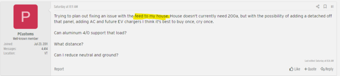

Trying to plan out fixing an issue with the feed to my house. House doesn't currently need 200a, but with the possibility of adding a detached off that panel, adding AC and future EV chargers I think it's best to buy once, cry once.
Can aluminum 4/0 support that load?
What distance?
Can I reduce neutral and ground?
