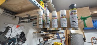

Little progress on a stalled project trying to tie up some of these and free up space
The pull out aerosol holders
These first couple are a bit taller for taller cans, last couple are going to be a bit shorter based on standard spray can height. Slide in and out well but may reprint a set of mounts to spread the slides a bit more to try and reduce movement at full extension

I love that idea but I have so many cans of spray paint. :lol: Completely fills one of those oversized milk crates.
Tom, be very careful how you store spray paint cans. Put them too close together and they multiply. There's another family in the shed out back. The cabinet carcass is 1x8 pine so it's only two layers of cans deep. The racks on the doors make it easy to find what I'm looking for because the second layer moves out of the way.

Bob, that's got to be my problem. I'm just sorta stacking them on each other. I'm doing half the work for them!

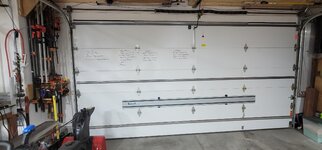

Hey look another half started project....
Using the big rail for 1st time
And 2 of 6 pieces up
The stiffner brace is over the top of that lower panel, have the piece for the top left cut, didn't get the sheet for the right side ripped down before nap ended so that will wait
If I like it enough I'll skin the other door as well. Attached with self tapping screws

That's a pretty good idea! How do cross stuff of my list when the doors open though 🤔 hold the youngest up in the air or marker taped to a broom ? My doors are almost never closed.

Doors are rarely open here so don't have that problem! Lol
When weather is really nice will open them...but this is the midwest where mother nature likes us to experience multiple seasons per day, so the mini-split allows me to be comfortable but anti-social with the neighbors
Yea if we were still in Indy between the bugs and the unpredictable weather I would be different.

Love the whiteboard idea! I've been wanting to do that, too. I was going to redo some cabinets above my workbench and do a whiteboard door on a few, but I'd never even considered something like the garage door! I almost always have mine closed while working just to cut down on noise pollution for the neighbors. Intriguing...
Will quickly admit I saw the idea somewhere at somepoint. I did actually try and write directly on the inside of the door and it kinda worked....however the metal interior had just enough of the textured/pebbly surface that it was a pain to erase and was probably going to take a scrub brush to erase and that didn't sound like a lot of fun so melamine it was! I wouldn't mind having something easier to write on down low so the kids could color...however not a ton of space for that right now and they have chalk and the entire floor....so they can keep using that :)

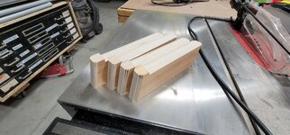

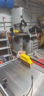

2 more pull out racks mounted
Ended up printing a chamfer version and a round over version of the push stick. Due to how 3D printing works, chamfers have a significant benefit over roundovers...but I personally seem to like roundovers better so wanted to give each a try and see what I thought
I used Prusament Pineapple Gold filament...hopefully it's bright enough to not lose them
Cutting the bottom notch on the bandsaw
Imagine pictures of screwing them together here with (2) 3/4" lath screws
And done....
Well kinda...I screwed up 1 of the wood pieces so need to remake one of the chamfer blocks. But those gives me 5 pushsticks in a garage....hopefully I can always find at least 1. Now to make some permanent homes for them at the machines

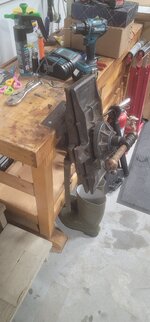

And trying to get the Emmert mounted....drilled bigger pilots...still twisted a couple screws off....but I got 2 in and called it a night...after this I'm ordering some real #14's from McMaster

I've been out for a couple of days, trying to catch up, I like that push stick idea.
Thanks! It feels a bit like the German approach of a $1000 solution to a $2 problem....but so far I like them

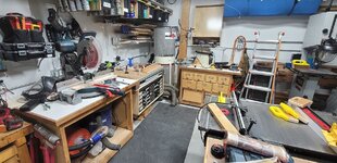

Some rearrangment in the garage...working to either remove 1 large, immobile flat surface and make it mobile...or gone entirely:
Chop saw previously spanned the semi-matching wood cabinets with a shelf between them, but I just don't cut that much big long stuff to dedicate that much space to a chop saw station right now. So going to make the miter saw station mobile....first attempt will be with the one where it's sitting now, incorporating shop vac into the base, some improved dust collection(thanks 3d printer) and some flip up wings...and of course wheels for mobility. I think the hardware cabinet with the Festool MFT on top may find a new, less mobile home....just have to figure out where that new home is. Short term I think the dust collector is going to stay in that corner, long term I want it mounted in that corner up on the wall, but for now I think functioning is a sufficient improvement....just working out how to make that most adaptable down the road.
While doing some rearranging, I did some demo, salvaged a piece of 3/4" melamine...and quickly rabbit holed into a shelf with too much effort
Found out my 18 ga nailer had jammed, so had to disassemble the nose to get that shiny nail remnant out so the hammer could work again
Looks like this after I nailed on hardwood edgebanding I jointed then cut down on the bandsaw....I tried to respect that it's just a shelf and melamine by not mitering the corners....
Intended to hold the tracksaw and jigsaw in slightly easier to access locations...knocked off the edgeband tails with the bandsaw, then quick sanding with the random orbital to smooth it out and take down the sharp corners
Tonight's contribution was a quick couple of 1/2" square-ish pieces milled down to serve as rails to help keep them in their place and not falling off the edge from an overly exuberant swing of a piece of lumber
Finish is just Danish Oil, wiped on. Couple of quick nails and this shelf should be done....then onto the next 2 I think I'll make with some of the remaining melamine...again with sapele edgebands....but it'll be an upgrade over non-edgebanded MDF!

In my small space, I came to the same conclusion about a miter station. Outside of house trim I just rarely cut angles. Maybe it's just the stuff I build. Miter stations look cool and can provide storage but if you're hurting for space they also take up a ton of room for functionality that can likely be duplicated on your table saw / band saw / track saw, so I think that's a good call.
I like the track saw shelf!

Nice work with the shop improvements! My shop isn’t big enough to keep the miter saw out, especially since it’s a slider with the bars sticking out the back. I’ve been using the cordless jigsaw to break down long materials into manageable pieces. I’m not making 8’ projects so I don’t need to run 8’ boards through the jointer/planer/tablesaw often. With a tracksaw available it’s simple enough to use that to cut down larger panels.
