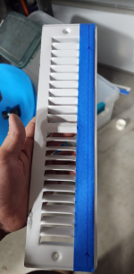

When you're "volun-told" that you're cutting down some vent/louvers for toe kicks on your wife's day job project and forget to do it until she reminds you the night before at 10:15....you get to get up early to do it
Angle grinder, M12 bandfile and some white paint and they're ready for install...well once the paint dries
And this is all of course purely hypothetical as husbands never forget anything added to their to do list
