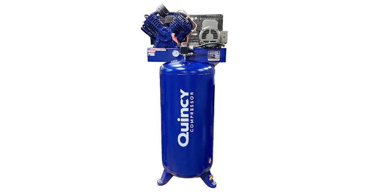

I ordered an Eaton 7.5HP 80 Gal. air compressor. This is the one here:
I have been reading thru a ton of old threads on air compressors. I am trying to do all my research now and plan ahead, I only want to do this once and do it right.
After reading, I have found my current mobile compressor (old, but in good shape) Central Pneumatic 2.5 HP, 21 Gallon compressor does not have the correct CFM for the air impact guns I will have. So in researching I thought, no big deal get one will do the job................. and this is where the overload of information comes in.
I know there are a ton of good and not so good compressors in a large range of prices. Yes, I want to do this right and I guess I am contradicting my other statement of "buy once, cry once", however I am not a professional. For current and future needs, it seems a 3.5 or a 5HP, 60 gallon vertical will fit the bill and hopefully taken care of, will outlast me.........
It looks like Quincy would be a good option and they seem to have good reviews. I understand this needs to be hardwired to work correctly and be covered under warranty. I will have my electrician take care of this when he does the building wiring, then I know it will be done correctly. There are a couple of questions in regards to this. This is not electrical code related more of ease of use and safety questions. In my County and State, I do not have to have any permits etc.
- Being hardwired does it need an emergency shut off switch?
-magnetic motor starters with overload protection? Is this for single and two stage compressors? Is there a difference? I would guess the amp rating needs to be equivalent or higher to your compressor? Kind of lost on this one?? I keep reading the switch they come with does not last or is not sufficient for constant on/off use?
I will stop at this point and see where this goes and what suggestions and comments all of you may have. Thank you.

What's your budget and which Quincy are you looking at?
In the ~$2-3k range, I think Champion probably makes the best pumps. The big pressure lube Quincy's are second to none but their QT line is underwhelming.
I am looking at this one...................It is the QT54. Underwhelming how? Not good?
The QT line tends to be noisy and run at higher RPM, and they use reed valves which aren't as good as the disk valves in the QR series.
It's still probaby more compressor than most of us need but if you're spending the money... Give me a moment I'll try to find a champion the same price.

It sounds like for my needs I am looking at the wrong compressors? Just trying to get a reliable one which will fit my needs. I guess I really only need something that will do at least 8 CFM?
EngineerNate
Oct 19, 2019
206
Bristol, TN
For some reason I thought the QT54 was pushing into the $2000+ range new.
If I were buying a new in 60 gallon, this would be at the top of my list:
In the same price range, the Saylor Beall 705 series pumps are also very very nice.

Well a cutoff wheel is about 6-7 and a DA is up to 20. So if you Divide 20 by 4 its 5hp. I would get a 5hp two stage machine because like Walkers so awesomely stated, you can't get more CFM outta a pump. You got what you got.
So I would look for a 5hp two stage on an 80 gallon tank. 60 smallest.
You can't go wrong with a GRAY or WHITE Ingersoll Rand T30. DO NOT buy a black one. The only down side is there are finger valves. A Champion R15 pump is an excellent choice. Pocket valves. Iron sleeves in Aluminum jugs. Blind cylinders tho. Also rebranded in Dayton flavor. And also note, not well known pump is the GC and GU pump from Emglo, now Jenny. All cast iron. Pocket valves.
The Saylor Beall I have to say Im not the biggest fan of. We've had a lot of them die. But for your application a 705 would be a nice unit probably trouble free.
Don't forget a dryer. I use desiccant because its not great to run a cheap non cycling refrigerated dryer with no heatload.
