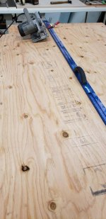

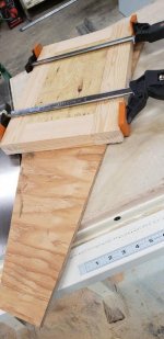

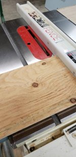

Yesterday, I spent a couple of hours and built the ramp for the duck house. I know, on one hand, pretty elaborate for its intended use. But, I wanted something fairly substantial (and not flimsy)... I figured something like a 2 x 12 would warp, split, or twist in fairly short order... a piece of plywood would de-laminate... so, frame and panel construction it is. Fairly simple, actually. It would have taken half the time if I was in my other shop (in Wyoming). My set-up here is pretty much bare-bones... but, I at least have a table saw.
This thing is fairly crude. 2x lumber for the frame... 3/4" CDX for the panel. If I'd had the use of my jointer and planer, I would've reduced the thickness of the frame material to an inch or so. But, I didn't, so I just used full thickness. I wanted the panel to be flush with the top side of the frame so I cut the rabbet from only one side of the panel... creating an offset tongue.
This was all table saw work... except i did use the circ saw to cut the frame members to length.
I adjusted blade height and fence location to cut the rabbet on the edges of the panel.
Same for the grooves in the stiles/rails. The grooves had to be offset (to match the tongue on the panel) so that the panel would be flush with the surface of the frame. I used the same basic set-up to cut the tongues on the ends of the rails. Sorry for lack of in-progress pics. I thought I was getting plenty of pics but guess I got "in the zone" and missed quite a few. I will be doing this again... I'll try to be better with the pics!
You can see the test fit of the panel into the frame joinery... and finally, the joinery detail of the panel in the clamps.
As I mentioned, the fit/finish on this piece is fairly crude... I was definitely going for fast... I'm sure it will be adequate for its intended use... lol

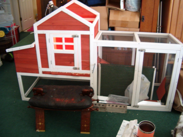

It's been a few days since I've stopped by your thread...man, there has been a lot of progress going on! The ducks sure are growing fast, too. I like your idea of using linoleum on the floor of the duck house, I'm sure that will make it a breeze to clean up. :thumbup:
Looking at your yard photos, it's definitely spring time there! I was able to give our back yard it's first mowing of the season yesterday, but the front (north facing) is still lagging behind & mostly brown.

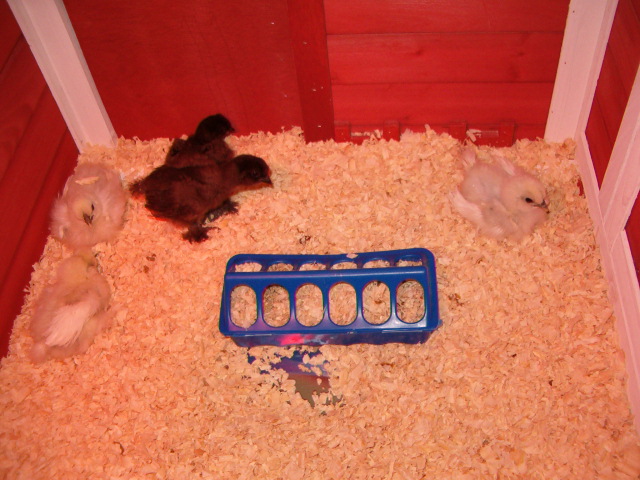

Our little baby chickens are growing fast, this past week their wing feathers are coming in pretty quickly now. They are a little under double their original size now, and SWMBO decided that the Tupperware tote was getting too crowded. So off we went to Home Depot, looking for a larger tote. On our way to the tote area, we turned down an aisle & discovered something much larger than some 'ol tote. It was even on sale for $100 off...once she laid eyes on this, there was no way I could talk her out of it! :wtf: So home it came & the 1.5 hour assembly time that the instructions alluded to, were more like 3 hours! :lol:
Please ignore the clutter, this room is a total mess right now.

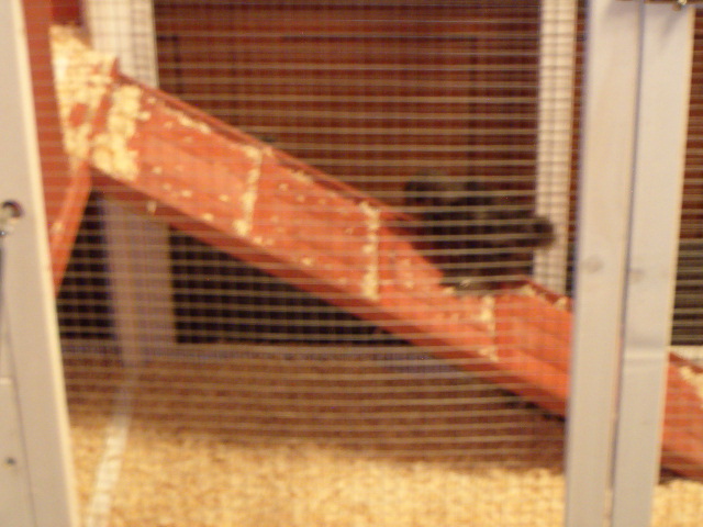

So far, the chicks are limited to the upper portion. There is a roof for it, but we're leaving it off for the time being, to make it easier for us to get to their food & water. Later on, we'll move it outside & attach the roof, and open up the lower pen area. It will ultimately be too small for adult chickens, so I'll end up building a larger one to go with it & end up with a chicken condo, or something. :)
The chicks love their new space for now. There is a metal floor pan, and once they discovered that it makes a cool noise when they peck at it, they all joined in on the new found fun, by kicking all the wood chips away & merrily pecking away at the floor. Haha!
I need to figure out a different food trough, they keep filling the current one with wood chips. We have to clean the chips out four or five times a day. Same with their water dispenser, even though we have suspended it off the floor.

Nice Chickie Condo!!! The old "some assembly required" thing gets us every time!!
Your chicks are really growing... and, they're beautiful! Will they all end up being white? Or, they're various colors? Too soon to know? ...lol. It'll be interesting to see...

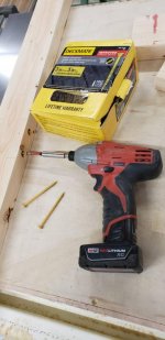

I spent much of yesterday building the entry door for the duck house. Let me begin by saying... this is NOT "fine" woodworking. It isn't intended to be. This will be a door in a 100 year old barn for a poultry area. My intention in doing this project was to try to preserve at least a little of the character of the building... while making the space functional for our needs. So, in the interest of creating a functional door that looks "farm-y"... we'll get started.
I began by cutting a couple of 2 x 4's to length. Don't remember mentioning before... I've started marking dimensional lumber by measuring directly to the edge of the square. This eliminates trying to accurately place a pencil mark on the wood, and then aligning the square to the mark. Fewer steps... less chance of making a mistake. I also use the square as a guide for my circ saw while making the cut. I can achieve near miter-saw accuracy without a miter saw... which I don't have here anyway... it's a few hundred miles away.
Then, I marked the locations to drill counter bored holes for the 3" deck screws I'll use to join the frame members.
I begin with a 1/2" diameter spade bit... drilling about an inch (or so) deep. I use the 1/2" bit to create the clearance I'll need to allow my bit extension to drive the screws deep enough to hold the joint. I drill the 1" depth so I can use 3"screws to join 3" wide lumber... saves added expense of buying (and the hassle of storing) longer screws.
I follow the 1/2" hole with a 3/16" hole (through) as clearance for the shank of the screw.
More to follow
Sent from my SM-N960U using The Garage Journal mobile app
F
fourbyford
Aug 3, 2017
913
North Idaho... almost Canada!

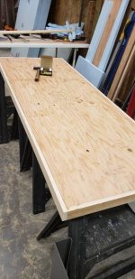

Then, it's time for some assembly. Simple **** joints, 3" deck screws (should've bought stock in this company long ago)... with a small amount of urethane glue at each joint. If you haven't tried this, it is seriously good stuff! A "C" clamp keeps the joints aligned while driving the screws.

Second side of door skinned... entire assembly "banded" with 3/4" thick pine.
1x pine pieces installed for at least a bit of a "farm" look...
Installed with "T" hinges with a barrel bolt for a latch.
This door ended up being fairly thick... 3"
If I was in my other shop, I would've planed the 2x lumber down to 1" thick and used 1" thick insulation. Then, I would've planed the 1x lumber down to 1/2" (maybe 3/8")... would've maintained the look without the thickness. But... I built this using what I have on hand and, the added insulation can't be a bad thing... we got down to 23° overnight... the duck house stayed cozy and warm. And, for what I'm doing with it, the thickness isn't really an issue.

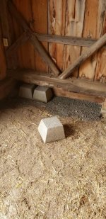

A bit of an update...

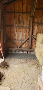

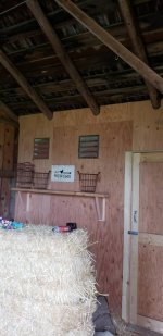

I didn't work on the dividing wall yesterday but I did work on the shelf. Ordinarily, this wouldn't have been a big deal but, when you're me, even the simplest of jobs can be complicated.
As I've mentioned before, in recent years, this part of the building was used as a dog kennel. The P.O.'s both worked long hours and had three large-ish dogs that apparently weren't fond of being confined. When this barn was built... the original owner/builder placed rocks for the log sills to rest on. On the "high side" of the building, small rocks were used... on the other side, where the ground slopes off a foot or so, larger rocks were used. This meant that the sills were "level" to within 5" - 6" over the 30'+ span of the building. Even though the sills are nowhere near level, the sill on the east end is a foot or more off the ground. When the recent owners re-sided this building, they did board and batten down as far as the log sills, then used treated plywood from the sills to ground level. Thus, there was already a fairly good slope to the floor of the building from day one. Add to that, 3 dogs trying to dig their way out of the building (below the sill on the east end) and you have the recipe for a really bad place to set up shelving. So... as with many of my projects, we begin with a shovel... lol...
I started by scrounging some fill from a couple different places around the building. Initially brought in some gravel/rock infused dirt from a recent post-hole dig... then "borrowed" a bit of gravel from the area of my (eventual) garage extension.
When I finally got a semi-level area established, I visited the pier-block repository and brought back 6 blocks. I placed them because I didn't want the compacted fill (that I was about to place) pushing outward on the plywood below the sill.
Once I established that " barrier" I brought in more gravel to create a level surface large enough to build the shelf.
Since I had a bit of scrap OSB, I decided to place some below the shelf. This part was easy and got a bit of scrap off the pile.
Shelf built. My misses will go out and fill 'er up today. Happy wife, happy life...
And, that's how to turn a 15 minute job into a 3+ hour ordeal...

A couple years back, as I set up a similar shelf in an adjacent area, I thought I should level the floor in this entire part of the building. Made the mistake of mentioning that to my misses... which was summarily dismissed an "not necessary"... fact is, I haven't had the time to even think about it... much less do it.
But, the plan is to, one day (but not any day soon) empty out this part of the building and level out the dirt floor... then bring in and compact a gravel base. Then, a layer of sand, followed by pavers. All this will be a bit of work but I'm pretty sure it's the way I'll go... as opposed to pouring concrete. A small part of this area is still used as a kennel, (and, of course, the duck house occupies a corner) but, the majority is used to store garden tools and animal feed. I think the pavers would provide a good, solid surface for foot traffic in the building and, most importantly, will allow any moisture that comes in through the "open" front of the building to quickly drain away.
Oh well... a project for another day... maybe later this fall...

Your plan for leveling the floor in there sounds good. I like the paver idea, I bet that will work great! Even if it will involve a lot of manual labor on your part. Haha! The leveled area for the shelf turned out well. I'm sure that will be much better in the long run, than just "kinda leveling" the area.

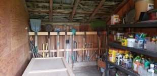

On Thursday, we made a run to the big city. Needed some groceries, had a couple of medical appointments and picked up 10 bales of straw and some bark mulch for my misses. Doesn't seem like a trip to town should be that big of a deal but, by the time we head out... take care of all the stops... drive home... unload... it takes the better part of a day.
On Friday, I arranged straw bales in the outer duck area to section off the part of that area we'd rather not have them. Then, I placed 15 bags of bark mulch for my misses to spread. After that, I installed a couple of pulls on the door of the duck house, hung a sign, hung a thermometer inside, and built and hung a shelf on the outside of the dividing wall.
Today, I fueled the mower and got it ready for my misses to use. Helped my misses with a few miscellaneous chores in her flower gardens (and she wonders why it takes me so long to get my work done) then fidgeted with the plywood for the upper area of the dividing wall. Since she got the excess things off the floor and onto the new shelf, I had access to the area we store garden tools... it had become a pretty good mess over the winter. A few minutes of effort and that problem was solved!

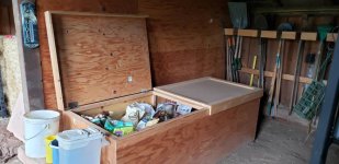

I also organized the critter feed in the feed box. When I first built that, my misses complained it was waaay too big... now, she says it's too small... lol
...D

nice work on the spaces and OMG I envy having tools spread out like that when you don't have them in a couple old oil barrels like i do.

We were definitely fortunate to find a place with a number of outbuildings... I built that storage wall a couple of years ago and it's really nice to be able to walk in and grab the tool ya need without a search. Now that we have both of the Costco shelves up and running it'll be easy to keep things organized. We got in a mess last fall as my misses brought in various things for the winter... no place to put them. Now, THAT problem is solved and we should be able to keep the whole building organized. At least I have ONE area under control... lol... still A FEW to go!!

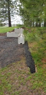

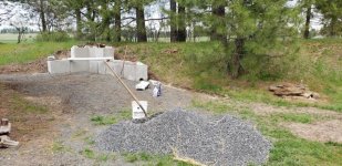

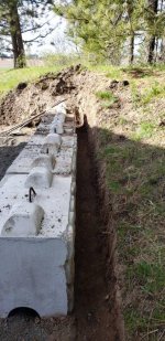

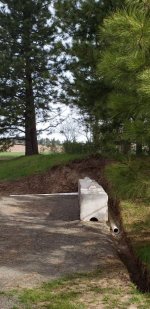

A busy couple of days around the farm. I saw my neighbor at the mailbox a couple of days ago. He said he'd be bringing the last of the landscape blocks on Tuesday. I figured I'd better get the drain lines installed while things were still somewhat accessible.
So, I spent Monday digging out the dirt behind the blocks that had already been set. When we set the first blocks, they had to go pretty much against the dirt bank to allow enough room for the 14' width of my new bay. All I needed was a shovel-width to set the drain pipe but, I had to move a lot of shovels of dirt to get there!
Toward the back corner, the dirt bank was over 5' high.
Lots of tree roots to deal with.
And, I finally got this part finished.
... more to come
