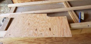

Back in the duck house today.
I finished up the framing around the vents and above the entry door. Then, I installed and stapled the insulation.
The plywood is pretty straight forward... only cuts needed are for the vents. I used the circ saw to plunge cut from the back side.
And... plywood installed... wall covered.

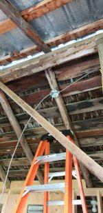

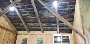

When I last worked on the wiring, I stopped working because it was getting dark and I mentioned I didn't want to be bothered with setting up lights...
Well, I woke up early yesterday to a very gray, misty-rainy morning. I was in the garage before 6 working on some "pre-assemblies" for the electrical. By 7 I was finished so I figured I might as well get going. I went out to the duck house to get started but, it was pretty dark in there so I needed a light anyways... lol. Fortunately, a flashlight set on a rung of the ladder was sufficient.
When I roughed in the wiring, I only ran the wire necessary to allow me to get the walls closed up. So, I ran some additional wire and installed an additional light in the kennel area of the building. Of course, that meant moving bales and loose straw to get my ladder positioned... it all takes time!
I got the last of the romex out of this circuit (although I still need to replace the "feed" to this j-box)... the MC cable makes for a neat and safe installation...

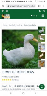

I mentioned a while back that my misses wanted geese. Well, now, that has changed. She wanted white "farm ducks". So, I ordered 4 female jumbo white Pekins from Myers Hatchery. Scheduled to ship on 4/27... should be here for her birthday! They're supposed to be prolific players and easy keepers... and, approaching the size of small geese. This should be interesting... lol

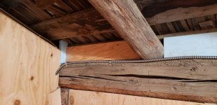

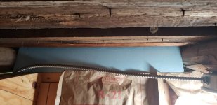

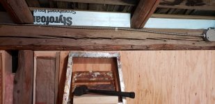

One more update... somewhat garage related... lol... and I gotta get going. Really need to make some progress on the duck house today... WE NEED IT!!! ...lol
I spent yesterday covering the upper and lower "ends" of each rafter bay (highly technical "builder's" term... lol) with plywood. That part went fairly well.
Then, I attached 2 x 3 strips to each side of each "pole rafter"... both to (hopefully) give me something fairly straight to friction fit the 2" foam insulation into and, to give me some way to attach the plywood covering. This part also went fairly well.
Then, the "fun" began... trying to cut/ fit the foam. After an hour or so, I pretty much had one piece pressed into place. I'm not thrilled with the whole thing but, it is what it is. It mostly fits and, it will be (mostly) thermally efficient. I'm most concerned with reducing the amount of heat the metal roof would radiate during the summer. I think this will do an adequate job. I have 3 more sheets to fit today. Hopefully, I'll find some sort of "rythm" and this morning wont be a total frustration. But, at the end of today, ceiling WILL be in place and I'll be nearer to completion.

Our pond filled nicely over the winter... the water is crystal clear. We sprayed cat tails last summer (and burned quite a few) and are seeing the results of that. Once the water warms up, I'll devise some way to get them out of the water. Our waste transfer station has has an area for composting yard waste. We can bring loads at no charge. I'm not sure what they might have to say when I bring in a dozen (or so) dump-trailer loads of cat tails... lol
I have been working diligently on the duck house... more to follow...
...D
20200409_163608.jpg20200410_141336.jpg20200409_114514.jpg20200410_143434.jpg20200410_141357.jpg

Then, it was time to install the last of the 2" x 3" strips on the sides of the pole rafters. Sorry for no pic, but this job was largely uneventful.
Finally, it was time to install the last of the 2" insulation...
A couple days ago, I mentioned the frustration I was experiencing while trying to fit these panels. My original idea was to do each panel as a single sheet. Two problems... first, the "bay" I was trying to fit the panel into had a distinctive "hour glass" shape. Hard enough to measure, much less trying to cut that shape into 2" thick foam that really doesn't like being cut. Second, once I had the panel essentially "cut", I realized it was too long to fit past the beam at the top of the wall. So, I used my utility knife to cut the panel (pretty much) in half. That allowed me to fit the lower half, followed by the upper half. Sounds easy when I say it but, a bit of trimming and fussing was involved.
So, for the second (and subsequent) panel(s), I started by cutting the foam to a "rough" width and then cut them in half with the circ saw. Much cleaner/nicer cut. So, what this meant was i could concentrate on fitting just the lower half of each panel... odd ball cuts were easier because i was only dealing with half of the length. For some reason, it seemed that the lower half of each panel required the most fussing... the uppers were comparatively easy.
All in all, the job went reasonably well. The seams in the middle of each bay fit tightly enough that I'm not worried about air infiltration. By the time i got to the last panel, I was fitting it like a pro...
A couple days ago, I mentioned hoping I could find a "rythm"... never did... but, I did find my way through!
On to other things!
...D

So... the last job for yesterday was to install lino on the floor of the duck house. This is less about creating the "Duck-Hilton" and all about creating a surface that's waterproof and easy to clean.
No in-progress pics because I was feverishly working... trying to finish before dark.
I started by cutting a full-sized paper template of the floor. I figured this would be the best/easiest/ fastest way to get things to fit. Trying to measure all of the irregularities would have been an absolute nightmare!
Then, I rolled the lino out on our front deck and taped the template to it. Used my framing square for a straight edge and cut out the shape with my utility knife.
When I placed the lino on the floor for a dry-fit, no trimming required!
Then, I just pulled the lino back, half way, and trowled the adhesive onto the floor. Step and repeat. All in all, a fairly easy job. And, my knees aren't even killing me today!
Today, I'll build the entry door and the ramp to the back area.
Getting close!
...D
