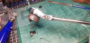

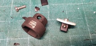

I made my own steel wrench socket holders out of ratchet drive adapters and/or the guts from unneeded round head ratchets I had lying around. I use them all the time and they work great.

^^^ Actually I was inspired by you first and then made my own one. Many thanks. :thumbup:
The cheap "impact" u-joints from Harbor Freight are good for making these.
That tool you made looks near perfect. I bet I have an old universal adapter set in the garage from a generic brand I can chop up, they would be chrome ones though.
I believe this greatly shifts my choice of 1/2 drive low profiles to Astro vs the Capri version, as it solidifies the alternate use with a regular wrench retaining solution.
EDIT: I checked my universal joints with my ratcheting wrenches and Astro sockets. There is a lot of slop, it does not seem to hold tight like your pictures provide. Oh well. I see it might be due to the design of the 3/8 potion as it mates with the joint itself. Your picture seems to show it being really flat, where the joint has a curved portion. Might require some grinding/cutting on the top side as well.
My apologies, I should have mentioned that I use an o-ring to take up the slack. I left it out because I wasn't sure if the spacing of others' tools would be the same as my own. I keep the o-ring on my 19mm socket so I don't have to hunt for it when I need it.
The nice thing about the impact adapters is not having to deal with chrome slivers and being able to match the finish with a little cold blue after you're done grinding it flat.
