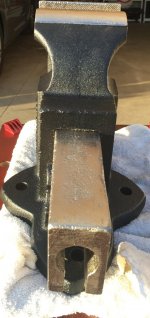

gman007
May 17, 2017
2,802
West Michigan
Re: BEFORE & AFTER....A Tool Polisher's Haven
Honestly, I don't think the critter you're looking for exists. Short of chrome plating, everything you can coat metals with is a compromise. You gain protection at the cost of the finish. For mirrored metal I have been on a turtle wax kick as of late, since it's cheap. But with bare metal castings, a baked on BLO or a clear coat is about the best you can get to my knowledge.
How about Nickel plating? Granted not as shinning as Chrome but still pretty good. It will not tarnish and will prevent any rust (the whole vise was first nickel plated and then appropriate parts were powder coated bright Red)
