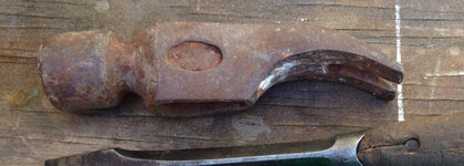

Not a huge project, but I polished and re handled this old hammer I got at a garage sale today. I think it's an old Hart or a Deluge.

TOOL POLISHER"S TIP #317.....
Whenever you're cleaning the rust from small letters or logos....
Take a #2 lead pencil and rub it all over the letters/logos....
Work it in all the nooks and crannies....rub it til it runs into wood...re-sharpen and keep going....
Take and brush the lead (graphite) off with a wire brush or wheel.....then you're ready to clean the rest of the tool.....
Lookin' Good.....:thumbup:
BONUS TIP: If you still have signs of dirt or rust (like inside letters "R" "O" "A" etc...) take a straight pick or dental pick and scratch it around on the stubborn letters , then repeat the pencil trick.....
