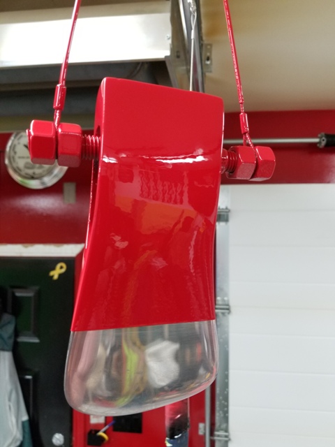

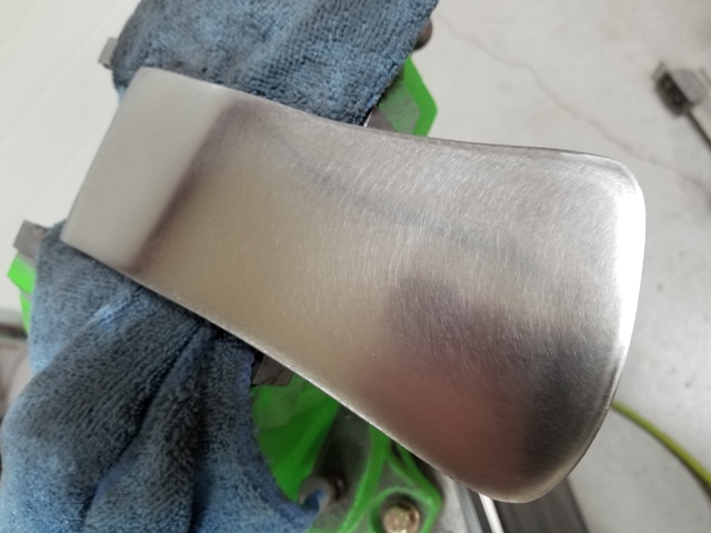

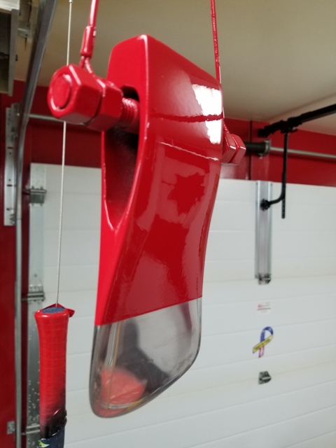

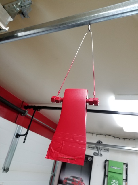

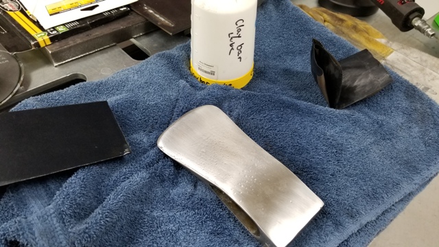

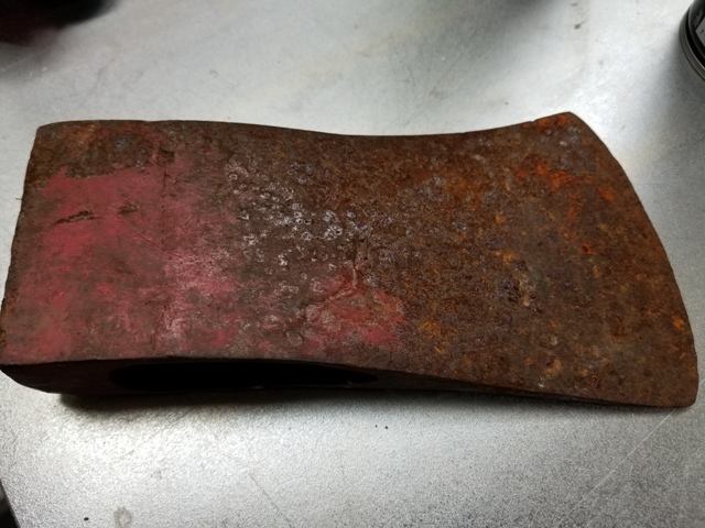

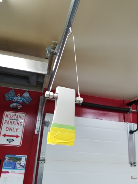

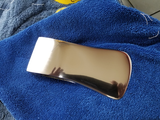

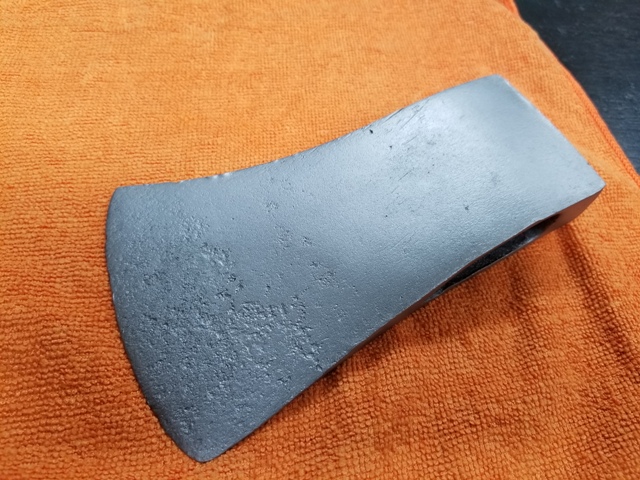

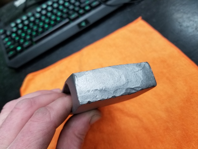

This was my Grandfathers old axe, My Dad found it in a shed at my Grandparents lake lot that my Mom inherited... He asked me if I could clean it up a bit, he wants to hang it over the fireplace there...
Challenge accepted with honor!!
Bead blasted to see what we are working with,
Can you tell Gramps was a farmer and not a woodsman,
I decided to leave all those hammer marks in the back and just clean up the blade for show,

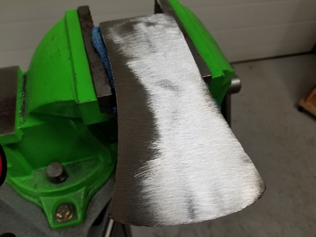

Started with 24 grit on the air grinder,
Then worked up to 600 grit on an random orbital,
Switched to wet sanding by hand for 1000, 15000, and 2000 grit,
Then a quick polish,
Taped off the tip, and bead blasted the rest of it again, then primed,
Base coat,
Cleared!!
