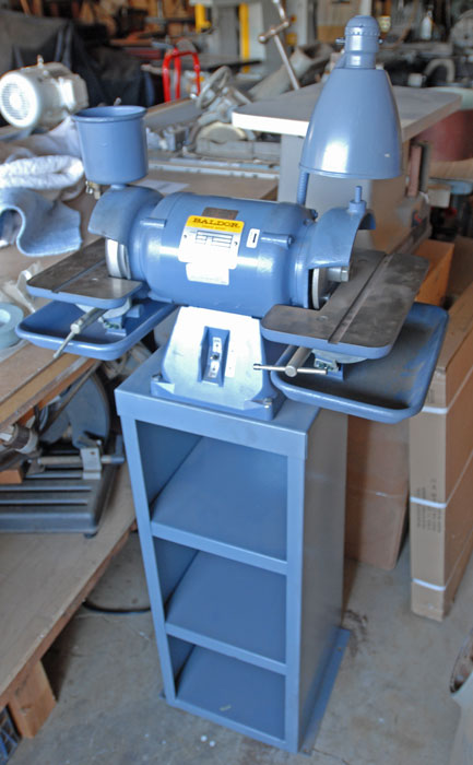

Any thoughts on this one (USA made Black and Decker):
https://easttexas.craigslist.org/tls/d/kilgore-5-bench-grinder-black-decker/6813183956.html
exmaxima1
Jun 25, 2011
6,348
Midwest
MattT
Feb 20, 2010
3,201
For a used one, budget is $225 or less. I was considering this one:
https://dallas.craigslist.org/dal/tls/d/garland-baldor-673e-grinder-buffer-usa/6803775320.html
But it was made in June 1979 (according to Baldor). I can't see paying that much for a 40 year old grinder. Am I off in thinking this way?
Don't let the age scare you but that price is too high for a 6" 1/3 HP machine IMO.
The Black & Decker you linked falls in the better than no grinder category. I guess you could get it as a stop gap to buy you some time to find a good machine at a good price.

exmaxima1 Thanks for confirming, agreed. I'm pretty close to just getting a Delta for $99 since I need one pretty soon but have been holding out to see if I can find a good US made one.
Here's what I've boiled it down to.
Can pick up now:
https://www.lowes.com/pd/DELTA-Delta-6-in-Bench-Grinder/50150070
The amperage on that Delta grinder is only 2.5 amps, so it is a very weak grinder. I would think it would quickly bog down if you sharpen mower blades with it. Not worth it.

exmaxima1 - good to know, guess I'll order the Baldor if I don't find something used soon.
The baldor you linked isnt much better. I would wait to find something bigger. I have a small grinder and it is more frustrating than useful. Besides, as noted above, an angle grinder and a vise is probably easier and faster for mower blades

I think Baldor is just discontinuing their smaller benchtop grinders. The most recent catalog from a few months ago makes no mention of 6" grinders, but still lists 7" and up.

For mower blades, use a 4.5" rt angle grinder and an 80 grit flap wheel.
I have an old HF 8" bench grinder that's ~3 amps; it's not powerful enough - so go much higher on amps.
