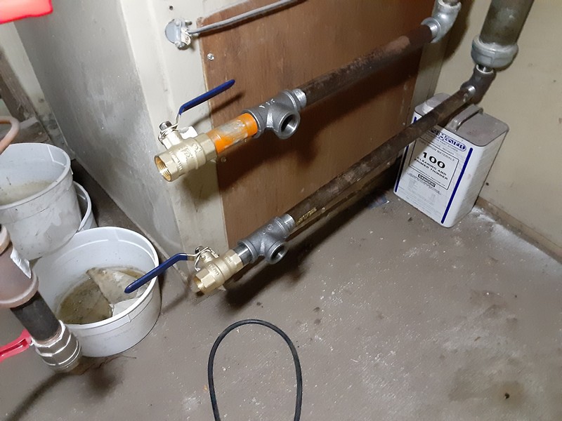

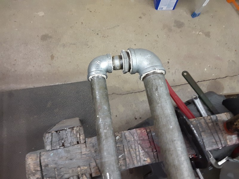

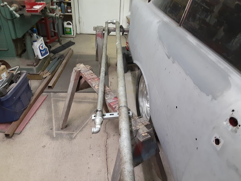

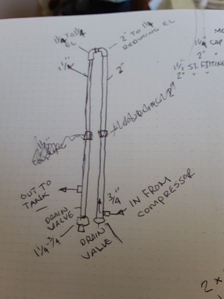

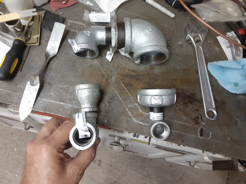

This is a rough concept sketch I did for my cooler.
Both pieces of pipe are 8' long. They stand vertically in my compressor room and run up into the ceiling.
These pics were taken as I was building the manifold.
I used 3/4" braided hose to connect the manifold to the compressor outlet and the tank inlet. The outlet from the compressor runs at about 230 degrees when it is charging. Running the charge air into this manifold cuts the temp at the outlet to about 100 degrees at the tank... :)
Mark
