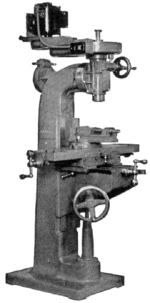

If you want a better used small mill, look for a Millrite Mill (picture below) . 2/3 scale version of a Bridgeport with three different table widths. Built like a tank and very stiff (higher stiffness = less chatter).
Careful. The Millrite came with either a rapid down feed, or a fine down feed. Not like a BP where you have both. The rapid down feed makes a decent drilling machine, but the fine feed would not be at all suitable for much drilling. The one you pictured has the fine feed.
Source: I've owned 3 Millrites.

^^ they are rare as hens teeth, or I would recommend a Millrite also.
I have the fine feed.. certainly wouldn't let it keep me from buying one.

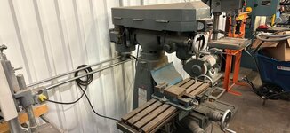

Interesting mills. I am not sure I have seen two exactly alike. Different resellers offered different variations, such as Bijur copy lubrication pumps, metric vs. English leadscrews and dials, etc.in general, Taiwanese electric motors are hard starting. On a 120v 15a circuit, these motor will trip the breaker on startup occasionally.

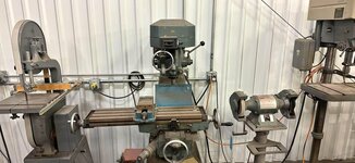

Maybe also expand your search to include off-brand quality stuff too. For instance, Wells-Index. Built as good or better than a bridgeport, and cheaper usually because people don't know them. There were a ton of them out there too, they got sold to the Army/Navy.
Wells Index (aka Index in the earlier years) makes great mills. My friend has an Index model 40H which is a dead simple small vertical mill that works great. He loves it. Not that common though.
