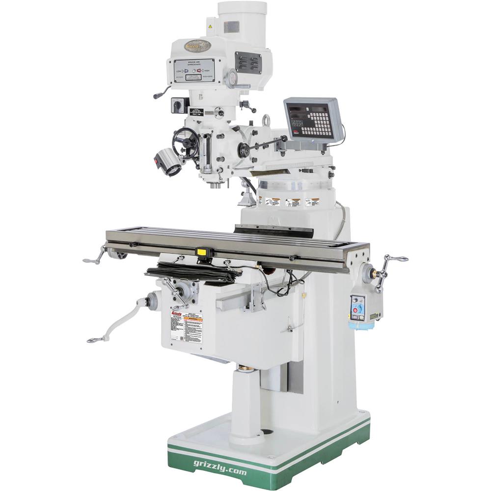

I'd go with the Enco out of all of those. I had the Grizzly equivalent for 6 years and really liked it. Work envelope is pretty small, especially once you add up the vise, work, chuck and cutter, but it's rigid enough to do some decent work in steel within that envelope. Not sure if I would buy one if I really needed a drill press though as it's work envelope is similar to a cheap benchtop drill press. Buy a nice floor standing drill press first, then see if you need a mill.
Well, I already have a drill press for the house garage, so I have access to one if I need it. Also, the nicer drill presses around here seem to cost about as much as a mill, so makes more sense to me to get a mill.

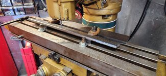

I just used my current main squeeze today to mill a chamfer on a piece of cold rolled bar. 24" continuous cut. Couldn't have done that on the little MV you linked but it sure was compact.

I would go with the Meehanite, Supermill or Exactor (BP "style" Mills). All should have have roughly the same footprint, 9x49" table. I think BP did do a 36" table, but stay away from the round ram that you pictured.

The Exacto in Dallas or the Houston Meenhite are both Bridgeport clones and should be far better machines than the Enco. Lot of parts are interchangeable between brands on those. If you find one with a variable speed head instead of pulley swaps that's even better.
Once you find one... A DRO, power drawbar and some tooling will get you setup and good to go
