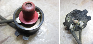

A Cautionary Tale
Well, I went and did it now...while deciding to give my paint job a couple of days to cure before fooling with it, I decided to turn my attention to the motor and other fine details like cleaning up tags.
My press ID badge from the base, the motor tag, the reset button tag, the on/off switch tag all had scuffing issues as well as grime build up. In addition the motor bearing covers on mine were originally painted and they were pretty grubby too.
So I decided I'd give them all a quick spritz in a cleaner/degreaser I've had good luck with in the past. A product called "LA's Totally Awesome". BAD idea...within seconds after tossing them all in a small bowl...and I do mean seconds, it had already started melting all the paint and printing off of everything. I was lucky that I didn't toss the Craftsman badge from the head in too. Everything else is pretty much trashed or might as well be.
Moral of the Story -- DO NOT use "LA's Totally Awesome" to clean grease and grime off of your Craftsman tools or badge tags. It will eat the paint off of everything in rapid order. Ordinarily, I have found it to be a great product, but hard lesson learned to not use it on these Craftsman machines.
Now for the Bright Side of the Story
I have discovered there is another member (MATTBLAST) of the Garage Journal forums here that has successfully been able to recreate water transfer decals for vintage machines. Particularly 60s-70s Craftsman grinders and such. He has recreated the artwork required for many items and then presumably sells copies for a nominal fee. As I understand it, he creates the artwork from scratch, or has to have someone submit artwork to him so I don't know if he has any of these already or not.
I used to work professionally as a graphic designer, and have already recreated the motor badge, on/off switch lettering, and am almost done with the machine ID badge mounted on the base. With this artwork in hand, I plan on reaching out to him to see if he can print this stuff on these decal transfers so I can replace mine.
After I get this all finalized, I plan on turning all my artwork over to MATTBLAST so he can produce copies for anyone who cares to get them.
Attached is a copy of the motor plate that I put together. It's not perfect, but close enough I don't think anyone would know the difference unless they knew what they were looking for.

Klixon Motor Thermal Switches
Many small fractional motors come equipped with a thermal switch. The purpose of a thermal switch is to open run circuit if the motor gets overloaded and overheats.
Many Craftsman motors have a manual-reset switch. If the motor overheats and trips the switch, the red button must be pushed after the motor cools.
Some other motors have an automatic switch that resets itself after the motor cools. Below is an example from a Dayton motor.
Below is a C77 thermal switch from a Craftsman 115.6962, 1/2 hp, 1750 rpm motor.
The switch is a rather simple device. The housing has two wire leads on the back. Inside the housing is bare solid wire loop and two contacts. The reset button is connected to a bimetal snap disk with two contacts.
The snap disk and the metal piece above it have a notch that rides over a ridge inside the housing. This keeps the contacts and reset button aligned.
The snap disk is a piece of concave/convex bimetal. The bimetal disk is made up of two layers of metal with dissimilar
expansion/contraction properties. When that bare metal loop inside the housing heats up during overload, the snap disk flexes and opens the run circuit.
Below is a youtube video of how the snap disk works with a heat gun.
IMPORTANT:
The thermal switch above was fubar. Because I like to know how things work, I dismantled it with no expectations to reassemble. The reset button is threaded into the housing at a specific depth tolerance. The small nut is a lock nut to prevent any adjustments. The thermal switch is not a serviceable item.
