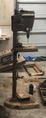

Things get weird sometimes. I justed picked up...finally...a little 80. At least I think it is. 103.23590 is on the band.
Looking forward to restoration....someone painted it black! NO!!!

Here is the motor that came with my new-old ~1965 DP.
The decal has the same crown as the DP.
I have no idea how to date code it.
