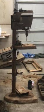

The table was tougher. The base came right off after the third attempt with the 12lb convincer. Long C Craftsman motor plate is stamped J3 46.
What do you think? Looks like pre 1950 to me. See anything else to date it earlier, to 1946?
Yes, definitely pre-1950, so technically, it's a 100. Referring to it as an 80 is probably more appropriate and clear.

I blame you guys for my recent purchase! :) Wednesday, I picked up a running 100 series for $100 that seems to be in pretty good shape. I have been doing a bit of research on here, but I believe this is what I have:
Base tag is 103.23130 = Craftsman 100 from 1948-1955
Slotted head screw = pre 1951
Motor model 115 6960, date D1 48 = 1948
3rd set of pulleys for speed reduction.
Unique things so far:
Extra toggle switch on base (front n center)
Extra hole(s) about 1" from slotted screw on both sides
Missing so far:
Depth gage/feed stop parts
Thumb screw to retain chrome handle (return spring)
Collar on chuck
Set screws for other handles?
For now, I just plan to get it cleaned up and fix/replace what needs done and maybe later on I can tear it down and do a thorough rebuild.

Welcome to the club! Very nice! Especially with the MSA!
I appreciate your research and agree with your findings.
I suspect a previous owner installed a homemade belt cover and the missing thrust nut and feed stop assembly suggests that a mortising attachment was used at one time. The missing parts frequently show up on ebay.
That's an interesting custom switch set-up. I've never seen that before.

Good afternoon - well, this DP popped up in my area [the other one I was looking at fell through].
Can anyone help me with identifying it? Ask is $100 [seems heavy]. I am inspired to restore to almost new.

Dunlap was the offshoot (cheaper) version of Craftsman. Depending on what year, it could be almost identical, or could use bushings instead of bearings. Looks to be the same size as a CM 80
The first post of this thread is the TOC. There is a link to a Spotter's Guide you can use to determine which machine that is. Another link, Evolution, has more info.
What do you think price wise? $40?
The condition is the big obvious issue. It's very rusty, it's been repainted and the quill fully extended means there is an issue with the spring; either non-tensioned, best case, or broken, worst case.
Prices vary by region. Please update your profile with your geographical location.
If the motor is Craftsman or Dunlap and runs, I think $40 would be the high for me.

Nice job walking away. Especially in Arizona, rust??? I bet theres some gorgeous hidden gems preserved from that dry weather of yours.
Smokeshow69
8,421
Agreed! On rough units like that...if you buy it, buy it assuming a part out and then you wont get hosed on the value. Like Franklee said earlier, that may possibly have the bronze bushing bearings which are the less desirable.
