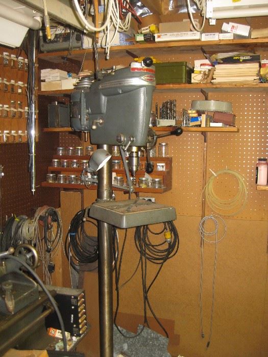

I brought home #27 today; a 13-1/2" Craftsman 80, model 103.23640.
It's got a few issues. No motor, a worn motor pulley which may be repairable, a bad non-original Supreme chuck, and loose motor mount rods.
Overall, it's in good condition; nice table, engine-turned head frame trim in excellent condition, minimal rust.
2/17/2017
I discovered a few more minor issues with the 80:
  • the small step on the motor pulley is mushroomed inward presumably from rubbing on the motor housing
  • the pulley also has a 3/4" bore and is not an original Craftsman, so no big loss there. I have another three step cone pulley which will work fine.
  • the original spindle washer was replaced with a hose washer... wtf?
    Because the hose washer is thinner than the original spindle washer, the spindle was loose in the quill bearings, so no preload. Luckily, no apparent damage.
  • I mentioned above that the replacement Supreme chuck is fubar. Also, there is no threaded spindle collar to remove the chuck, but I was able to remove it using a slide-hammer puller. I have a spare chuck and a threaded collar.

That's the same DP I have. Looks pretty good. What is that collar on the post above the table?

I sure you will have it fixed up in no time!!
39,107
Nice find Frank!
That brass collar is a head stop so you can set it for when you want to lower it and not drop it... Usually reserved for much bigger machines with no lift mechanism.

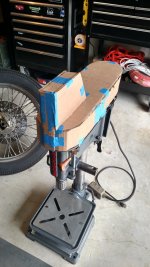

Well fabrication of a replica cover has begun. Mock up complete. This is all been done off just pictures I found on the inter-web. I didn't have measurements to work off so it's a best guess.

Wow, that's an ambitious project! will you go with wood or metal? Hmmm, Maybe plastic/Lexan would be fun...
I like a challenge or is it i Iike too making things rough on myself? Lol
I'll be using 22 gauge sheet metal. Not to thick to make it hard to work with and not to thin that it's flimsy.
The clear lexan actually would have been cool idea. Be able to see it all in action when it's on.. hmmmmm maybe I'll make two lids lol...

I just bought one of those today. Send me a PM if you want any measurements or photos of the top.
