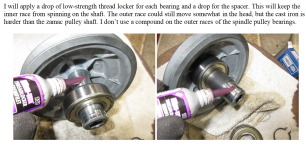

Knock out the head lock cylinders. First, use a long 1/2-13 bolt to knock out the threaded cylinder from the left side. Then punch out the left cylinder from the right side. The head may then move or free-up easier.
3. Should I replace the bearings while I have everything apart?
Your machine was manufactured sometime between 1962 and 1966. It's at least 60 years old. IMO, it's time to replace the bearings... especially due to the overall condition of the machine.
I have pullers/presses etc. and I see bearing kits on eBay. However they seem to be no-name bearings and I am not 100% sure if there are a bunch of subtlety different Craftsman models to beware of. Any gotchas, or known good options from a real bearing company like SKF/NSK/etc.?
The spindle pulley bearings are 6205; 25mm bore x 52mm OD x 15mm wide. I only use shielded bearings for the spindle pulley.
The quill/spindle bearings are 6202-5/8; 5/8" bore x 35mm OD x 11mm wide. I only use sealed bearings for the quill/spindle.
There are many sources for bearings. I buy bearings from www.JSBGreatBearings.com. Most of their stock is from PRC, but I've never had any issues with their house brand. They do have Nachi, SKF and others in some sizes.

[Trying to resist spending faaaaar too much money on ABEC5 bearings for the top of a drill press where they will be completely and utterly wasted..... 💰]
Below is why I use shielded bearings for the spindle pulley. (I don't buy from Accurate Bearing any longer.)
Overkill? Maybe.
