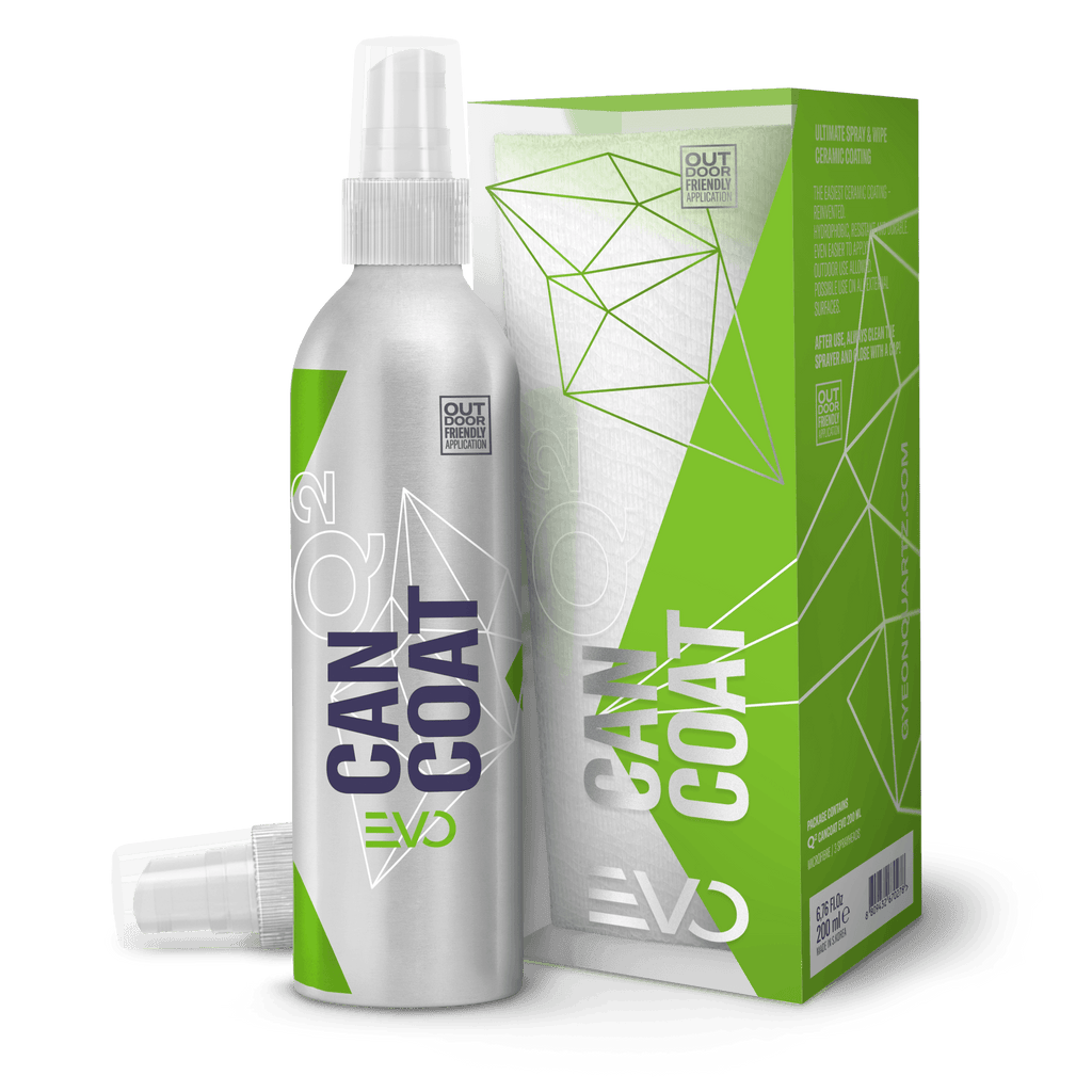

I've documented applying Can Coat EVO before, and for the most part it goes down pretty easy. Working panel to panel, 2 to 3 sprays are added to a towel or microfiber applicator, more than that and you are wasting product. It's then worked over the panel, then buffed off with a separate towel. I actually use third towel for a final wipe. For the Mustang, I applied Can Coat EVO to the paint and black plastic trims. After an hour, I followed with Gyeon Cure.

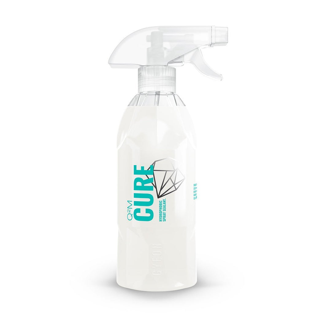

Cure is typically used to protect the coating from moisture and contaminants while it fully cures over following 14 days. Considering the car will sit in the garage indefinity, I could have skipped this step. But then the lack of slickness from Can Coat means using Cure addresses that.

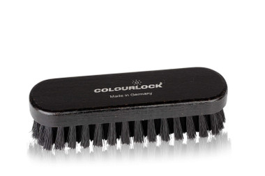

You are on the right track with the leather care.

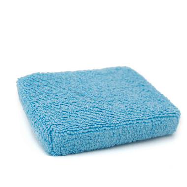

Pol Star is awesome, fantastic cleaning power but pH neutral so its relatively safe. I always wince at how some douse their interiors in alkaline APC and then wonder why things are starting to go white or discolored. I have Pol Star at a pretty potent 6:1 dilution, but you would get by with 10:1. Make sure you have a spray bottle to dilute it into, the Carpro Dilute makes it easy to get your dilutions accurate without having to make calculations (also linked below). If you want something RTU, then grab a bottle of P&S Xpress, its also pH neutral and just as effective. I like how both lather up nicely, which helps when wiping away the product/dirt emulsion.

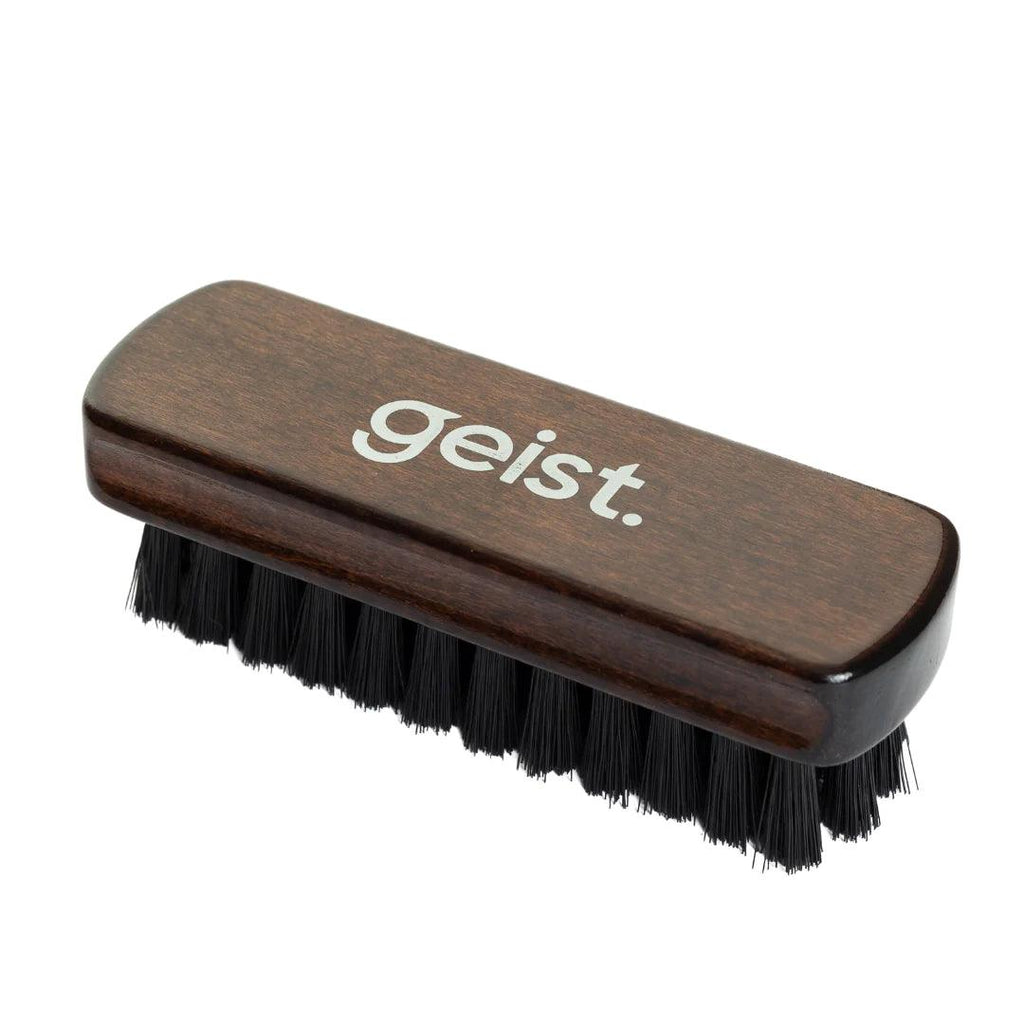

For a leather cleaning brush, I think the ColourLock or Geist brushes are the ones you want, they are stiffer than you would expect but they were designed by leather cleaning experts. The alternative would be the VLB brush from The Rag Company.
ColourLock Brush -
VLB -

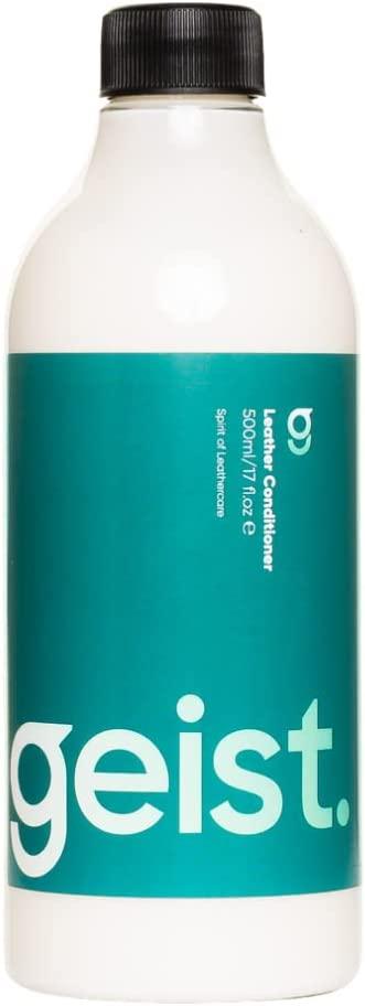

For a leather conditioner, the Geist version is a great option and seems to offer a little more hydration for older or "dry" leather. Don't rule out ColourLock Leather Protector either, I tend to prefer it. Remember....................clean and protected leather should always be matte and dry to touch, never slick, shiny or greasy. I'm pretty **** with that. I'd apply either product with a microfiber applicator, they work better than the foam sponges sold by either.

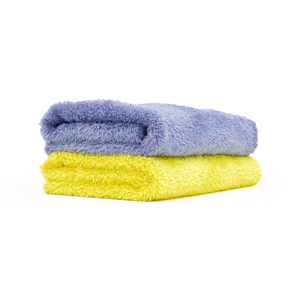

You'd probably need a good supply of towels, you will be surprised how many you burn through dealing with dirty leather. I like the TRC Car Wash Towels, but they only come in packs of 25 now, so the Edgeless 365 would be a good option.

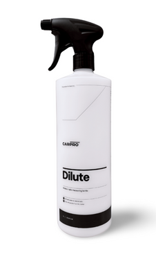

As for APC dilutions on engine bays, I'd start at 10:1.........................but that depends on the product, so always follow the directions, again I've seen people turn their engine bays white because they used straight APC instead of diluting it. I favor Koch Chemie Green Star.
