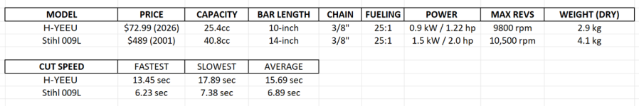

Comparison with the Competition -
My first look at the H-YEEU immediately brought ECHO to mind — specifically the CS-2511 TES and CS-280 TES. In my opinion, ECHO make the best petrol-powered top handle saws on the market, so at least H-YEEU had the good sense to clone the right ones.
https://www.echo-australia.com.au/en_au/products/chain-saws/top-handle-chain-saw/cs-280tes_37
Other high-end sub-30cc top handles worth mentioning are the Stihl MS 151 TC-E and the Husqvarna T525.
https://www.stihl.com.au/en/p/chainsaws-ms-151-tc-e-petrol-chainsaw-102617#ms-151-tc-e-102617
https://www.husqvarna.com/au/chainsaws/t525/
I'll acknowledge that this Amazon saw probably isn't in direct competition with saws from Stihl, Husqvarna, or ECHO. Anyone considering a sub-$100 chainsaw is unlikely to be weighing it against something seven times the price. But these clones are clearly influenced by what the established players are building, and being a spreadsheet guy, I thought it would be interesting to see exactly how the H-YEEU stacks up on paper.
I included not only the ECHO, Stihl, and Husqvarna benchmarks, but also the battery-powered Stihl MS 140C from my own collection, plus another contender I'll cover shortly. The pattern is clear enough — the higher quality tools deliver more power, higher revs, and less weight. The Amazon saw's 25:1 mix requirement is worth noting too; either it's playing it safe for occasional users, or the engine quality is poor enough that it needs the extra oil just to survive the warranty period. The battery Stihl is interesting because its electric motor produces the same power output as the 25.4cc H-YEEU — which says something about both.
(Prices are in AUD)
This H-YEEU is the same saw rebranded and sold under countless names at wildly varying prices — Huyosen, Aowei, GTP, Patelo, Vevor, Temu, to name a few — ranging from $115 to $180. You'd be pretty annoyed discovering you paid $180 for a $72 chainsaw.
Bunnings are in on it too. The exact same saw is sold there under the Cheetah name — a product Victa supplies to Bunnings to hit a price point without putting the Victa badge on something like this. Granted, you get a 12-inch bar, but is otherwise identical. So how much does Bunnings charge for a $72 chainsaw? $155. How does the jingle go, "lowest prices are just the beginning" — well, clearly not in this case. It also tells you just how much margin is baked into this stuff when Amazon can sell the same saw for less than half of what Bunnings does.
One more discovery after working through the owner's manual — the chain is supposed to be Oregon, which is probably the best component on the saw. The manual also recommends 10W-30 motor oil for bar lubrication, which in my view is too thin; it won't stay on the chain at full speed. For reference, the LD-M7 spark plug crosses with an NGK BPM7A or Champion CJ8.
Coming up next — what entry-level saw would I actually recommend? It might not be what you're expecting.
