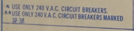

Does this chart indicate that he maximum breaker allowed is a 30 amp?
Cruzan80
Jul 22, 2015
4,493
Denver, CO
Isn't this the same panel that you want to run a new circuit for your compressor on? You said you already have a 50A circuit on there ...
I don't see any place on there listing a 30A limit.

Just to the right of the main breaker on the diagramn, it says
"Do not install greater than a max of 200 amp connected load per tab"
:dunno:
I thought that could have meant the entire side could not have totaled 200amps if the breakers were added.
That "per tab" bit means that each tab cannot exceed 200A. If it meant that "the entire side" couldn't exceed 200A, it would say something like "per bus". But it doesn't.

nope it says STAB, meaning where the breakers connect, not the entire bus.
You're right.
But the rating of the panel is limited to 200 amps as well. (0r 225) This panel can't be fed with 400 amps and pull 200 on (2) stabs on the same leg. But I get it, that's not what I
Edit: deleted a statement that I realized wasn’t accurate
JohnX14
Jun 2, 2014
693
Boston 'burbs
There are lug kits that I’ve used on Eaton BR load centers that allow me to pull 200 amps to a subpanel. So yes I agree it’s 200 per stab.
