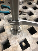

Got a reasonable quote on sandblasting the table, got my painter all lined up, now I just have to find a shop with a competitive quote to grind in the top. Turns out some places just won't deal with cast iron due to the mess it makes when you machine it.
The machine shop across the road will put it on one of their big HMCs and deck it off for me, but I'd really prefer to have it ground on a blanchard. Plus the cost of machining vs grinding can be a bit prohibitive. Plus side to machining is I wouldn't have to do any trucking, I could just drive it over on the fork truck.
I now have the question of sequence. I know I will sandblast first, but then I don't know if I want to have the machining done with the bare cast iron then paint, or if I should paint it and mask off the top after the grinding.
I'm leaning toward blast, paint, then machine. That way the top surface doesn't need to get masked off, I'd have minimal exposure for rust, and I can be a little more liberal with my paint application knowing I was going to grind off the top. The downside is my paint job could get messed up when handling and fixturing on the machine. Plus I'd have to wait a week or so for the paint to fully cure.
Hmm. Decisions.

You lucky dog! Great table and you are going to love welding on it.
I had mine Blanchard ground, but my top had gouges, yours looks in good shape.
I then wire brushed ,and sprayed painted the sides. Didn’t do anything to the surface rust on the bottom.
Also, if you are going to build another frame, consider building a couple of slide out shallow shelves, makes it easy to clean up, and catches small parts that drop through de5e32ff0441e01e3efd44cb9c7e8e6d.jpg

Bellaireroad, I was intending to just make clamps like you did, but I just got off the phone with my welding supply salesman. Turns out Stronghand sells a complete clamp for the acorn table for like, $60. I can't really make them for that. I'll probably buy a dozen of those and call it good.

I wonder if you can make the build pro inserta clamps work, they are about half the price in amazon.
I'd have to machine a bushing, as they are meant for 5/8" holes. At that point I'd rather just buy the clamp designed for the 1-3/4" holes and save the machining.
