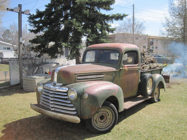

Me Too! This is my truck:
You look like a good candidate for one of those air flange/punch tools if you're drilling for spot weld holes. Talk about a timesaver.
I have one, the drill is about the same actually...

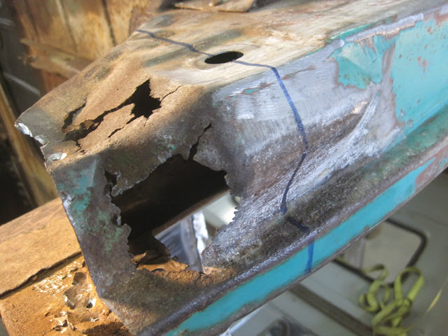

Oh, you'd be amazed how bad it was. I fabricated most of the lower cowl and sills.....Here's the thread:http://www.garagejournal.com/forum/showthread.php?t=50692

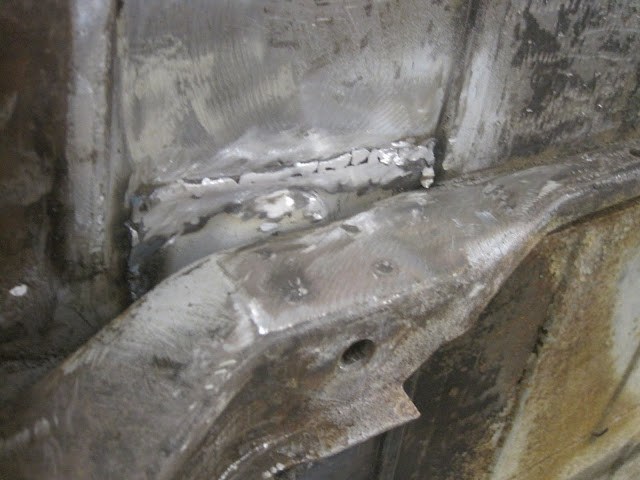

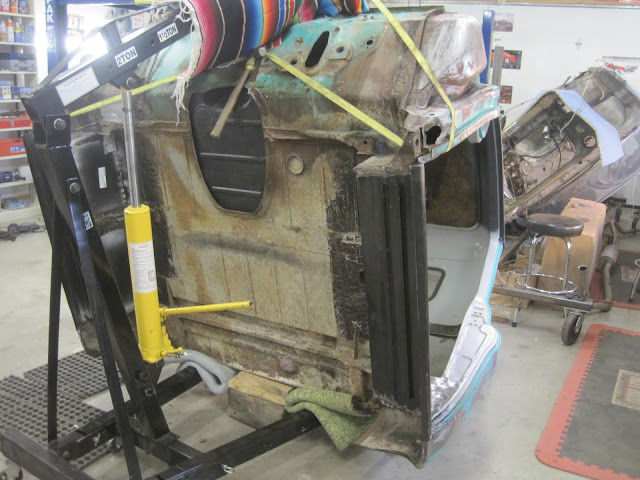

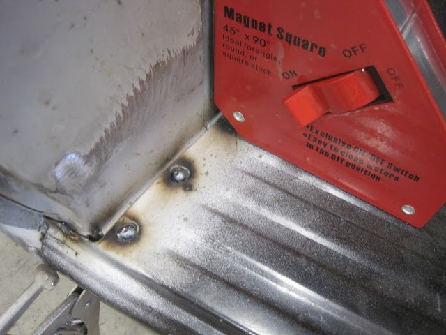

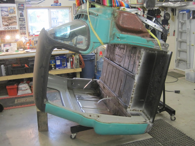

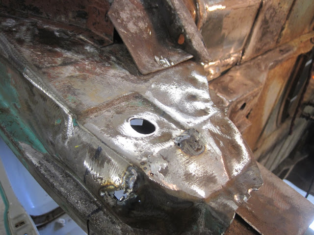

OK, onward and UPSIDE-DOWNwards!
Put it up on it's back to work on the lower hinge posts:

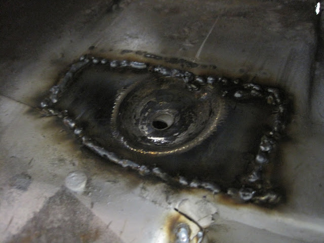

Welded up the cab mount area I fabbed up last week.

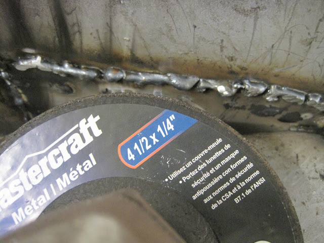

Someone asked what I dress my welds with. I start with a grinding wheel to concentrate on the proud weld, then finsih with a 24 or 36 grit flexible disc.

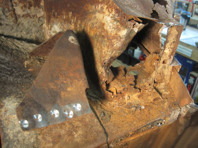

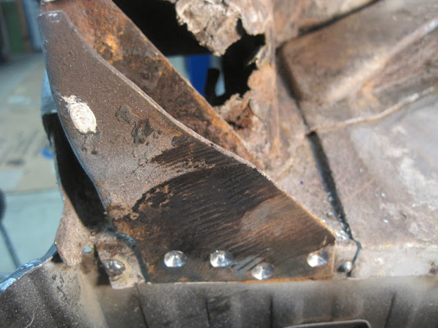

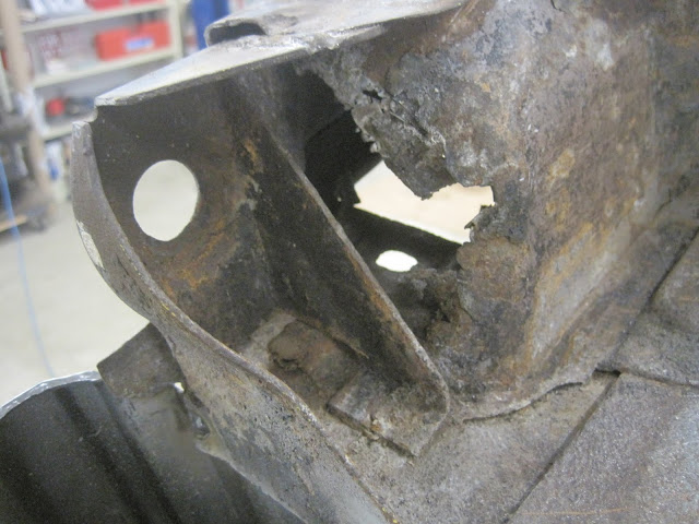

The lower cowl and hinge post gathered up a lot of dirt over the years - leading to rust out:

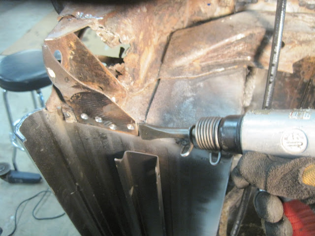

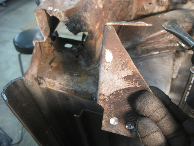

To get at it I had to remove these lower braces:
Time for a lot of clean up!
I'm thinking I'll cut them off here and fab up new pieces. I like to cut at bolt (or other) holes so as to have an exact replication point:
Frame (and these other parts) went out for sandblasting today too:

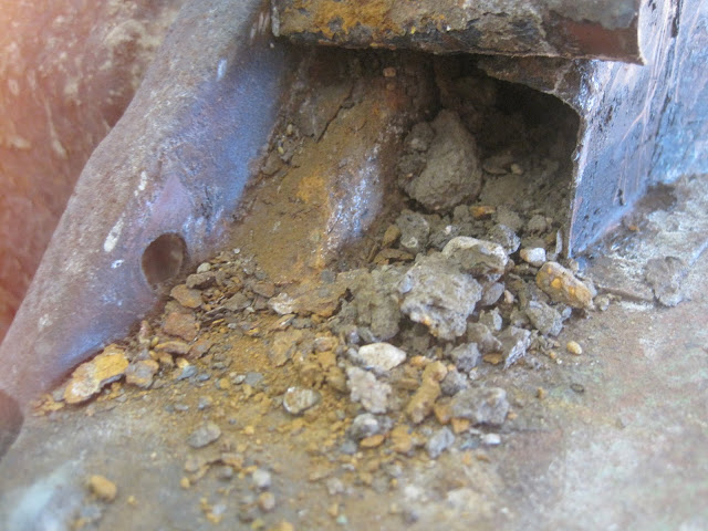

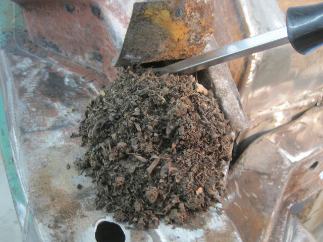

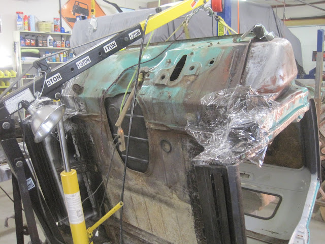

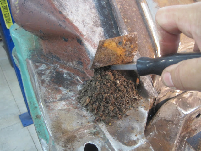

Today was time for some squaring, cleaning (TONS of dirt came out of the A pillars!) and getting the frame back form the sandblasters. Is there anything prettier than newly sandblasted metal? It has a subtle gleaning texture that glints in the light like a beach saturated with diamonds and white sand..... :drool:
Made sure the steps that where installed where squared - all good!
That little tab at the top in the next photo - designed to do what? Trap dirt? Did a VERY good job of it!
Then I started digging out the ****....
And digging....:headscrat
And it kept coming out too! I filled an entire vacuum bag with what was packed in both A pillars for who knows how many years....:wtf:

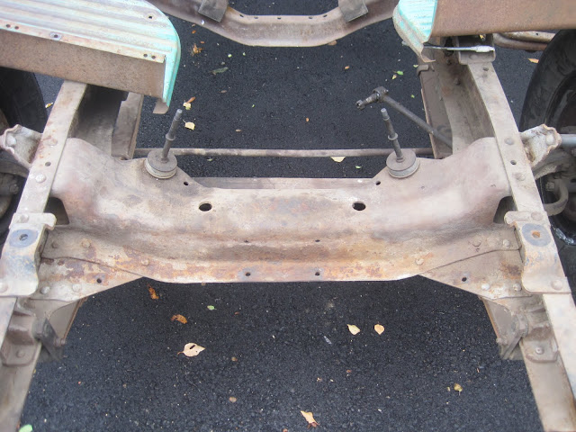

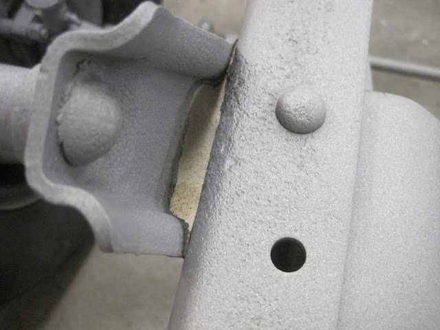

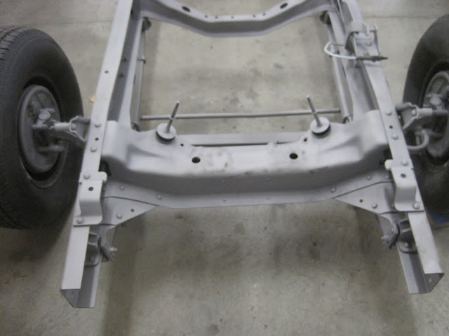

The frame came back from the sandblasters today too. The metal - EVERY BIT OF IT - even the rubber frame stubber's - came out like new!! I'll throw up some close ups tomorrow!:thumbup:
Thanks for looking!
E
e-tek
Dec 19, 2007
10,690
Saskatoon, SK
Re: E-tek Resto's 56 Chevy Truck

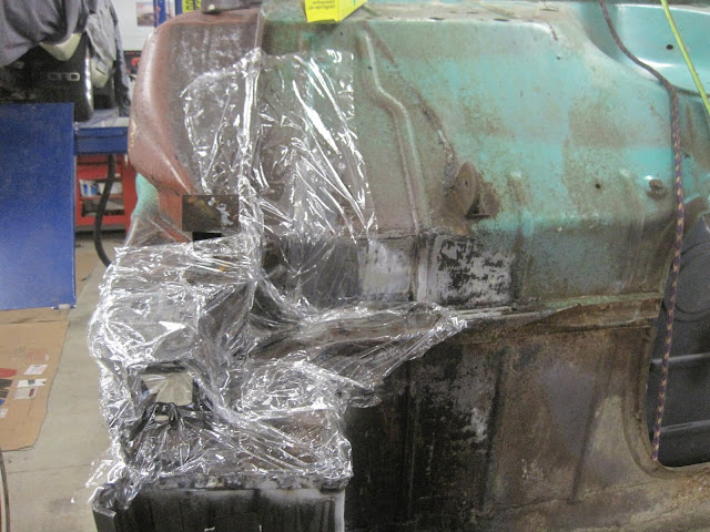

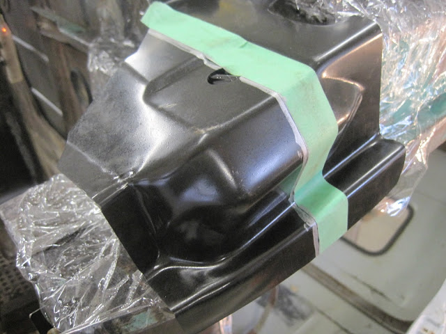

Didn't really do much metal work, but re-sprayed the rust with MetalReady and took some photo's of the sandblasted frame to show before and afters.
I like to wrap the sprayed areas to lessen evaporation:
This is a re-pop part for the lower A-Pillar. All that accumulated **** shown above is what rusts out the metal. These will make a nice splice. The cut-line is marked.
Check out the before and after....
The frame, suspension and associated parts look awesome. These will mostly get POR15 and a semi-gloss frame enamel, except for parts that should be detailed various colors. Time for some research!
Look at the backing plated and suspension parts - straight outa the womb!
Gotta make sure to remove all the sand before painting!

I was going to say something earlier about the tie rod ends, and the drag link but I looked up the drag link and the picture showing was of the newer style socket ends. So far you have not posted a picture that shows the drag link or steering arm but I see in the picture that you have the older style ball ends on the tie rod at least. These are adjustable to take up slop that is caused by wear. But after time the balls wear out of round and then adjusting will have problems as you will have tight spots at extreams of travel or slop while on center. Rebuild kits are avaiable that include new ball studs and other parts to renew the ends. I did this on my '49 and it made a world of difference.
So, check your balls if your staying with the stock frontend.

Today was time for some ... cleaning (TONS of dirt came out of the A pillars!)
Did you make any modifications that will prevent the trapping of **** in the future? Pictures?
:headscrat
Oh ya - sand is still very legal. It's a natural substance - why wouldn't it be?:lol_hitti All the industrial blasting is done outside too - with wind blowing the sand and dust for miles around! So - being a natural substance, that makes up most of Australia - why would it be illegal there?:wtf::headscrat
Airborne particulates and lung contaminates is the answer. Don't know if it will ever be illegal here but in my business (heavy civil construction) when we saw concrete all the slurry that comes out of the cut has to be vacuumed up. This was never the case in the old days. Concrete slurry is just water, cement, sand, rock particulates - as you point out, all natural, but it is not legal to let it into the sewage system.
