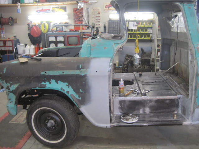

Did a lot of interior & exterior sanding today, which doesn't translate in photo's very well (but is dirty, hard work!).

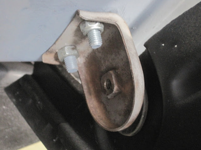

As well, began the bolt-up of the front end. Not having taken it apart - and not having any of the fasteners (old or new), or a FSM for that matter, is like a jigsaw puzzle - without the box. I had to stop a little earlier than planned, but first thing tomorrow - I'll order a FSM and some fastener kits!

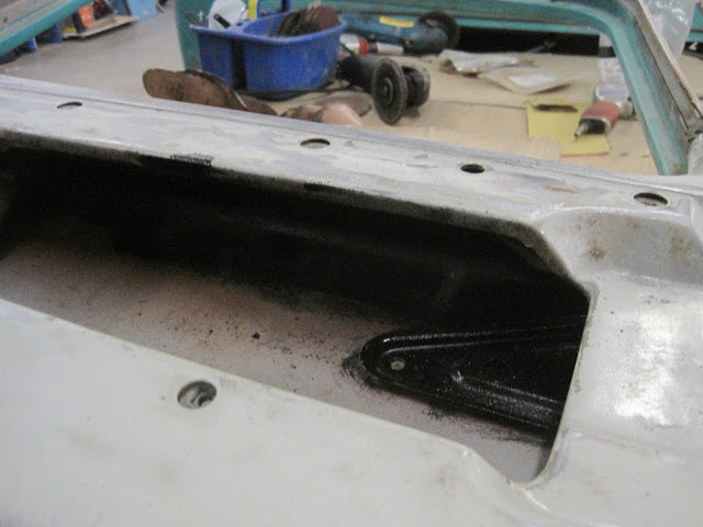

Got the lower A-pillar brackets welded back on and applied POR 15 to the cab bottom. Once the POR15 dries, I'll apply a Black Seam Sealer to any seams and gaps on the underside.
As well, I put a little AllMetal on some areas to be smoothed (inside of door sill/step).

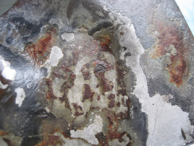

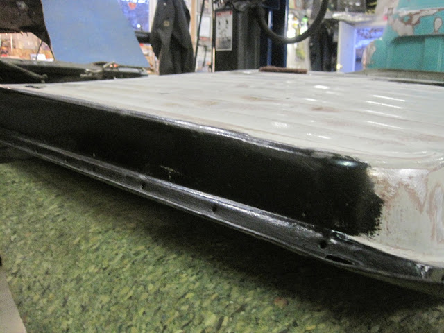

A skiff of AllMetal on the lowers will help stave off rust as well:

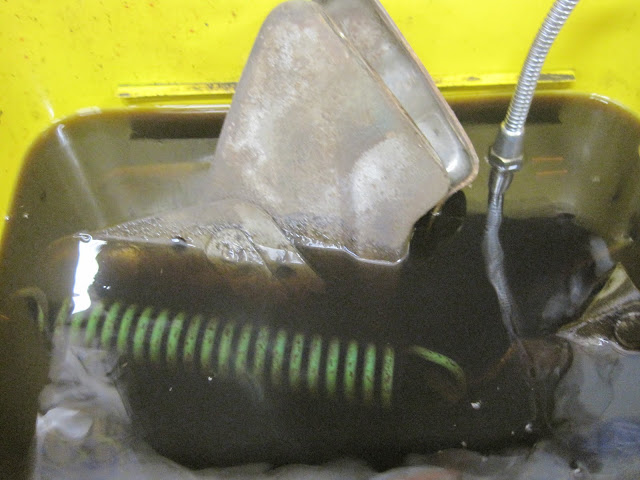

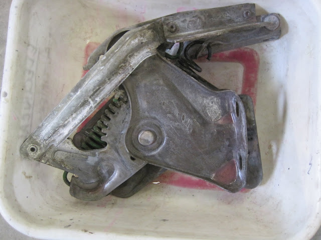

Cleaning the hood hinges - in a bath of Varsol and rust-eze:

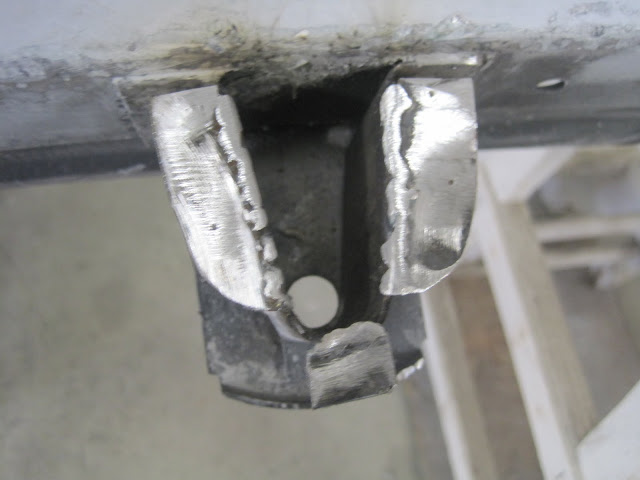

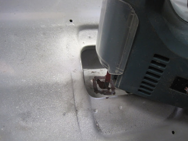

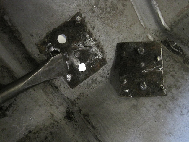

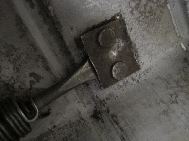

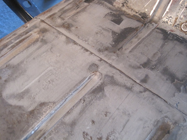

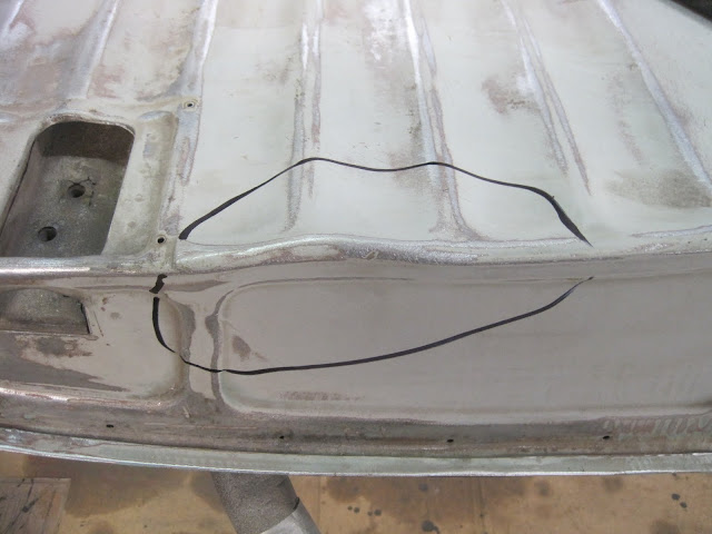

This item (bed-floor cross brace) needed some serious repair time:

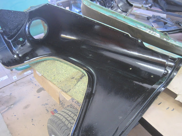

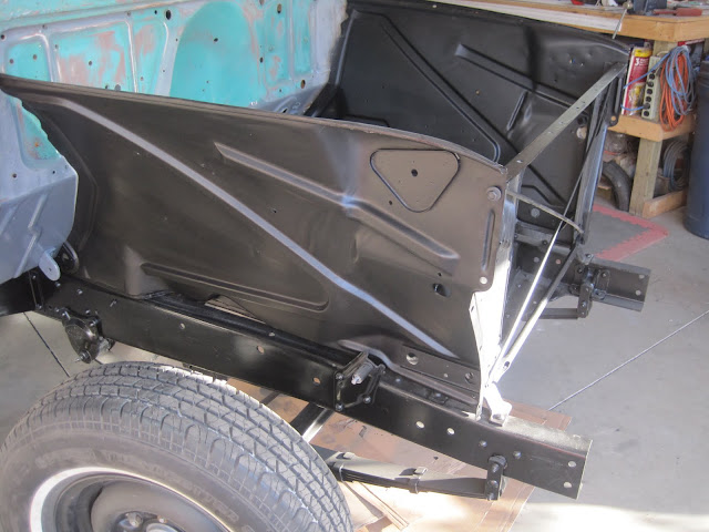

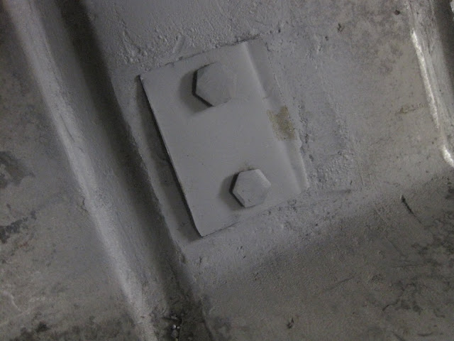

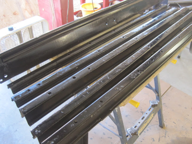

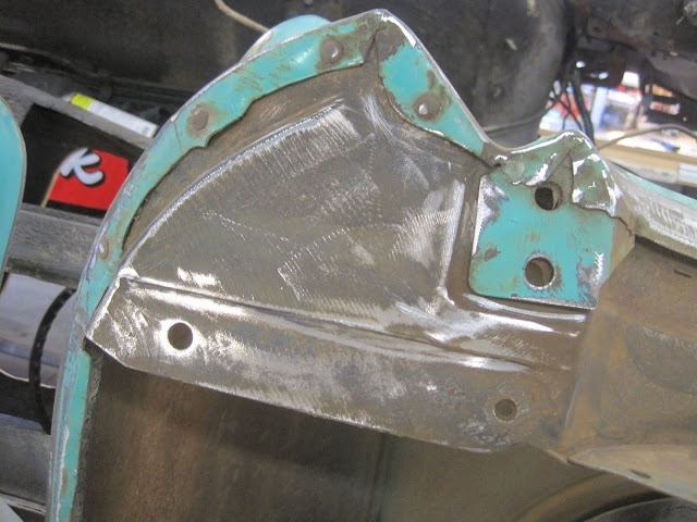

After cleaning and sanding the inner fenders, treated them with POR15:
Second coat on the bed rails as well

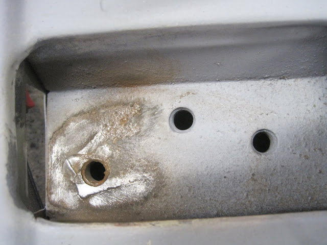

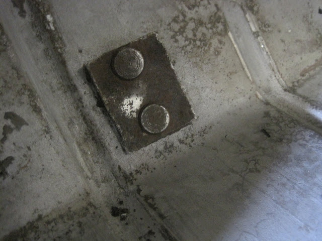

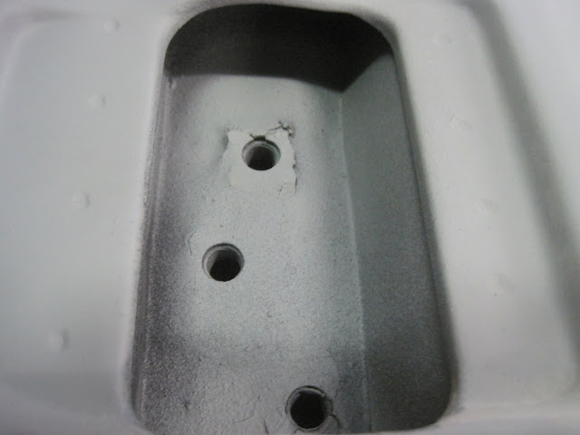

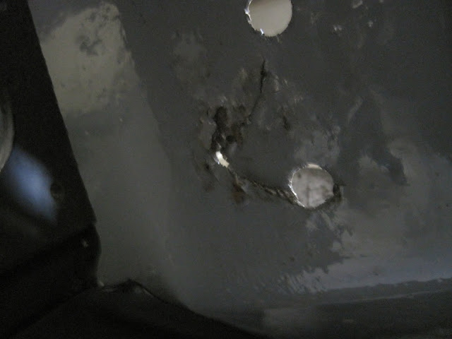

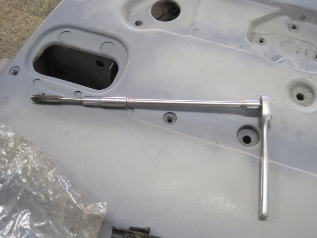

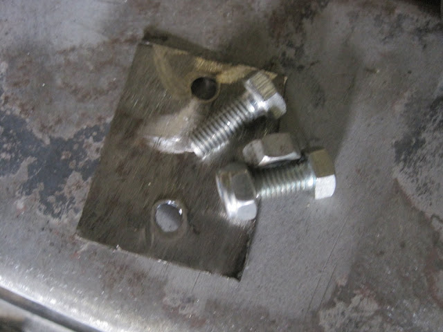

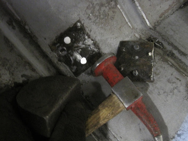

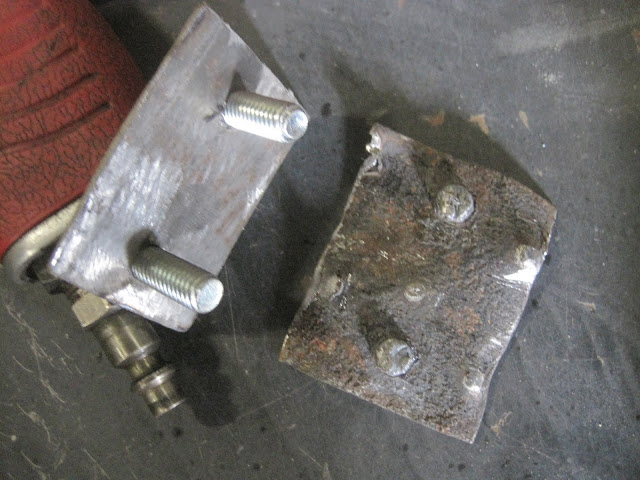

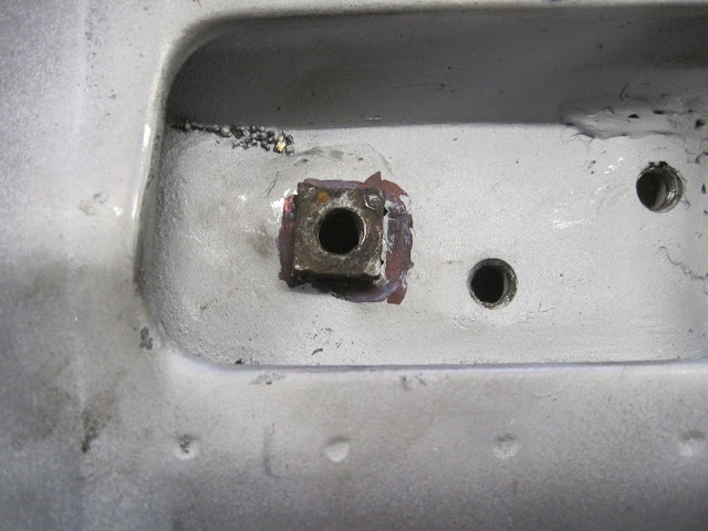

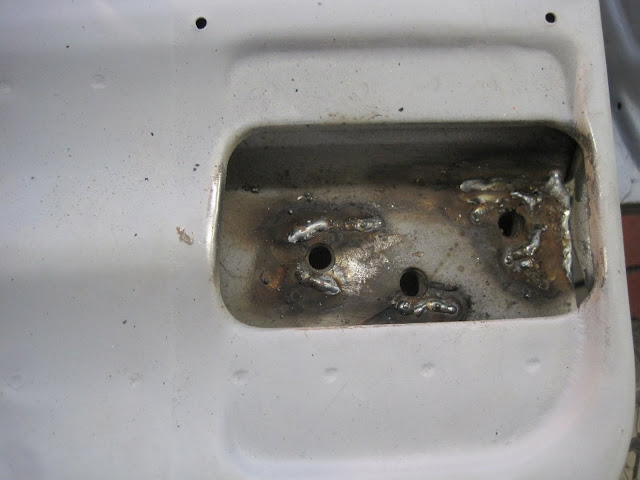

On disassembly, both bolts attached to this mount where broken off. As I want to re-assemble the F. End to set the gaps/do bodywork, I needed to remove it, make a new braket and get the bracket back on:

I have found that when using POR-15, it's often better to use a centerpunch and punch 2 holes in the lid, on opposite sides of the can (like old school oil cans), and pour some into a disposable cup. If you seal the holes in the lid with a piece of electrical (non-porous) tape, it's a piece of cake to keep reusing and nothing will weld shut.
I had a can last over a year using this method.

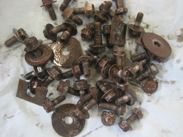

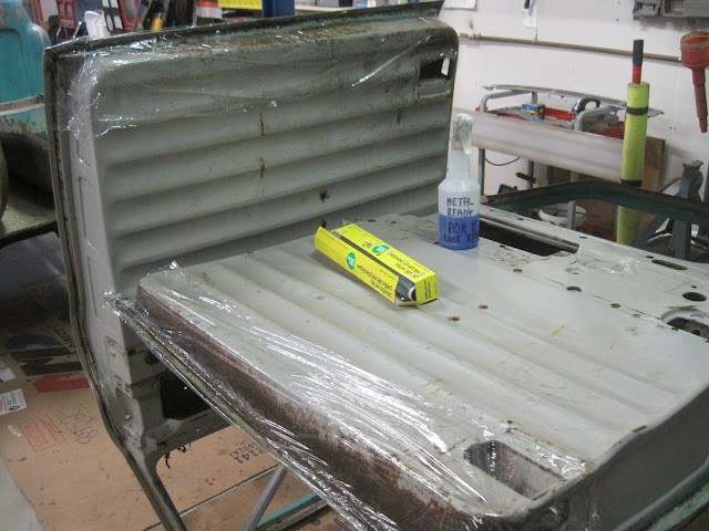

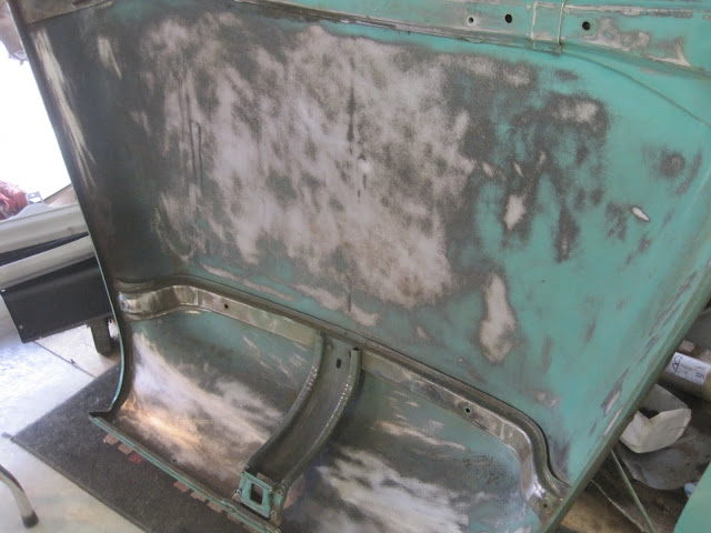

More Metal Ready treatment on the door surface rust:

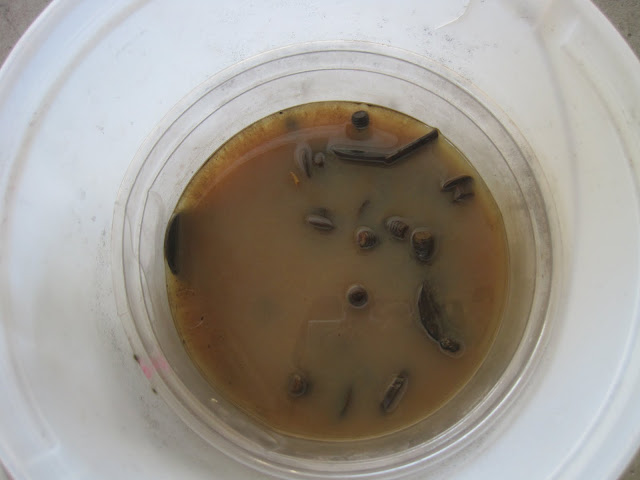

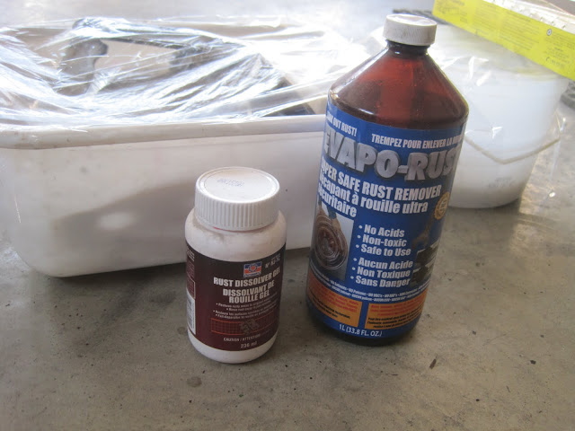

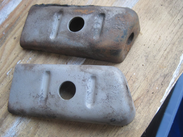

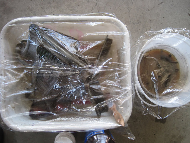

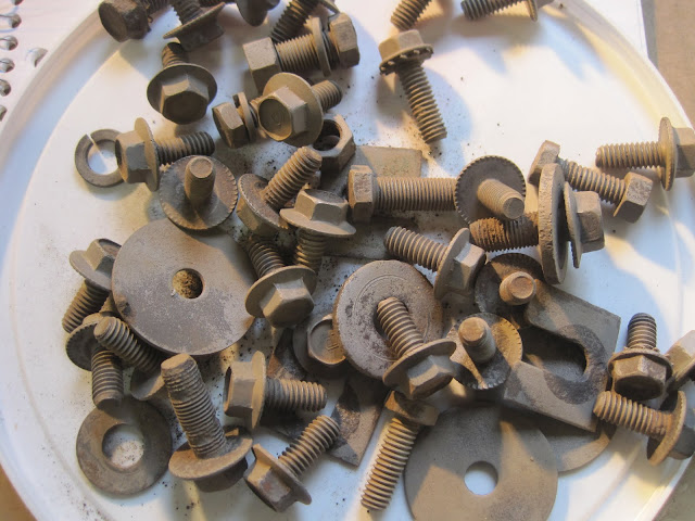

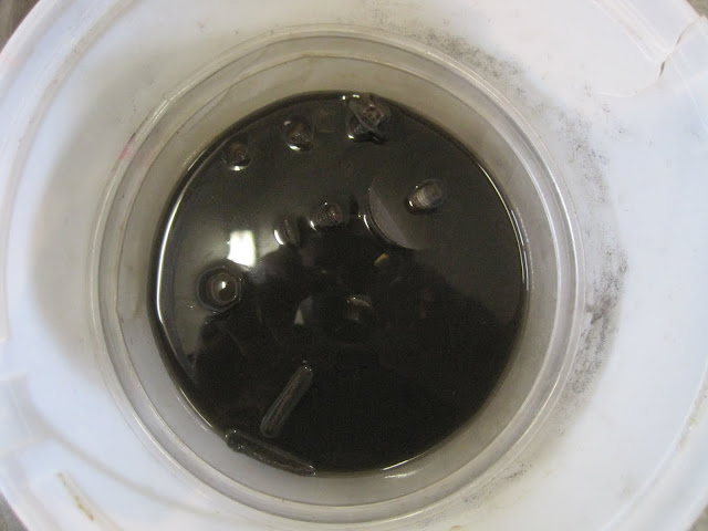

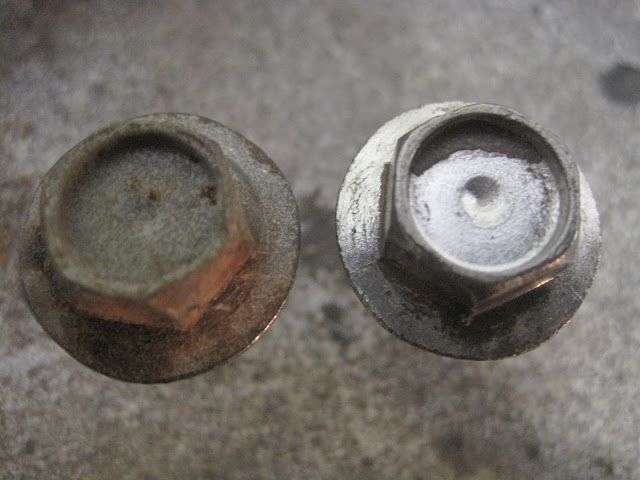

I like to test and re-test various products that may help in restoration work. Lots of people seem to like these "rust-washes", but I've never had much luck with them. I'm guessing they may work on a little "top-surface" rust on chromed or polished tools, but that's about it. I had a bag of fasteners I needed cleaned up for the F.End, as well as the hood hinges (which I don't like to sandblast), I thought I'd give it another try. I soaked the fasteners in a bucket of Evapo-ruat and brushed Permatex' Rust Dissolver Gel on the hinges. All where left overnight.
Of course sand-blasting always works!
The Evapo-rust in the fastener bucket turned black and the hinges, which only had some minor surface rust, changed color. Maybe this time!
The hinges loo pretty good, but as you can see, when I took the fasteners out, they still looked pretty nasty....
I'll just fire up the sandblaster.......:wtf::bounce:

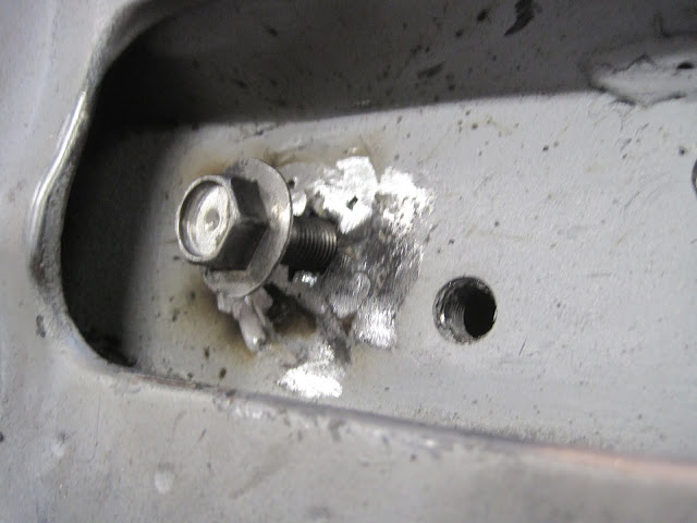

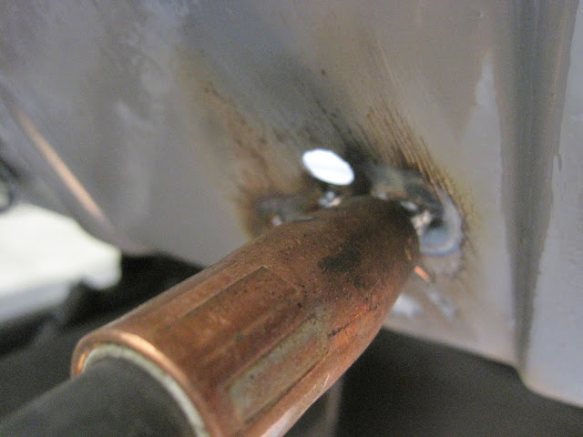

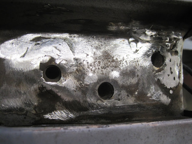

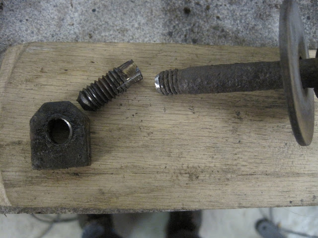

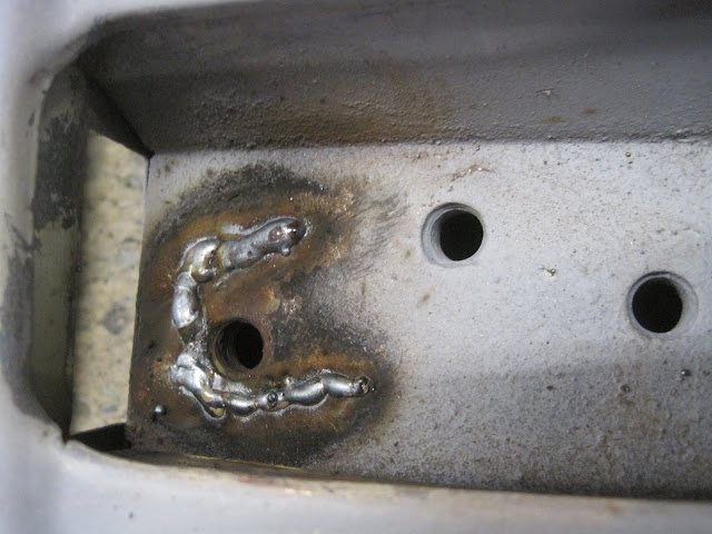

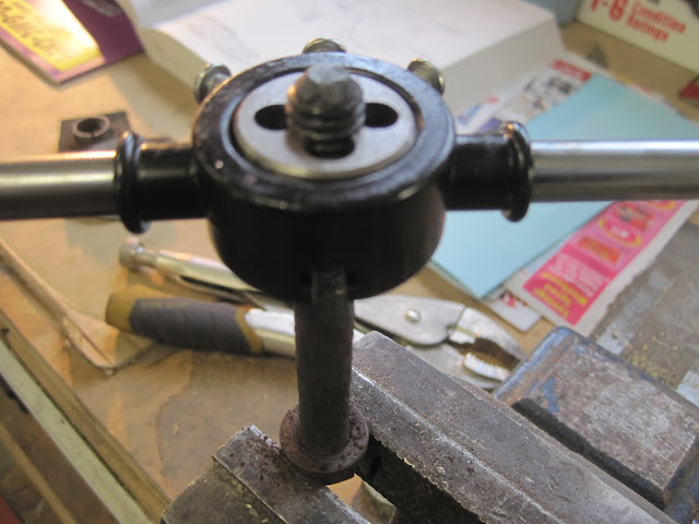

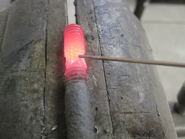

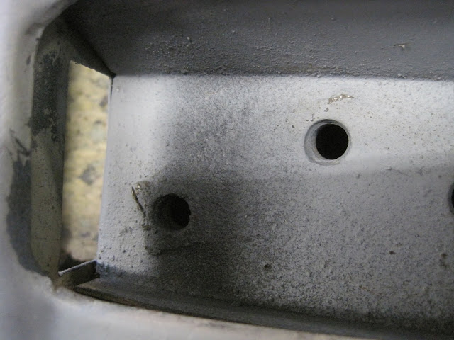

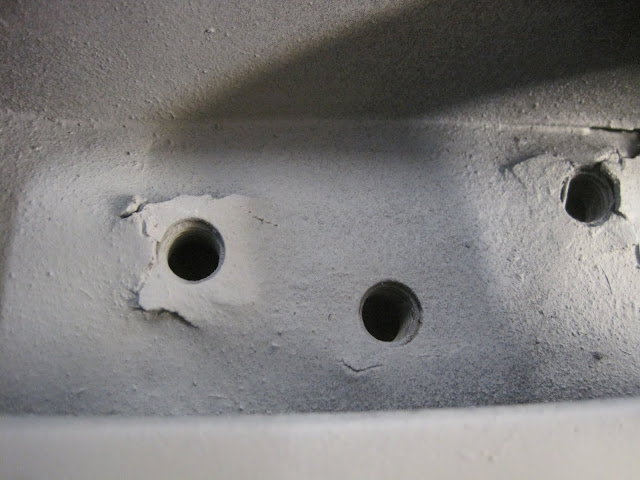

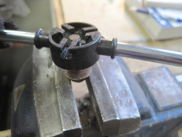

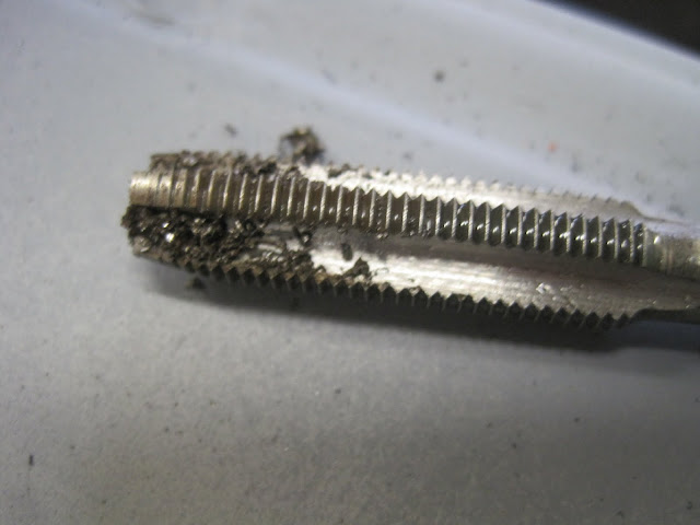

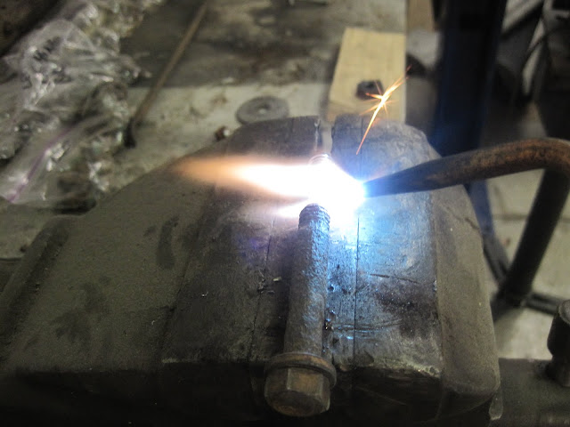

One of the long bolts for the cab mounts had snapped on exit. As it was Sunday and I couldn't find a suitable repalcement in my own collection, I decided to do a temp repiar so I could continue with my day....
I used the OA set-up becuase I wanted to weld it together either with it's own material, or with the softer metal of filler rod.
The bolt was fused togther with it's original material, but build-up was needed, so I ended up added filler rod to the circumference.
Once filled out enough I recut the threads and was on my way to getting back to work. Monday I'll head to the bolt shop.

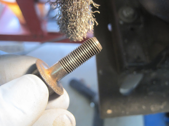

No need to whine! lol. I usually just take a box of bolts over to my wire wheel on my bench grinder and have at it.

Do they plan on painting over the POR15 or undercoating over it? The reason I ask is that the POR needs a nother coating to prevent fading from UV rays or it will dull out in no time.
I'll be overcoating some of the parts (those exposed), so what you do is spray a "tie-coat" primer on, then the top coat. POR goes a bit grey over time in the sun, but it takes 6 months to a year.

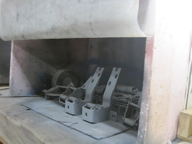

Todays weather: STINKING GROSS!! We had an early season blizzard here in Saskaberia, so instead of driving out to see an account of mine 2 hours away, I spent 6 hours in the shop - much more cozy and relaxing!
First off, sandblasted all the hardware that I had soaked in the Evapo-Rust and/or brushed with Permatex' Rust Gel - two products I CANNOT recommend. Check out how the hinges came out after trying to clean off these rust preparations:
Close up of the mess left behind:
Sandblasted fasteners:
I then put all the blasted parts in my small-parts paint booth/fume hood, ready for Etch primer:
For those that haven't seen it before, here's a shot of the fume-hood, the duct fan I use to exhaust the overspray, as well as the filter medium as I changed it out (works well!):

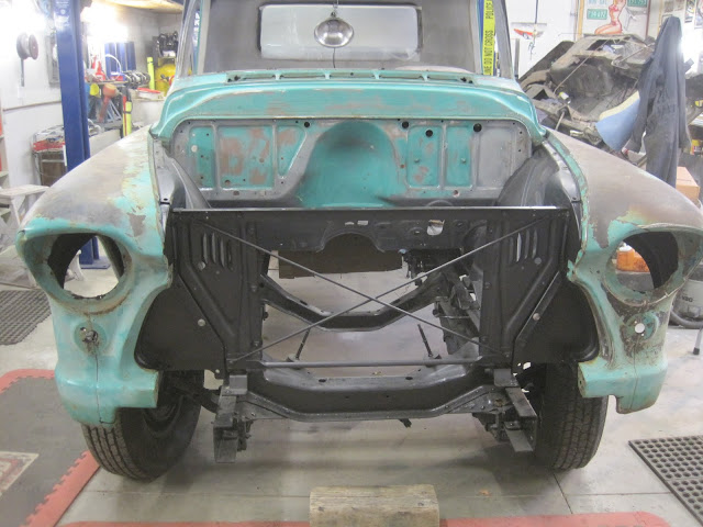

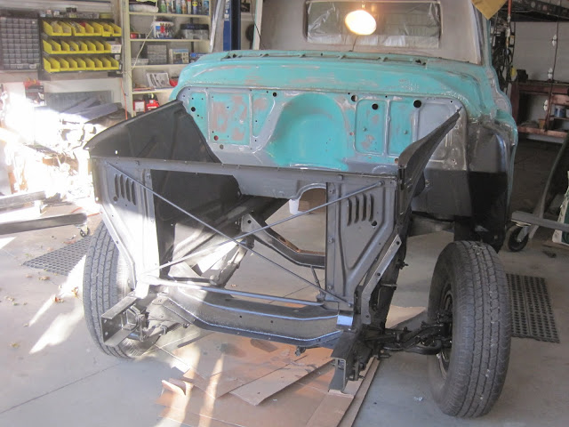

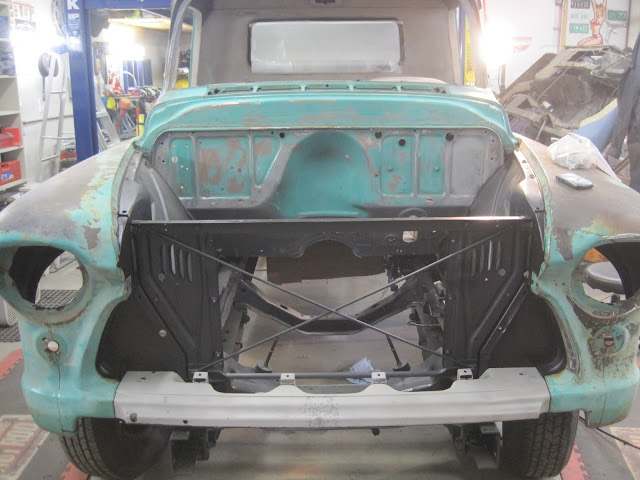

Bolting up the fenders - took an hour to align the left one due to the inner fender brace touching the A-pillar where I made some repairs - that's why it's SO important to bolt everything up before paint.
Front-end looks straight!
Front-end with filler attached:

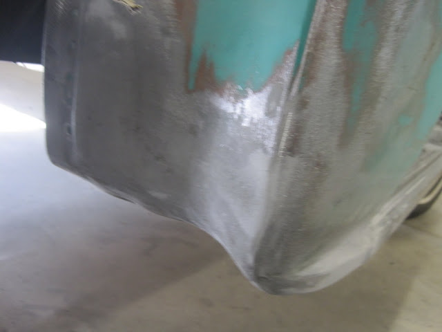

As well, I ground down the rust on the door bottoms and sprayed them again with MetalReady. While doing so, I found a couple small rust-through spots that will need repairing.

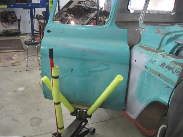

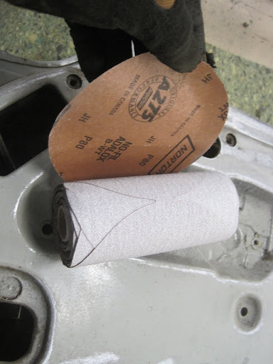

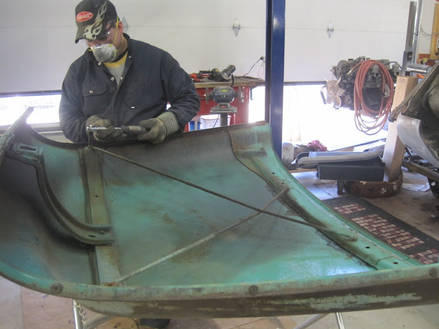

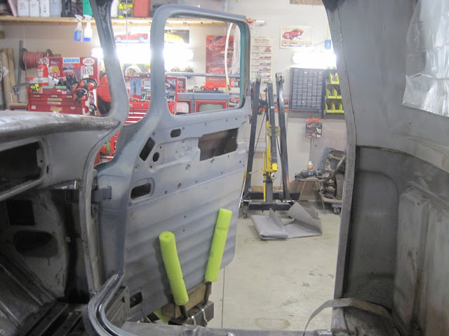

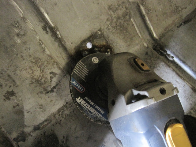

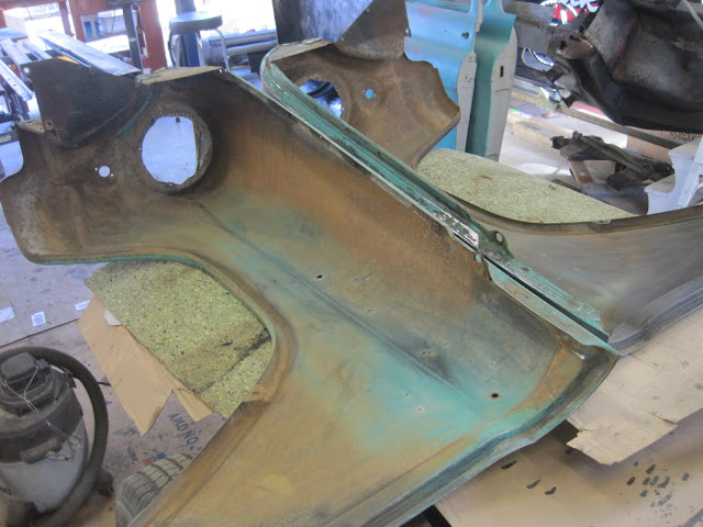

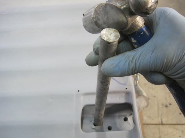

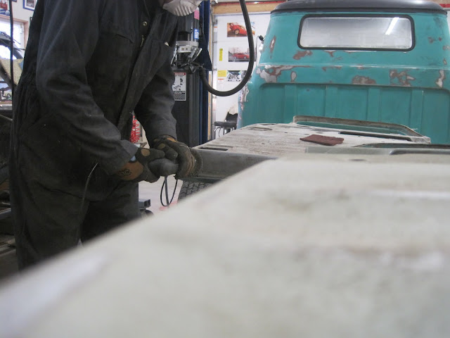

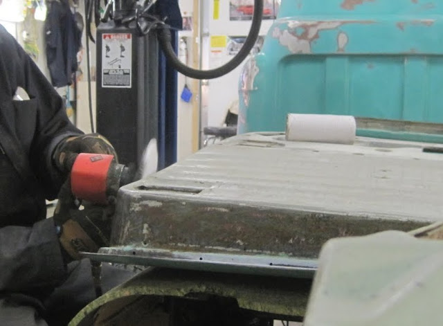

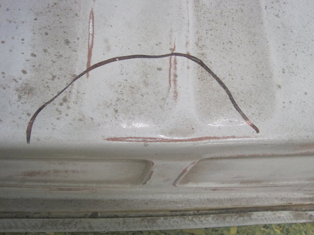

After pulling the hood and door hinges out of the fume hood, I got to sanding down the door inners. Want to get some primer on them prior to bolting them onto the truck for fitment and body work.
80 grit on the DA amkes quick work of the factory runs (lots!), grind off rust and any chips or scratches due to the ravages of time and hard use:
Used a wire wheel to clean out the edges along the crimped over door skins

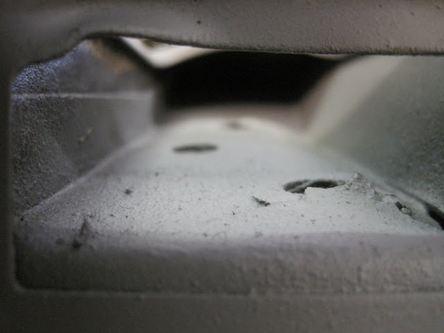

Then cleaned out the water channels on the door bottoms to make sure any water doesn't sit in there again
Lastly, I applied POR15 to the door bottoms that had been treated (several times) with MetalReady, as well as on some rusty spots on the inside of the door skins. On the bottom, I made sure to get the POR15 into the water channels and the door skin edges. Show me a shop that'll do that!
The inner doors will require a few hours of metal work...someone along the line was pretty hard on the old girl!

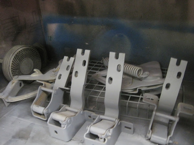

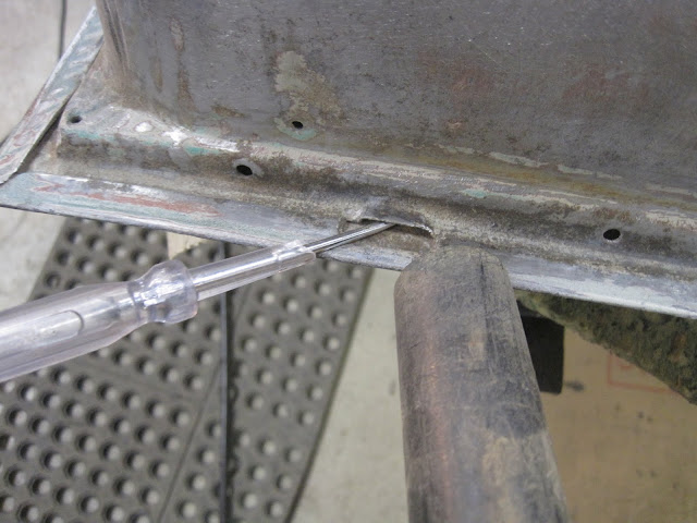

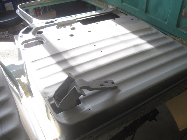

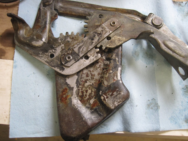

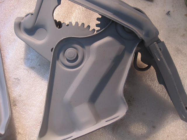

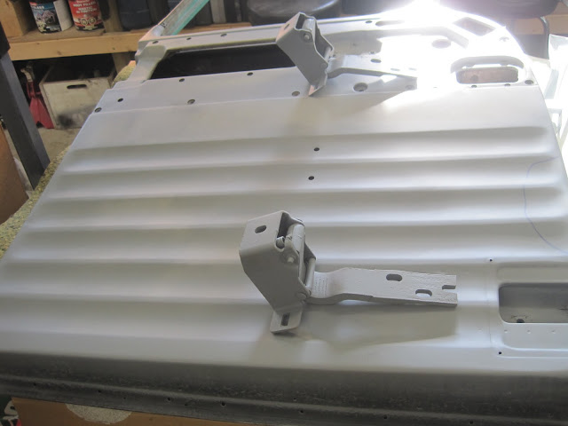

Remember those crusty hood hinges? Here's the blasted and primered product:

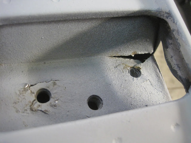

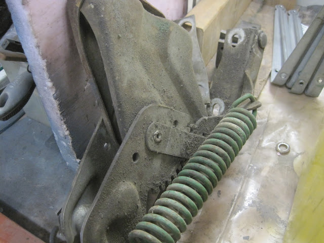

The door hinges where tweaked - as evidenced by the damage to each door. They show here as pulled up at the thread holes. In the repair, the thinned metal split at the fold. This will require some welding of course, but I also will need to figure a way to shore it up to add strength.

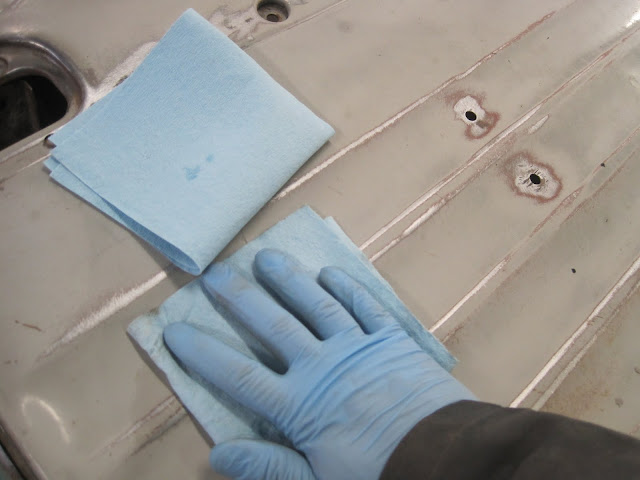

Preparing for primer with wax and grease remover. Always wipe on and dry it off when still wet.
Etch primer went all the bare metal areas

That is some serious damage on those hinge mounts!!! Well I'm confident you'll come up with a good way to fix it, that'll last longer than the factory job!

You can see the spot welds in this pic holding the "hinge bolting plate" in place. Should be a fairly simple drill out the spot welds and fab up a new one, reweld. Coming along nicely Etek..

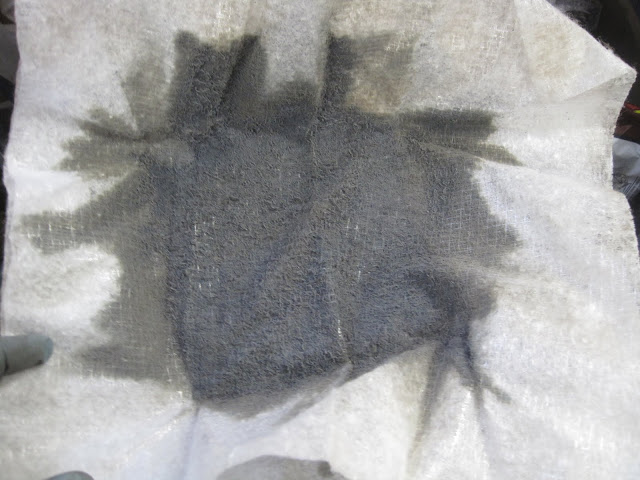

I use a product over here called Deox-C made by a company called Bilt-Hamber. It comes as a powder you mix with warm water and then just soak the parts in it overnight and it really does work. It works even better if you can keep the solution warm, I keep meaning to invest in a small plastic tank and a fish tank heater to do this. Just to give you an idea this picture shows the old steel shutters from my house in France, they were heavily rusted, all I did was a quick once over with a wire wheel to remove the loose rust, mix up a couple of gallons of solution and make a bath by simply digging a hole in the then earth floor of my cellar and lining it with heavy gauge plastic and soaked them for 24/36 hours. they came out like new. I use it a lot on car parts with great success. Its non toxic and non corrosive, just stings a bit if you have any cuts on your hands.
dellwas
Sep 16, 2009
388
Chester Grant, Nova Scotia, Canada
Re: E-tek Resto's 56 Chevy Truck
That stuff is awesome! I'll have to see if I can find a source for it in Canada.
I use a product over here called Deox-C made by a company called Bilt-Hamber. It comes as a powder you mix with warm water and then just soak the parts in it overnight and it really does work. It works even better if you can keep the solution warm, I keep meaning to invest in a small plastic tank and a fish tank heater to do this. Just to give you an idea this picture shows the old steel shutters from my house in France, they were heavily rusted, all I did was a quick once over with a wire wheel to remove the loose rust, mix up a couple of gallons of solution and make a bath by simply digging a hole in the then earth floor of my cellar and lining it with heavy gauge plastic and soaked them for 24/36 hours. they came out like new. I use it a lot on car parts with great success. Its non toxic and non corrosive, just stings a bit if you have any cuts on your hands.]

Well, after a bit of down time in San Diego - where cars don't rust but everyone leases new - I got back at the 56!
Last I posted, I was about to repair the lower hinge pocket on the Right door. I thought (briefly) about removing the pocket, repairing the cracks from the backside and re-installing it, but that was going to add to much more damage to a near pristine door. Since welding from the front or back would basically result in the same repair, I decided to leave it in and repair it from the front. Easy decision.
The other side also had some pull-through around one of the captive nuts.
After an inital weld up, I ground it down and checked where more weld would be needed.
Cleaned up all the bolts as well before re-installing the doors.
and the captive nuts with the "tap on a stick" method...
One of the captive nuts broke loose when cleaning. Since it's inaccessable from the top side, I cut some slits into the pocket and welded them from the top side.
Marked it:
Cut it:
Welded it up:
I made this door installation-holder a while back...no more struggling. Doors are always a one-man job now without the grunting!
Can't see the repairs that where done! I was on a roll, but aligning them will have to wait until next time - the wifey is calling me for dinner!!
