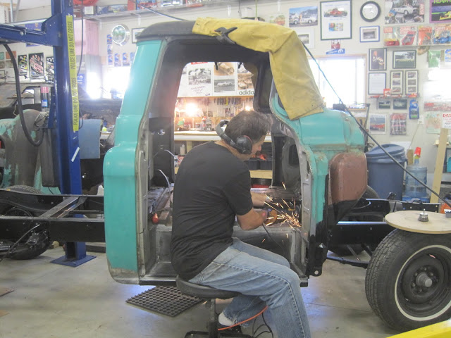

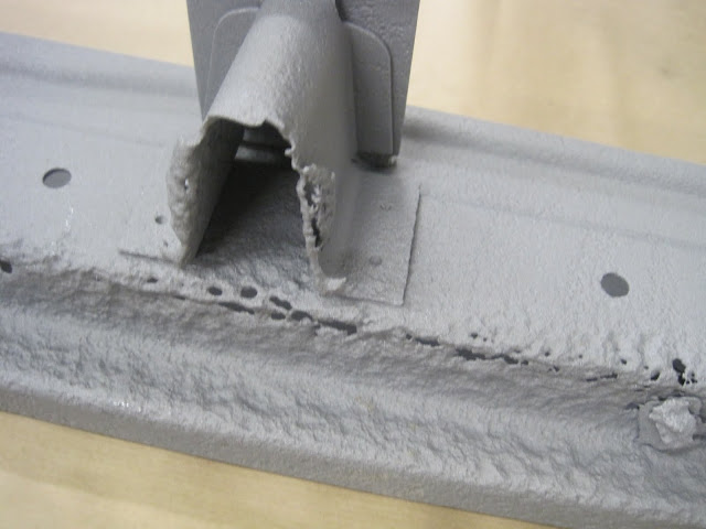

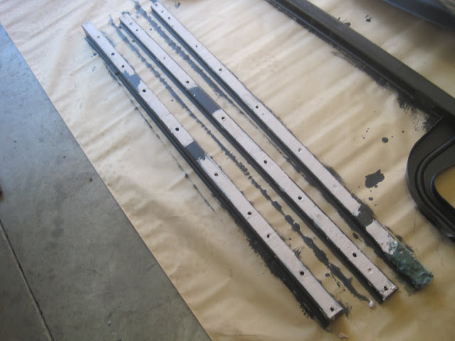

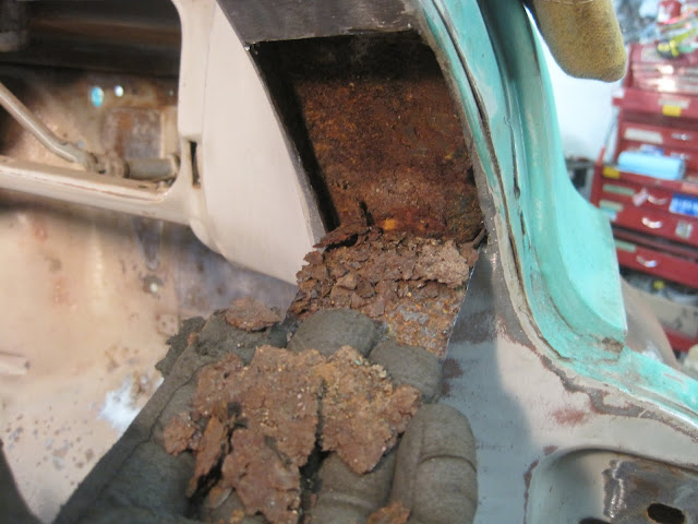

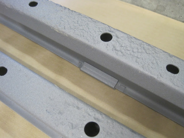

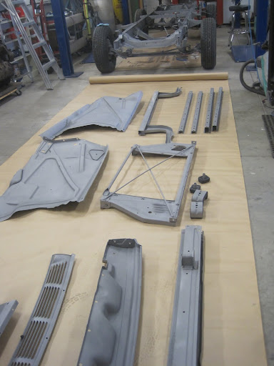

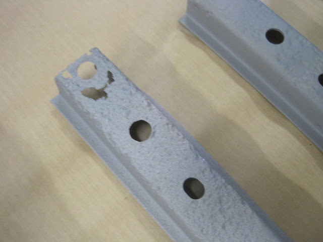

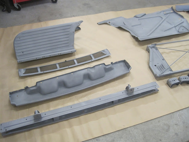

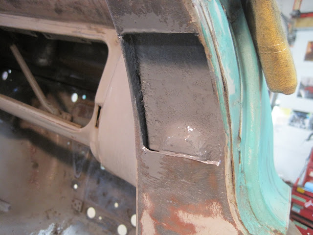

Got all the parts back form the sandblaster now. Looks great! Will need a few spots of metal repalcement, but not bad for the age of truck!

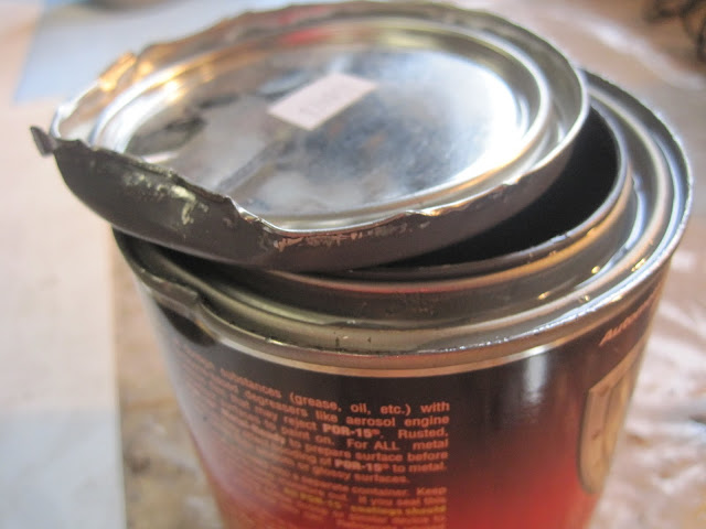

So, I was going to apply the POR15 to all these parts, then spray the top sides with an Epoxy Primer, but I had a few issues....
First issue - one of the cans of POR15 I had must have been opened at one point and re-closed. A tiny amount got onto the lip of the can, effectively welding the can shut. I ruined the lid and can getting it open, necessitating a transfer into glass sealer jars. Although handling this stuff can be a pain, this is why I use it! You show me another product that can weld a can shut!!:bowdown:
The other issue was that it was the wrong color - gray. I had never seen anything but black POR15. When I initially removed the lid on the first can it was black, but upon mixing, turned gray. It freaked me out at first, 'cause I looked all over the can and couldn't see where it said it was gray....until I saw the little stamp on the back. I thought about applying gray for a while, but there was really nowhere that should be gray (save for the OEM gray INSIDE the cab) and it would be a waste to coat once with gray then to go over it with black POR, or black epoxy, or whatever else I could think of. Not wanting to waste time going to buy more today, I left it until tomorrow and went on to more metalwork....

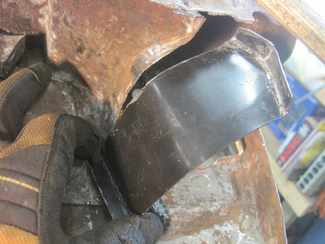

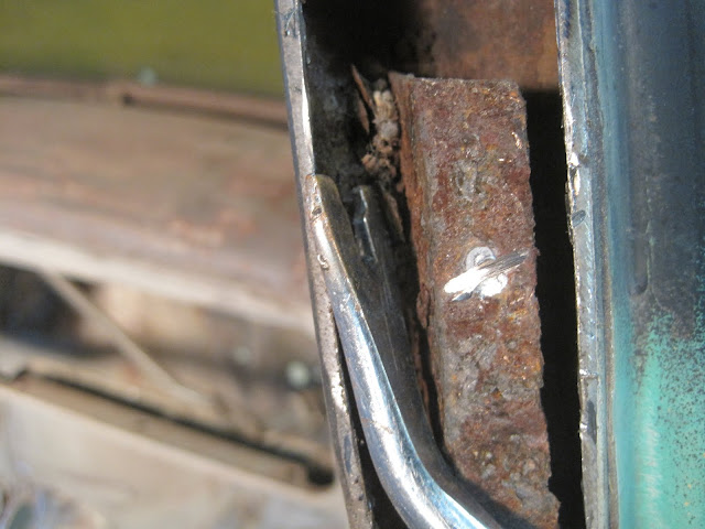

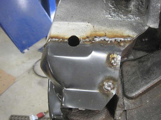

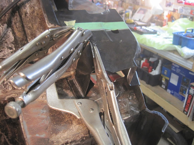

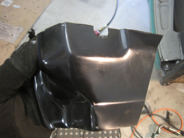

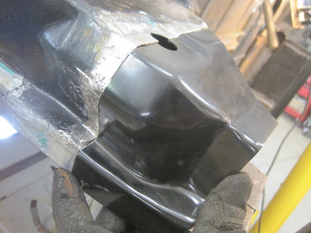

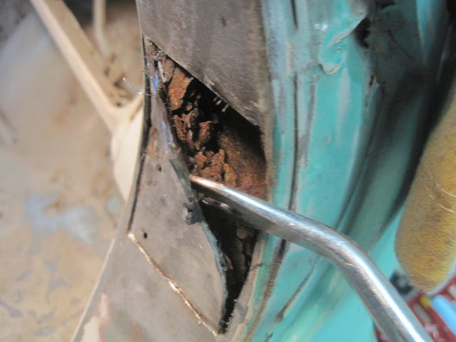

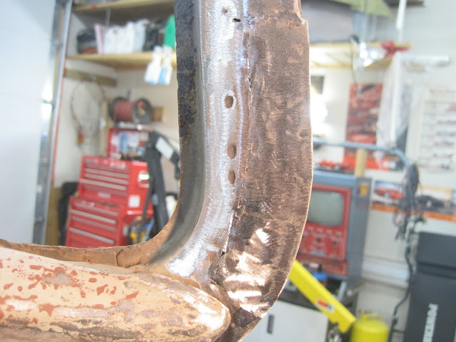

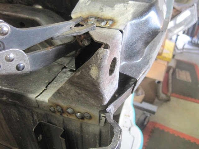

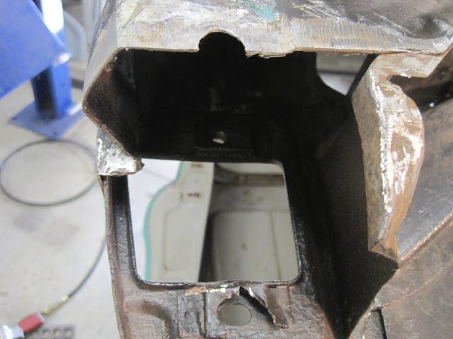

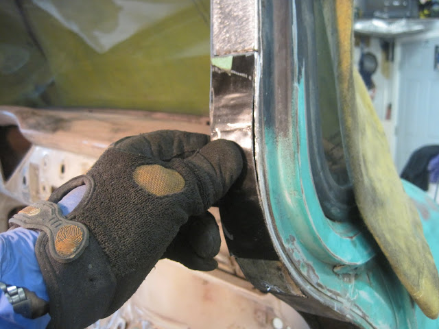

Back to the bottom of the A-pillar, I first removed and replaced the lower-inner portion...

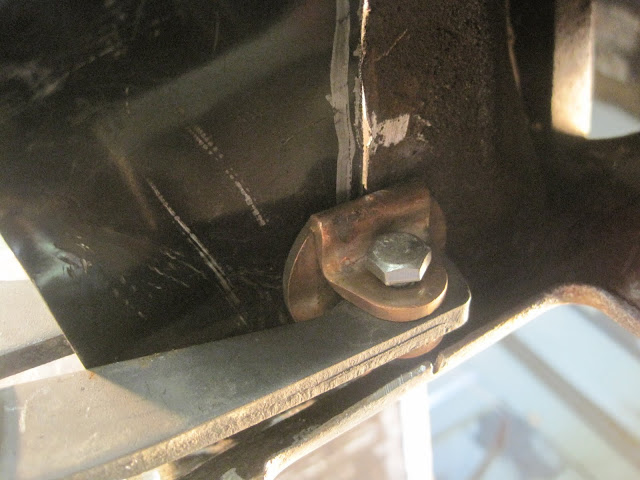

I like to back up my welds with copper. They make copper tools (like this vice-grip), but a flattened section of copper pipe works great too. You can clamp peices of copper in with the vice grips that are holding the pieces together. It disipates the heat and weld doesn't stick to it.
That's it for today. Hopefully I'll get the corner done tomorrow, plus all the parts POR's in black!

You can use the gray to paint inside of the doors, inside of channels where it won't be visible, etc.

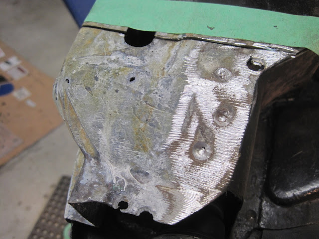

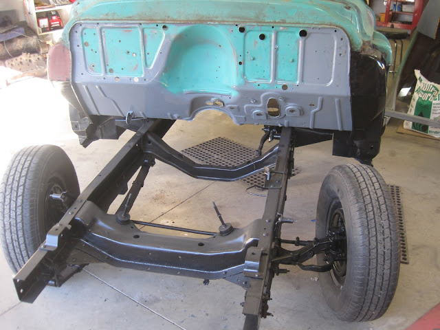

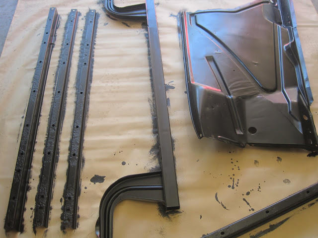

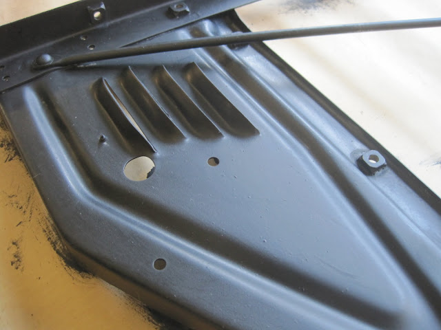

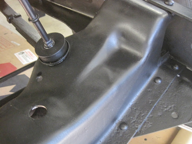

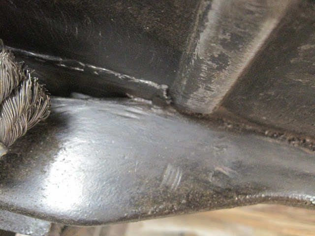

Got the semi-gloss black POR today and painted the frame and other parts - with a brush of course. The self-levelling feature means it lays out perfectly and the semi-gloss is the best OEM match of anything I've ever used - including epoxy primers or paints.
Filled the pitting over the POR15. If you do so within the re-coat window you get excellent adhesion.

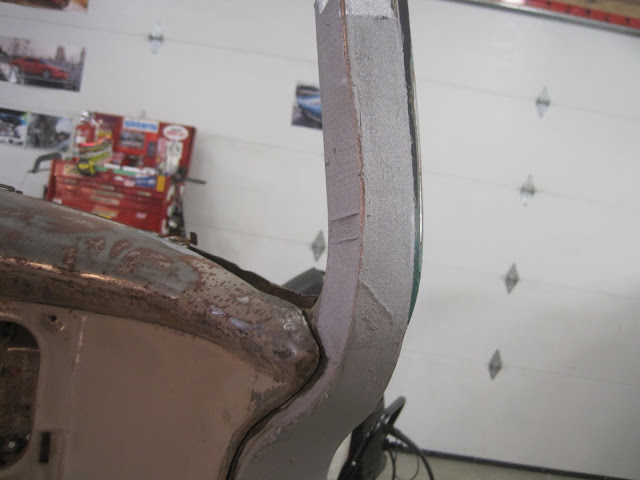

Finished up the A-pillar as well. Dressed the welds and applied a little kitty-hair.
As usual, thanks for looking!

Looks really good! Some of those parts look brand new after you put the por-15 on them. Very nice.

Nice job on the parts they look great. Thats the first time I've seen the semi gloss POR it looks really good.

People don`t realize just how nice this stuff lays down. Between that and its toughness, it unlike anything else out there. It dries faster in the rain, or if you wet the floor down. It`ll survive hammering, bending, rock spray and any gas or oil spills.

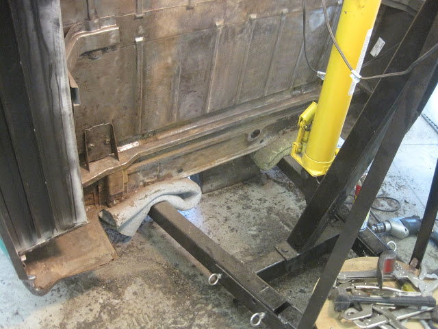

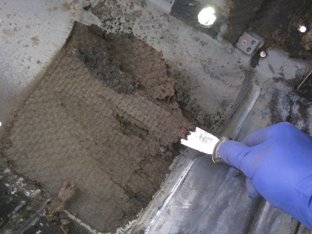

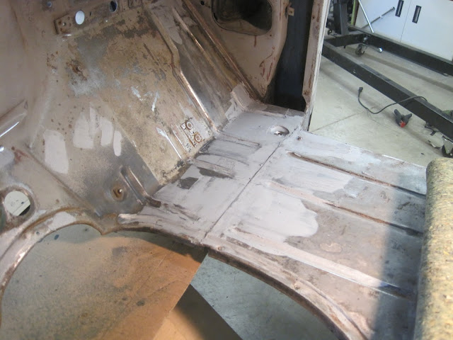

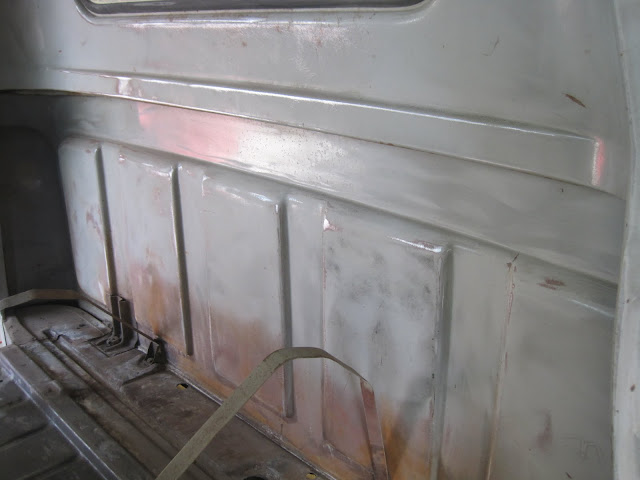

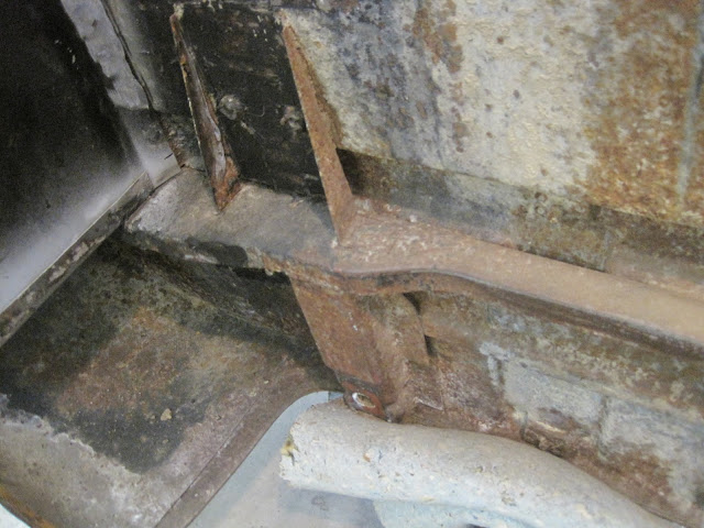

Today I spent a few hours stripping and cleaning the underside of the cab (because my helper didn't show up!:lol:). This is in preparation to application of POR15 so I can then remount the cab to the frame. Once there, I can trial-fit the front end to set the gaps and do the body work and blocking.
A lot of the metal is in very good shape, save for a light coating of surface rust - perfect for POR15 adhesion!

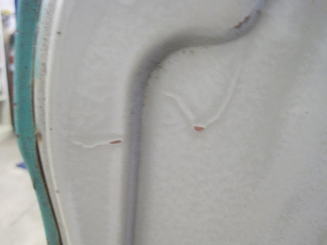

And speaking of POR15....i had applied it on one of the repairs I did previously, so I wanted to rough it up for the full coat. Even with a wire cup it was hard to scratch it up, much less remove it!

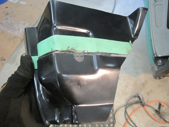

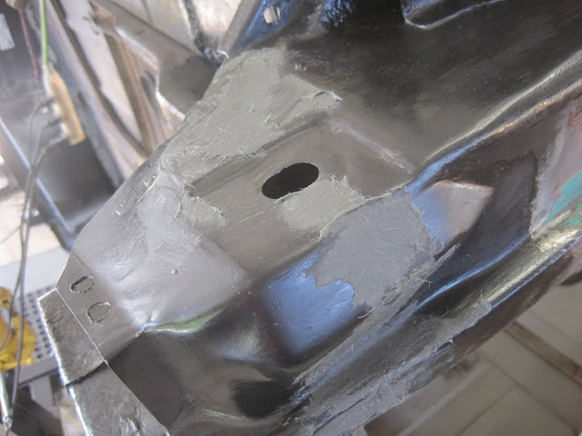

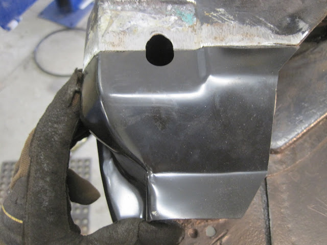

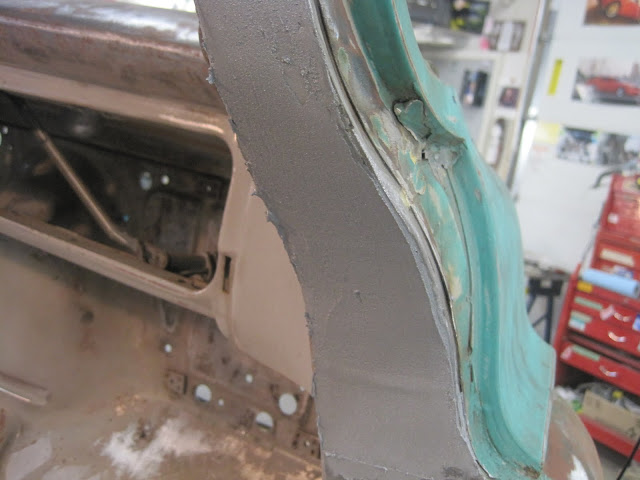

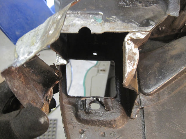

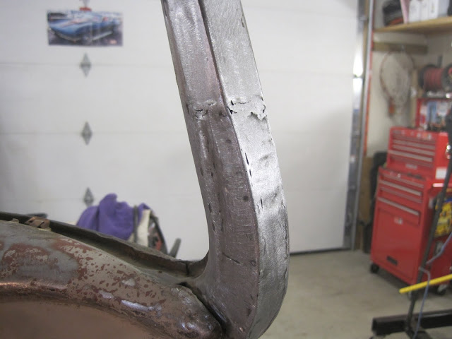

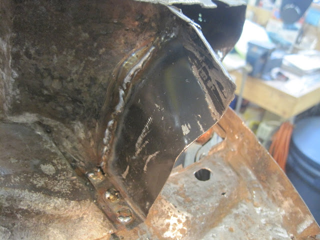

Got the other (R) A-pillar bottom changed out today. Here's an "ultimate" step-by-step....
A THIN skif of kittyhair and she'll be good as new. Can't wait to get the POR15 on the cab floor so I can remount it, but I still have a couple things I want to clean up while it's off and up like this....

I'm not familiar with this Kitty hair. I am impressed with your work. Thanks
Dave.
Its basiclly a body filler w/ shredded fiberglass.:beer:
Asked and answered!
I think I already said this here, but I'll just add that I use it in these applications for it's waterproof properties. Applied over welds here it covers and seals any tiny voids. Regular filler is not waterproof.

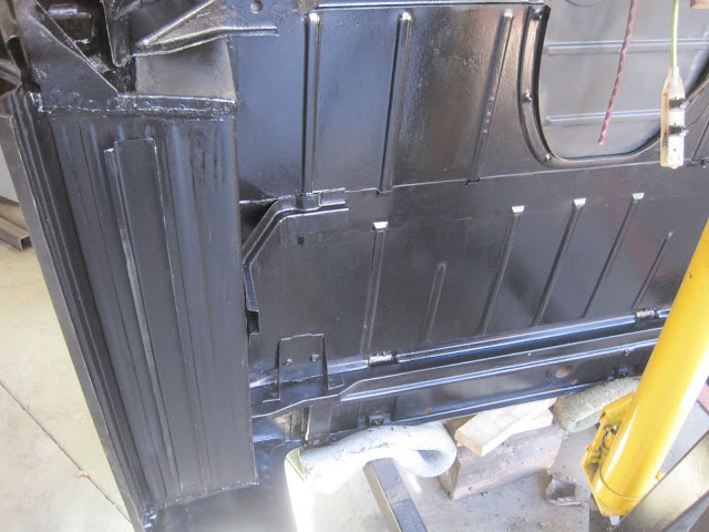

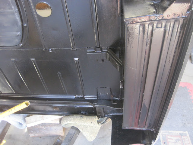

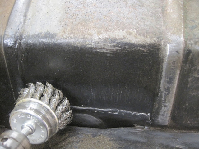

Got the lower A-pillar brackets welded back on and applied POR 15 to the cab bottom. Once the POR15 dries, I'll apply a Black Seam Sealer to any seams and gaps on the underside.
I take it that the bottom of the cab is ganna be black ?
:beer:

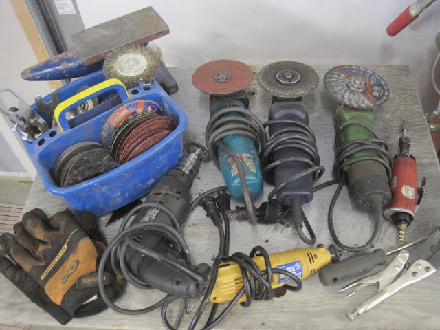

Some of the tools I used....

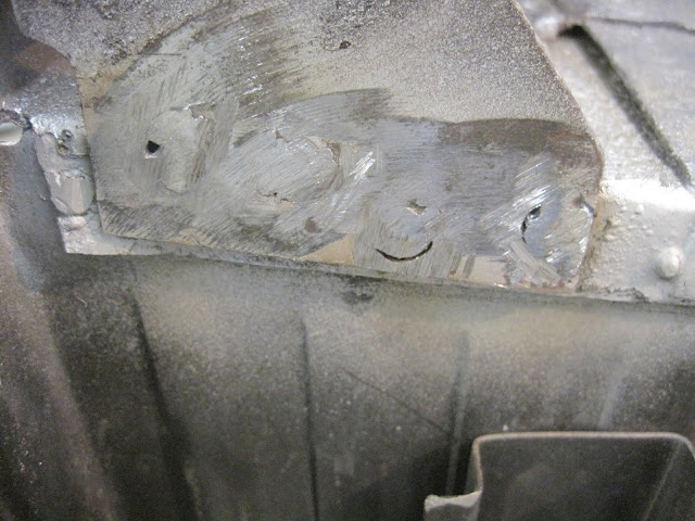

As well, I put a little AllMetal on some areas to be smoothed (inside of door sill/step).

Thanks and I don't mind at all! As a rule, fillers should be applied over clean ground metal only. That's what it says on the can/MDS sheets and that's the way I've done it for 30+years.....HOWEVER, I don't see a reason not to put it over POR15 where there's rust, as the POR adheres so well to the metal and seals off any rust and the filler adheres extremely well to the POR15 (applied within the 24 hour recoat window is likely a best practice). I use kitty hair (short-strand re-enforced filler) or AllMetal wherever there may be exposure to water and over welds.

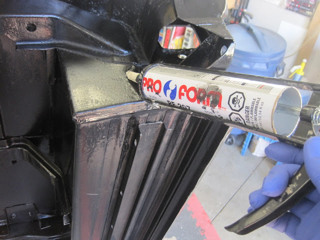

Today I sealed up the new panels and some areas that should have been sealed from the factory. Then I applied a second coat of POR15 to finish off the bottom. Tomorrow I'll sand and primer the firewall then it'll be ready to bolt back onto the frame.

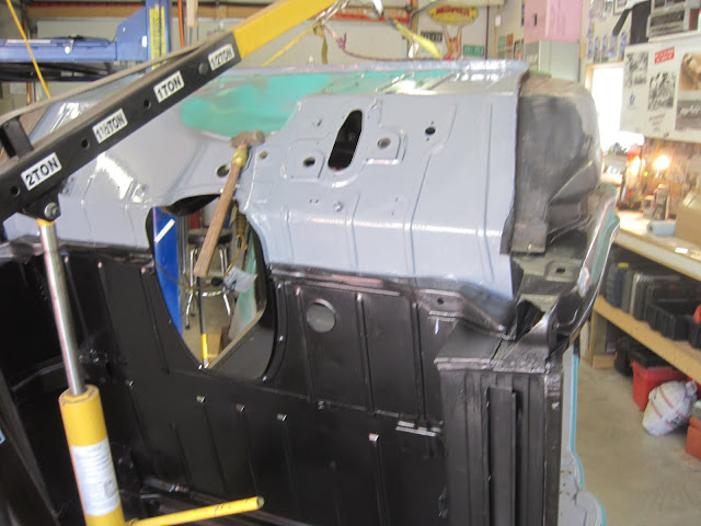

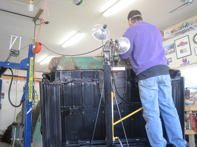

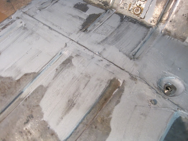

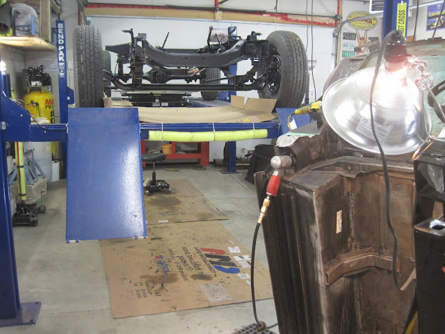

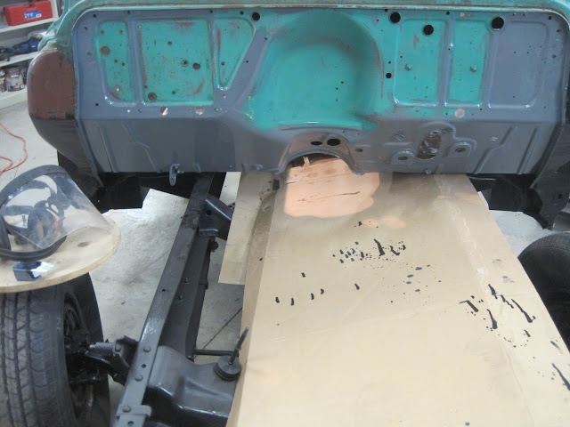

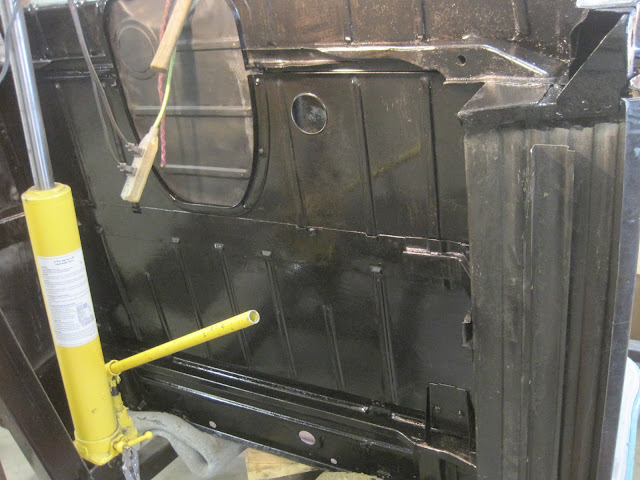

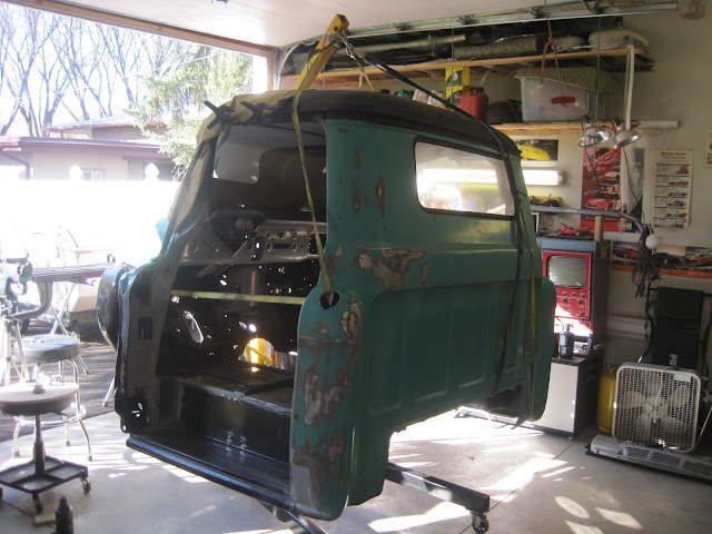

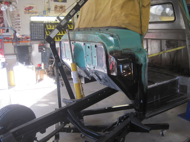

Got a decent day in today (wifey took the kids to the out-laws for the weekend - yahoo!).
POR15 - perfect for chassis, frames and floorboards.
Sealed up the steps that we weled in, as well as some factory seams that should have been sealed long ago!

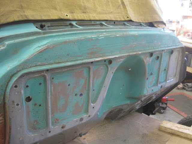

Got the firewall sanded and primed.

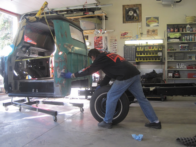

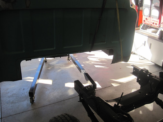

Once it dried to the touch, I hooked it up to the cherry-picker and rolled the frame back under it.
It's a One-man-operation over here at E-tek Restorations!!
Once on it's mounts, I got back to work on the floor...

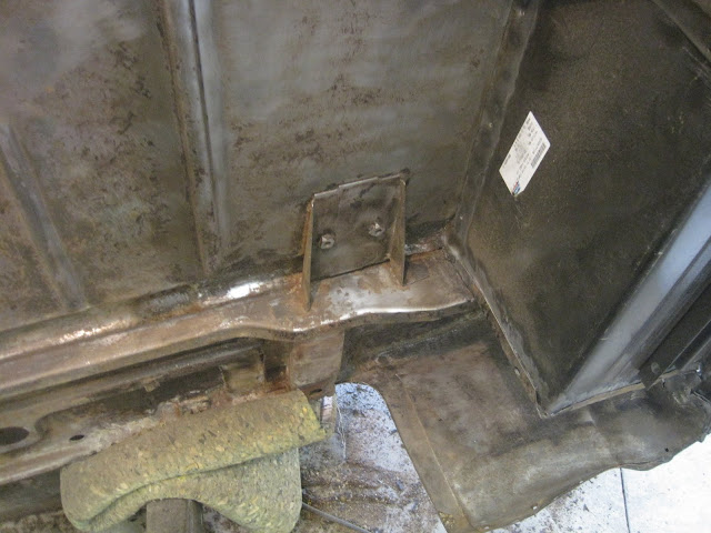

Worked a little more on the R. cab mount that I welded in earlier. Dressed the welds and sandblasted the heavy-duty concave washer that sits in the mount:

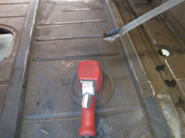

Scraped out all of the remaining factory seam sealer in preperation for sanding and more POR15 on the floor...

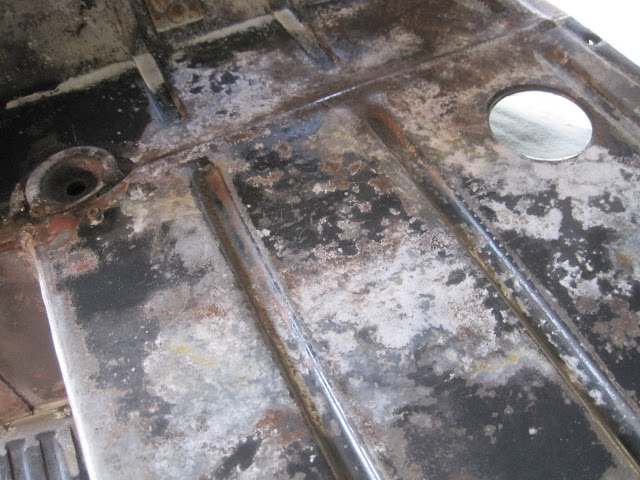

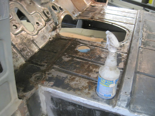

I used 40 grit on the DA to remove the loose rust, loose paint and rough up the metal so the POR15 will bite properly.

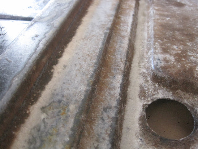

Then I applied MetalReady (Phosphoric Acid) to any rust prior to POR15. This is the best 2-steps I've found for really nuetralizing rust. I'd be suprised if it ever came back.
Firewall looks good! Tomorrow I'll contiue on the floor then start bolting up the front end for a gap-check.

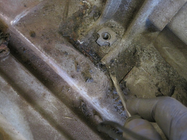

Yes - I'm even the cameraman! I want to get it done so they can have it back for next summer (the original owner is in his 80's!) and also so I can get to some of my projects!

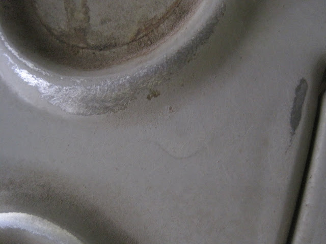

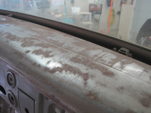

Here's the phosphate that's left after the MetalReady evaporates. Turns the rust from Ferric Oxide to Ferric Phosphate.
Owners son (one day it's to be his truck) was supposed to come and help with some of the dirty work (like scraping)....so far I'm the only one getting dirty! :wtf::bounce:
Factory paint runs - should we re-create them? ;)

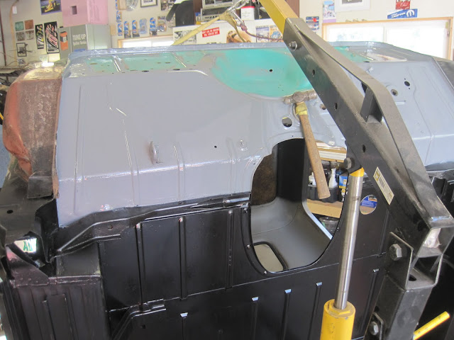

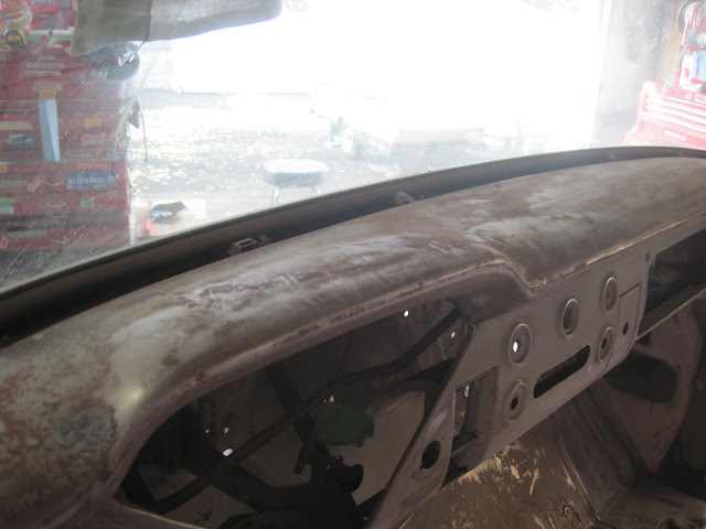

Sanded down the entire interior in a bid to ready it for primer and paint. The dash is welded to the interior. Check out the seam on the two-piece dash:

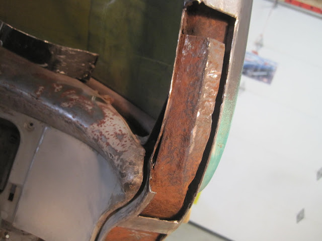

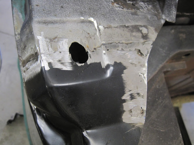

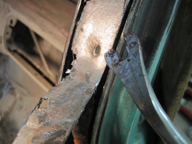

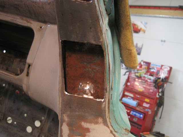

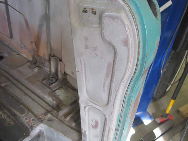

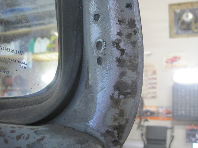

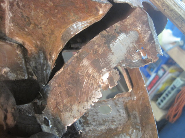

Right windsheild pillar was rusted through - more metal work (my favourite part!)
Sometimes it's hard to know how things come apart. This was spot-welded to the inner.

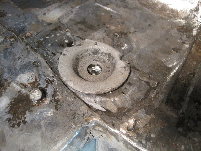

Check out how much metal is lost to rust over time:
Trial-fitting replacement pieces:
Before welding and hammer-shaping I cleaned up the rust and painted more (you guessed it!) POR15 on the inners:

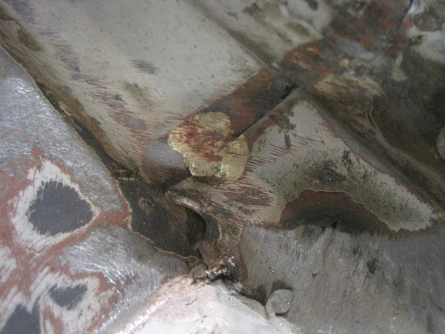

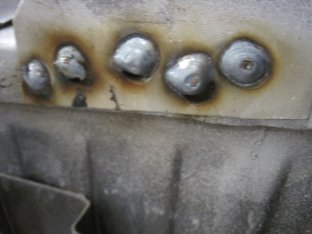

On another note, I noticed some hand-done brass tack-welds from the factory - you wouldn't see that today!!

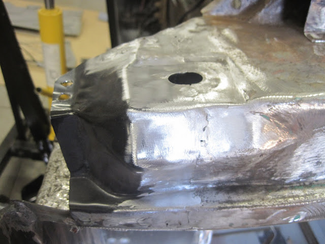

Finally, The front end and the grey POR15 I brushed on from below needed to be sanded and feathered out. This is now ready for Epoxy primer.

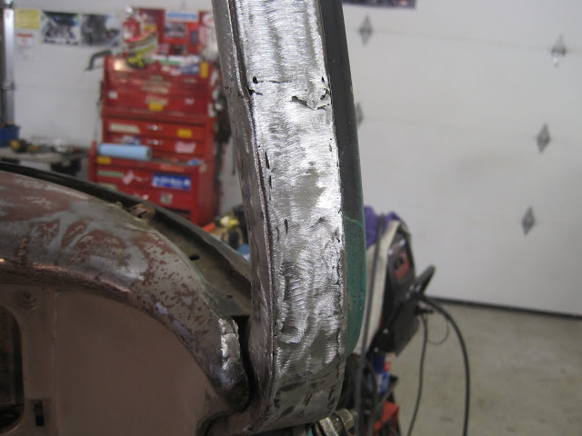

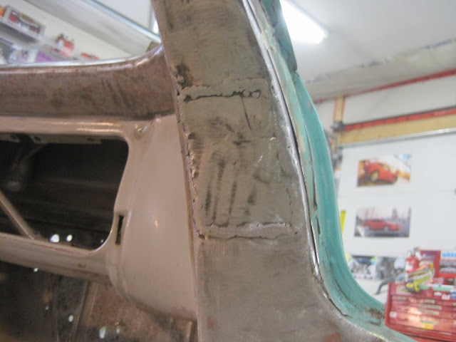

Continuing the WS pillar repairs....fit, tack, grind, repeat.
Same with this bottom patch...

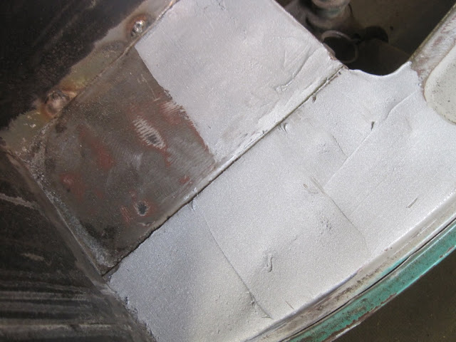

All new metal, plus rust-proofed in behind now. The POR15 will provide a barrier on the inner metal and the e-coating on the replacement pieces will protect the new pieces. One last thing I'll do it spray or brush either a rust paint or a penetrant compound into all the areas that were welded. This will help protect any spots where the weld-through or other primers where burned off by the weld heat. One compound I've been wanting to try is from Eastwood - time for an online order!
I used AllMetal filler here, as well as on the floor to fill the pitting. Waterproof and very strong, these are the perfect areas of application for this type of filler.

Stupid questions I guess:
..Here's the phosphate that's left after the MetalReady evaporates. Turns the rust from Ferric Oxide to Ferric Phosphate.
You just leave this residue? It looks dusty in these photos, but maybe that's just how it looks?

This rust looks terminal and aggressive to me. Obviously you can't reach inside there and paint POR 15 up and down the length of the internals..so what can you do, nothing? Let it rust and get it when it comes through later?
Motown 454
Sep 25, 2008
1,359
Re: E-tek Resto's 56 Chevy Truck
e-tek You do really nice work. Its looking great.
E
e-tek
Dec 19, 2007
10,690
Saskatoon, SK
I love a "stupid" question - I ask em all the time!
Sorry, I didn't show it, but no, you don't leave it and yes, it is a dust-like substrate that is left afterwards. I generally sand the area down again, then wash it with Pre-paint solvent (or reducer) prior to top coating with any filler or primer.
I do try and get the POR15 as far up and down as possible, but what I will also do is spray either a rust primer/paint or a wax-like rust penetrant which contain special corrosion resistant waxes and corrosion inhibitors dispersed in corrosion preventive oil.
Otherwise ya, you can only do so much. Even in a "TOTAL" restoration, unless you are going to cut open every area, including the frame, you can't get to everything on the insides. I restored my 67 Galaxie Convertible about 6 years ago now and can now see some rust on frame areas that I didn't see rusting then. Like the song says: Rust never sleeps!:(

I think the POR-15 company should invent an expanding foam that you could shoot into an area like that.
(I sent them an e-mail about it)
Dan in Pasadena
Feb 18, 2009
13,268
Pasadena, CA
You beat me to it! I agree totally.
I also have thought of some kind of long (disposable) tube or snout with a kind of spray head like a Hudson garden sprayer. You could drill a small hole in a space like that windshield A pillar and put the snout in there to thoroughly drench it in POR-15 or other product. Sure, it would not be perfect but it would be an improvement.
E-Tek, I think you are bustin' azz on this truck and I highly doubt you could be getting paid a fair, representative wage for it. It's just time, time, time to do it right and very few will do it for themselves, much less for someone else.
