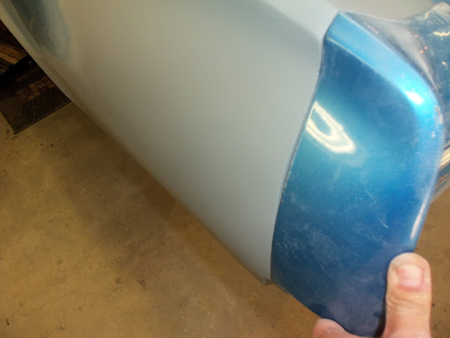

Thanks M_P! Here's how she looks today:
Remember those giant holes that where hacked into the aprons?
Took out about 20 pounds of filler from this side!
Reconstruction of the left quarter came out pretty good...
This weekend I'll get the rear end and exhaust pulled out, then I'll finish up the floor pans from the underside while the owner cleans up the suspension. By the time I'm done he should have the suspension ready for a "loose bolt in" - just to get it mobile to the paint shop.

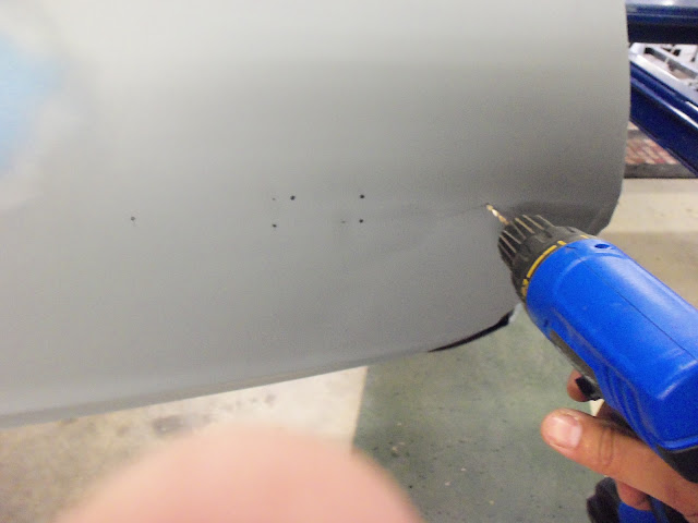

Details, Details:
Owner wanted to get the emblem holes drilled prior to paint work:
This is the quarter that was sectioned both horizontally and vertically. I have this OEM trunk-spatter spray in my inventory and think it looks much better than "just black"....
