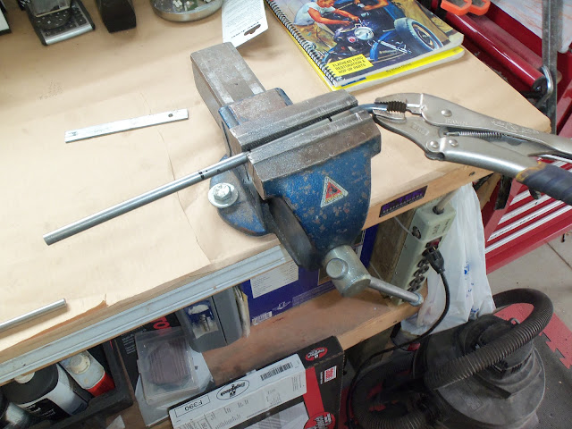

Got all the materials needed to build the brake lever and e-brake system, as well as template material for some brackets needed, wiring for battery re-location and much more on the 40 Ford. On that note, check this GREAT way of making a lug on a length of cable to make your own e-brake cable lengths:
Cut a piece of rod or bolt, drill a 3/16" hole thru centre:
Clamp it in a vice and drop a MIG weld on it:
Viola - custom cable end!
Way better than using a set-screw!

E-Tek...if you did it, shame on you. You know better!!! I guessing you just staged this for the photo shoot.
BUT....for the others that don't know, never drill a piece like this in the location it's in. If it grabs, it kicks around. You're not supposed to wear glove at a drill press so if your holding it with your bare hands, you stand the chance of possibly getting a good gash out of it. Rotate the part around so it is up against the drill column. If that is not possible, run a bolt up through the table slot to act as a stop.:thumbup:
Just wanted to mention it before anyone gets hurt. We had a guy at work that had his thumb ripped off because of unsafe drill press practices. :beer:
