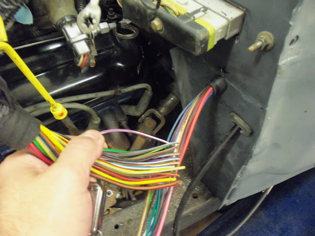

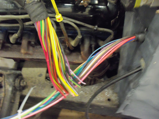

In this case I have to match up the engine management harness with the aftermarket one:
Today I also got the passenger side window powered up and even though still in the "Mock Up" stage I like to clean up what I can as I go, including polishing the window chrome before putting it all together:
With this project though, the aftermarket harness install is just one piece of the puzzle. As I said above, it all has to be married to the 5.0L EFI harness, a somewhat complicated Vintage Air set-up, as well as power windows, power locks and electric wipers! Here's what some of that looks like today:
Wish me luck!

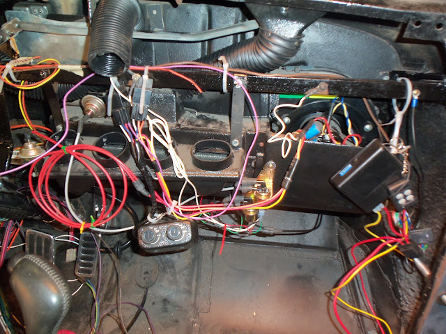

I know this looks like a mess (!), but it's actually mostly sorted! Unfortunately, these Vintage Air systems could use a little more wire in the harness!! The lines with the rubber elbows are actually vacuum lines to open the heater, AC and defrost flaps, then there's some regular 12 gauge wires, but also there's these 22 gauge wires to the switch that are barley 10 inches long.... makes for some limited mounting choices even if you choose to do some custom work.
If you look through the mess, you can see I temporarily mounted the vacuum servos and relays on a piece of MDF in order to mock up the location of all those items and route the wiring:
By next week I'll have it all connected and tie-wired up like a pro (no LOL!!)

If you've (n)ever installed a Vintage Air System you're missing out on a TON o' DIY "fun".... from the wiring, to the vacuum servo's, to the heater and AC hose connections, there's something for everyone.... and almost too much for one man! After 2 weeks and a total of 12 hours (I like to work at things like this a little at a time!) it's mostly done - save for the final AC hose set up and filling which we'll leave to those with the specific services.
The wiring, vacuum tubes and defrost hose systems are all hooked up - just awaiting the dash cover to be re-installed. Once it's in I can route the last heater hoses to the outer vents and hide all the wires and tubes.
In the engine compartment, the heater hose system got a heat transfer pump - which allows coolant into the heating system - as well as part of the diverter tube (that I cut from the original) which takes coolant to the throttle body manifold.
The wiring and vacuum tubes (for manifold vacuum and to pressure the heat transfer pump) were run through the firewall next to the solenoid:
Also got some of the accessories, such as the power drivers seat wired up:
Next up will be forming the console and getting the seat tracks a permanent perch....

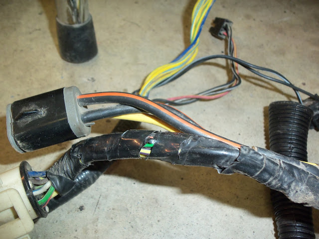

Time to tackle the front end wiring....
First I separated everything into lights, engine sensors and power runs...
Then I tore aprt the old harness and took out the parts I needed: lights, alternator, starter wires, etc:
Here you can see the light connectors wired in as well as the engine sensors. I need more **** connectos and web-wrap so I wanted to take a look at the rad and see what we'd need to get that hooked up as well.
Tomorrow I'll buy the fan, ****** cooler line connectors, more electrical stuff.....

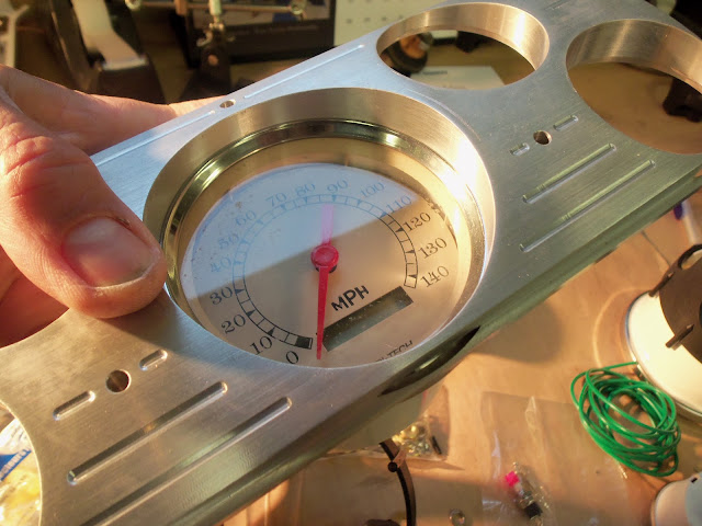

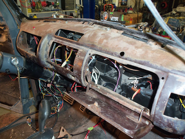

Ah...Sundays...Powerblock, play with the kids, Hot Tub and a few hours in the shop - and that was just this morning!
Here's the dash that came with:
Here's it is partially mocked up:
Rad in:
Not much room!
Pusher fan went in next:
Lots more wiring too:

Sounds like you've had a fun, productive Sunday; good for you! :thumbup:
Dang E-Tek, that motor looks like it they had to get it in there with a shoehorn!
I just had an idea for a new thread. How about a title of 'Prettified Engine Compartments'. I'd like to hear about all the car builders' 'tips and tricks' to have a car/truck build 'looking good under the hood'. What do you think? With all the seasoned wrenchers on this forum, there should be lots of ideas that were used to make the engine compartment look like a 'clean, mean, racing machine'.
Everything from tailoring the inner fenders, smoothing the firewall, paint choices, hiding wiring/hoses/accessories, adding 'Bling', temperature-coating hot metal, etc., etc., etc..
Do you think this topic would generate some real usable input from the GJ gang, or has this idea been threaded before?

Ya- - she's shoehorned in for sure - but it'll get cleaned up and once it's painted contrasting colors, with some chrome - it'll look much better.
I think it'd be a great topic. Would get lotsa engine shots for sure!

E, wheredja get that gauge panel? And did the trim come with it?
I have a 40 dash in me 33 and need one.
The owner had purchased it somewhere - but i've seen them on lotsa sites like Speedway. The bezel/trim is original to the car.

Bunch more wiring and the seats are bolted in. It's all on the blog, but I'll posts pics of the console build up here tomorrow. Thanks to all who check it out!
